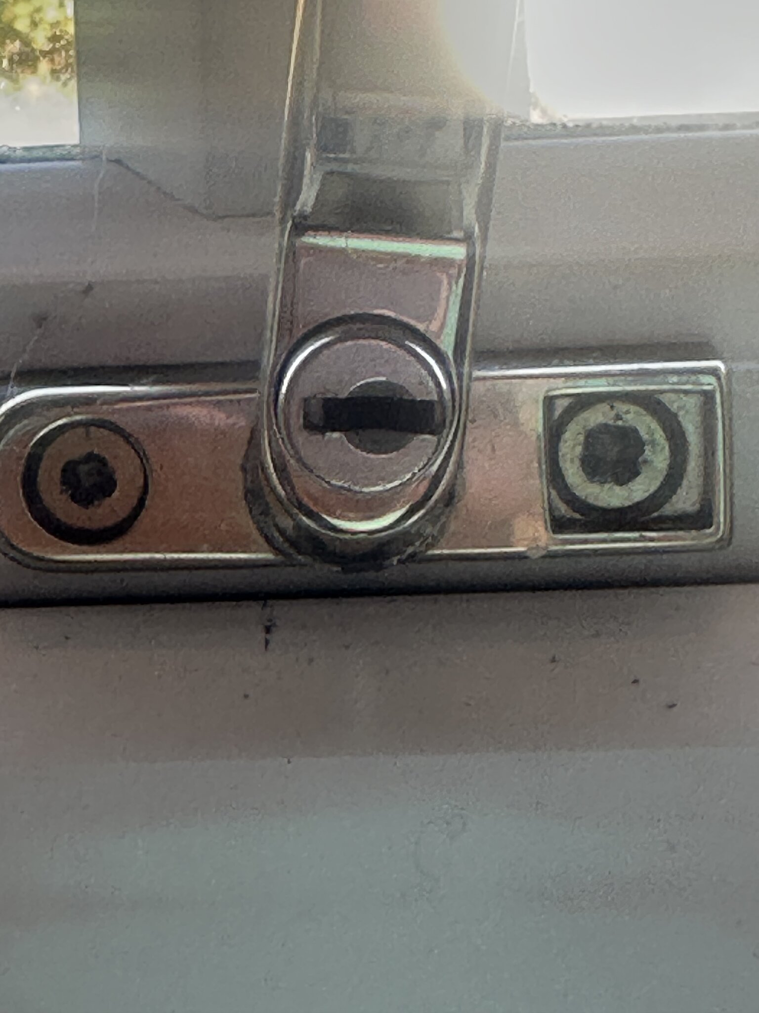

Drill the screws and use a screw extractor.
Failing that, you will need to break the handle where screws are, basically destroying it so you can grip the screws with grippers.
Who rounded those screws like that???
