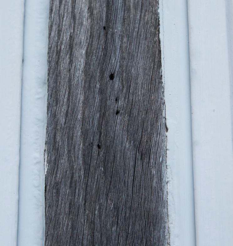

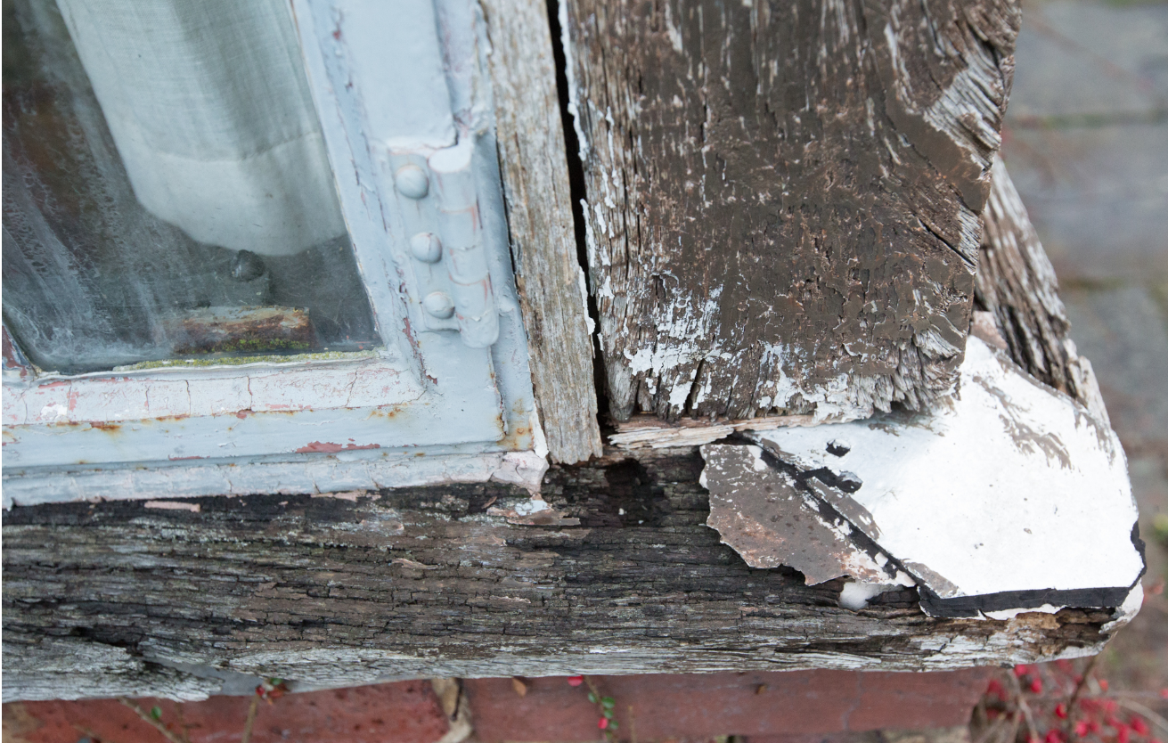

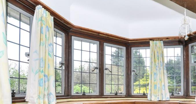

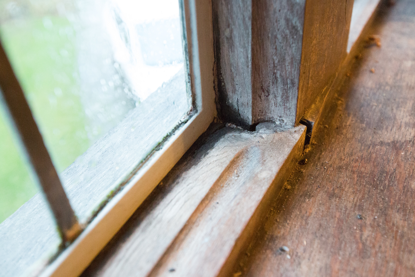

    Got some close ups today
    upload_2020-12-23_21-12-40.png upload_2020-12-23_21-9-1.png upload_2020-12-23_21-9-35.png upload_2020-12-23_21-10-28.png upload_2020-12-23_21-11-39.png

    the bay windows are structural oak subframes with metal crittall inserts
    expensive to replace -the cheapest option would be to replace the feature joinery, like the bay window in oak and maybe aly inserts (duration windows)
    iroko would be cheaper than oak and still look lovely.
    and consider the standard windows to be done in something like residence 9 upvc timber alternative.
