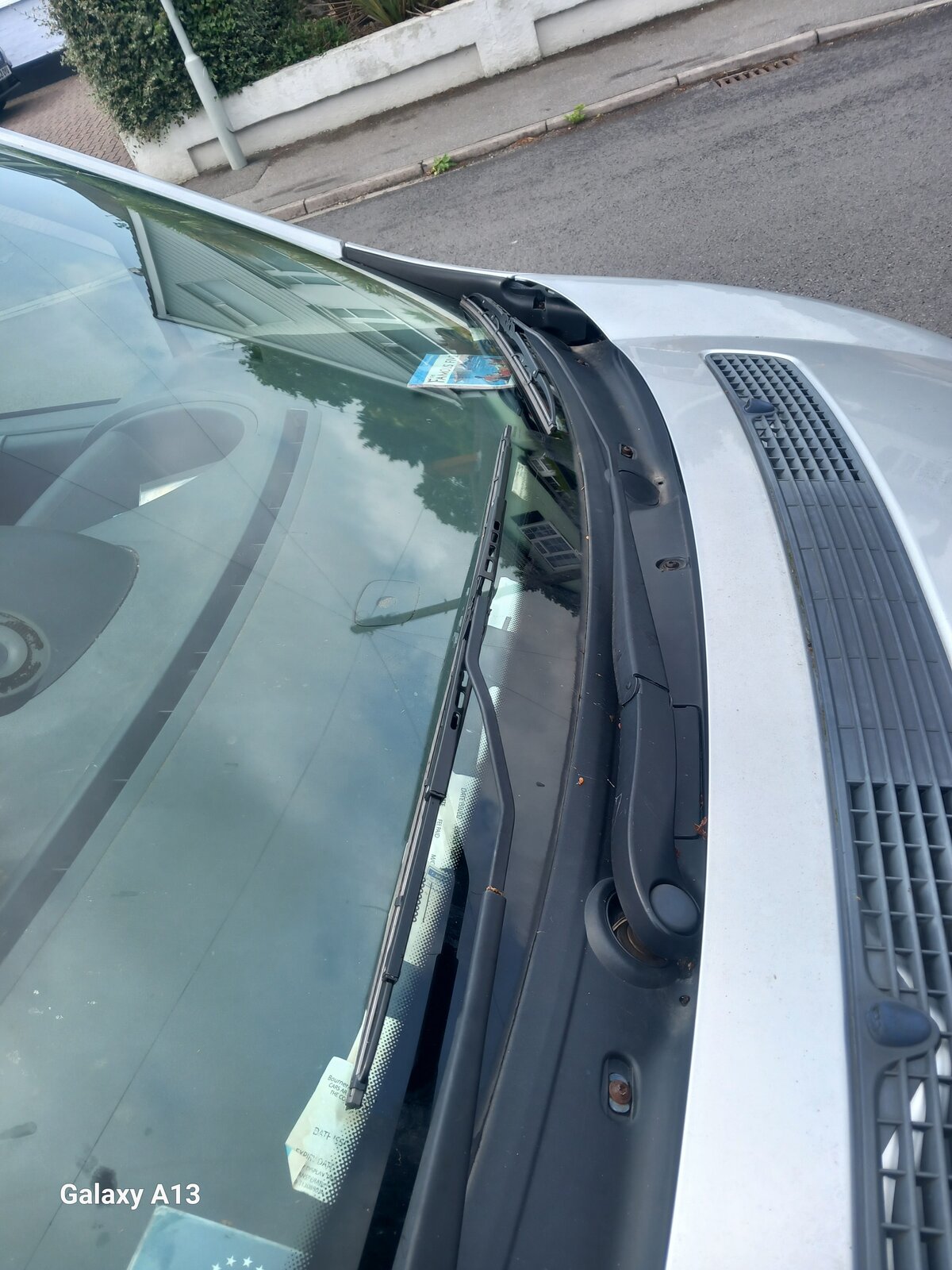

They just rattling and won't work, anything obvious?

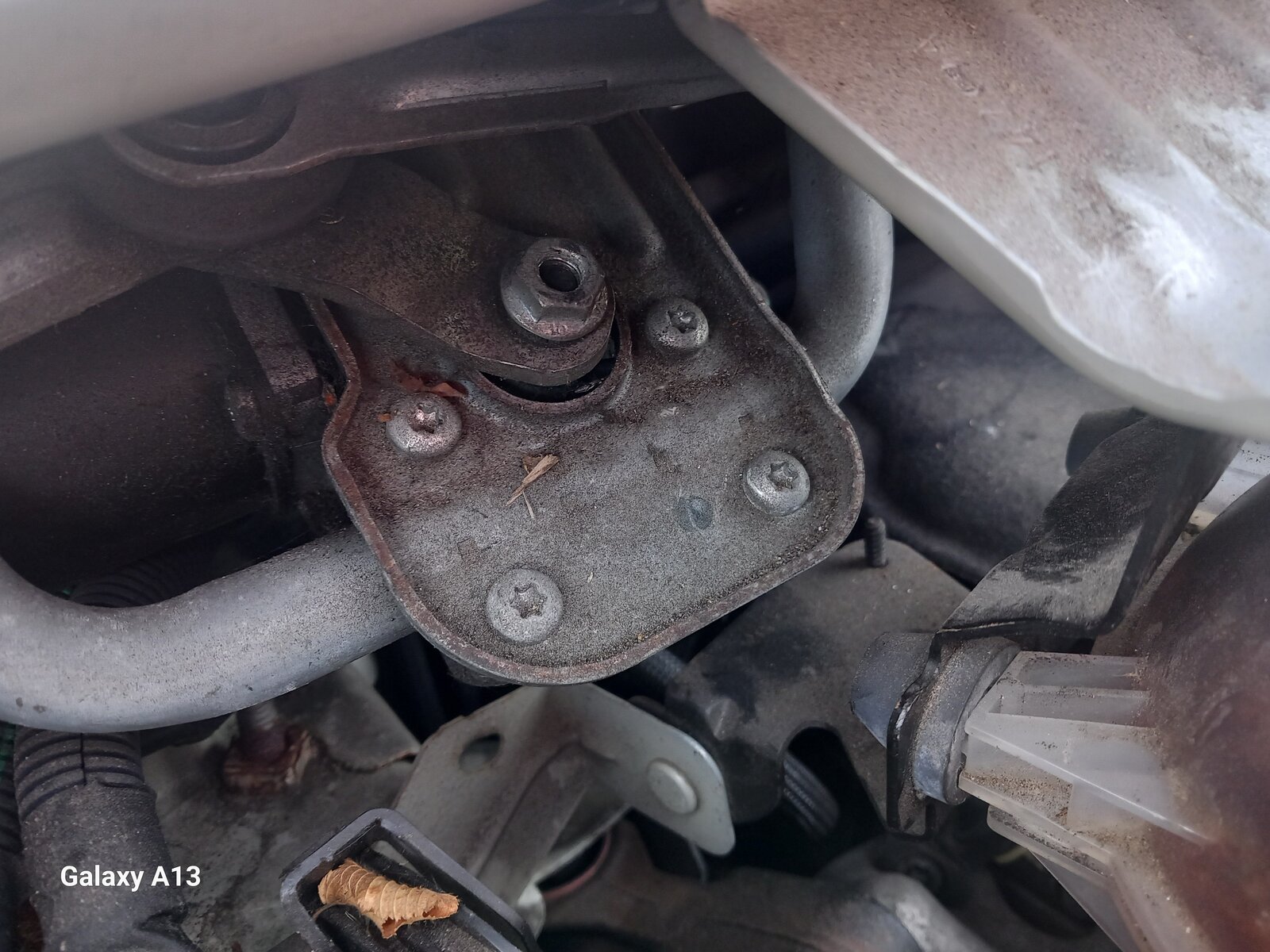

Ok so tightened the loose bolt in pix and seems to have solved it.
