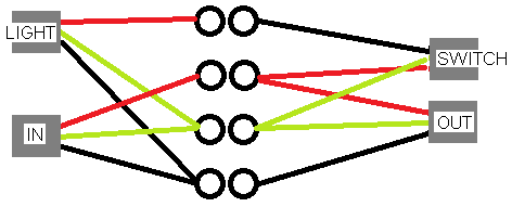

Hi, I have bought an empty ip55 round junction box (https://www.screwfix.com/p/schneider-electric-7-entry-rectangular-junction-box-with-knockouts/30356) to fit in my shed (already wired) and I am attempting to replicate the following wiring using a connector strip:
Now... I've managed but I've immediately realized that I can't leave it like this. It's just a complete mess, a massive tangle of cables that does not look great and/or safe.
What would you suggest to use to do this? Would using WAGO connectors make this better?

Using connector strip will always result in wires crossing over but this layout will (or should be) aboutas simple as it gets
Note how IN cable shows as over LIGHT cable and SWITCH earth is over both reds

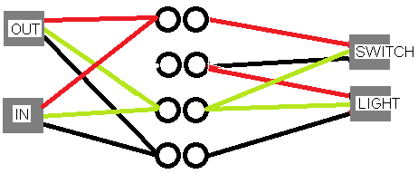

Also similar in this variation

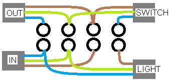

Ah curvy much better.

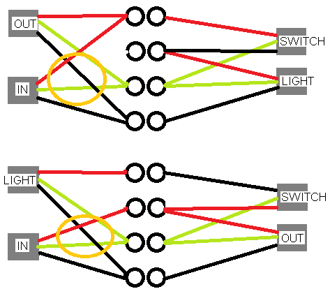

using your identical techniques (E, N, L, SL sequence) I've drawn the wiring starting at the top (12 O'Clock position) and running clockwise, the outcome with both results in 3 layers of wires in the orange circles. It may not seem much but extending this to more cables the tangle soon builds up and makes future faultfinding/tracing wiring more difficult. Trying to lift one cable away for such work becomes difficult/impossible.
There are no tangles either way.
Does changing which colour is on top in your diagram cause a tangle?
That depends which wire it is.
Anyway wires are not dead straight and exact length like the diagram which is why curvy was better.
