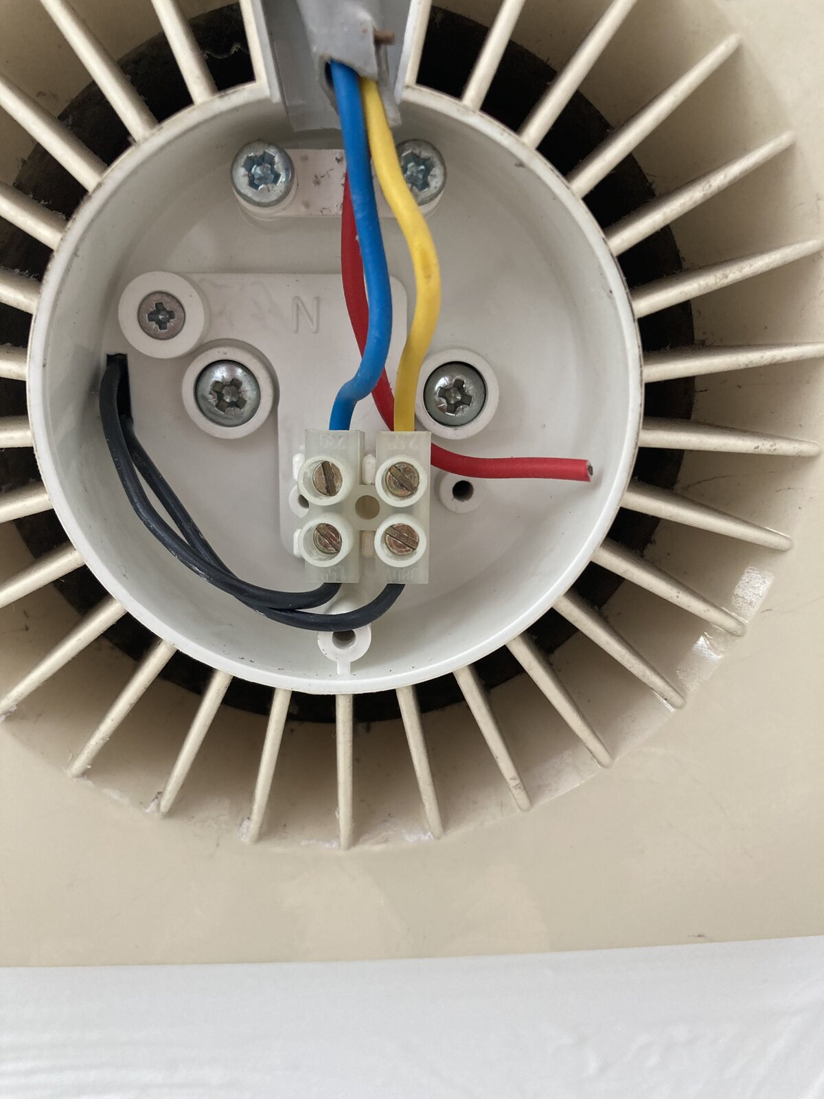

Hi there,
Planning to replace the bathroom extraction fan, but I cannot tell which is which as the colours (red, blue, yellow) of the wires are different to what I can find on other fans or in the web. I guess they are:
Red = permanent live
Yellow= switch live
Blue = neutral
Is a that right?
Thanks!
Ben
That may well work but check connections at ceiling rose to confirm the respective terminations match at that end
Blup
You are probably correct for a fan with an over run timer, which suggests somebody just fitted a non timer model as they are cheaper
Thanks gents! Yes the one fan does not come with timer switch, but the new one does.
