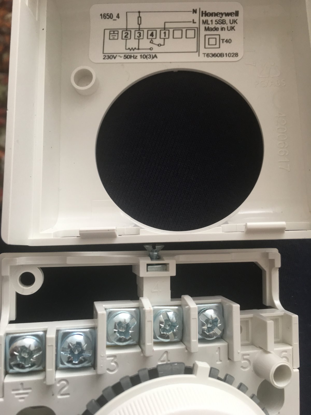

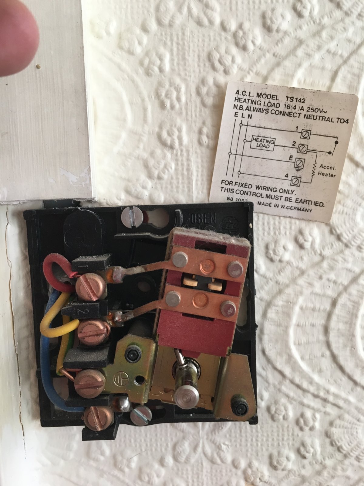

Hi guys please could you tell me what wires go where on my new thermostat?
Many thanks.

I'm not quite sure why you are asking, because the circuit diagrams you have posted clearly show where the wiring for each thermostat goes.
Old Stat
Red (Live) 1
Yellow (Switched Live) 2
Blue (Neutral) 4
New Stat
Red (Live) 1
Yellow (Switched Live) 3
Blue (Neutral) 2
Earth to earth
