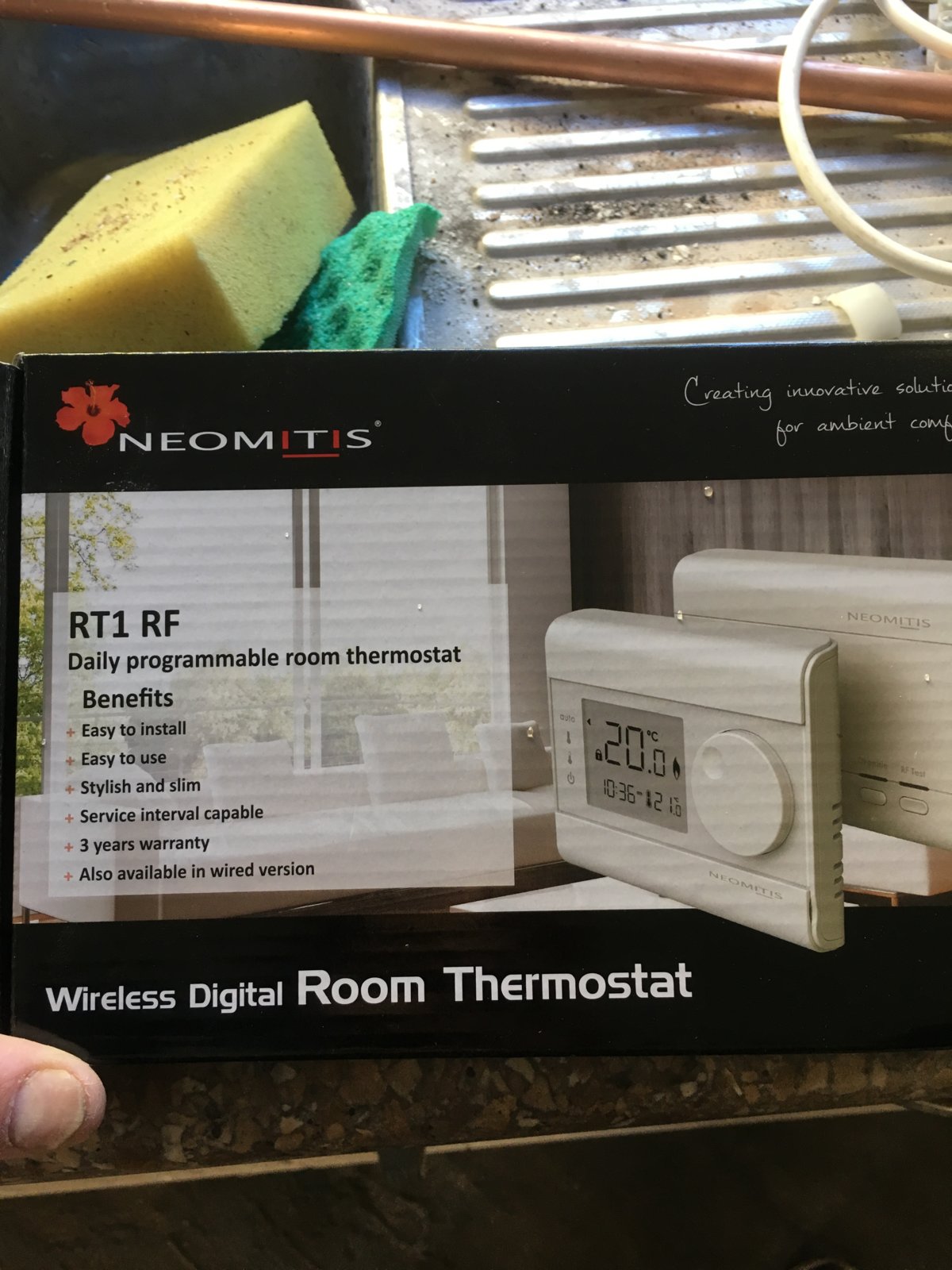

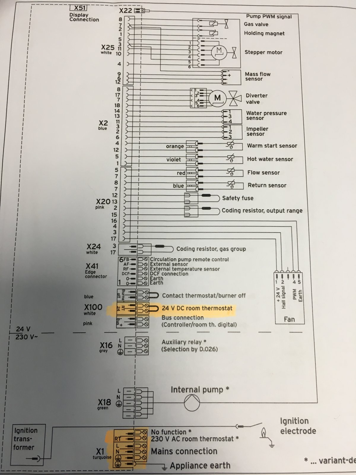

Hi all, can anybody advise me how to wire the following:
Neomitis wireless thermostat to a Vaillant boiler?
Here is the boiler wiring diagram
And the thermostat wiring diagram
Any help will be greatly appreciated!

It seems your boiler has three options, however there is a star on the 230 volt option and I can't read what it says, but for either of the other options you need 5 core cable. The thermostat you have it seems is very basic, so X1 L, N, Earth connect to thermostat L, N, and earth, then X100 RT 24 you remove link and connect to 3 and 4 of thermostat.

You have a thermostat at the moment ?
How many wires does it have? have you got a picture of the inside and outside of it ?
No I don’t have one fitted at the moment.
Daniel

There are (probably) two ways of connecting your stat.
1) Using the 230V stat connection - but note the "*" which seems to say "variant dependent"
You need 3 cores (plus earth). Link L&N in the stat to L&N at the boiler, link L at the stat to 3, and link 4 at the stat to the RT input on the boiler - "230V AC room thermostat".
2) Using the 24V stat connection
You need 4 cores (plus earth). Link L&N at the boiler to L&N at the stat. Link the "24V DC room thermostat" connections to 3&4 on the thermostat - and remove the link that will be fitted in the boiler.
IMPORTANT - you must not under any circumstances allow mains to get onto the 24V DC stat connections, it will almost certainly blow the circuit board.
In both cases, it's a pity that boiler manufacturers don't provide terminals to provide the power to the stat - so you need to double up in the mains in terminals which can be "fiddly" in some of the cramped spaces they seem to like putting them.
