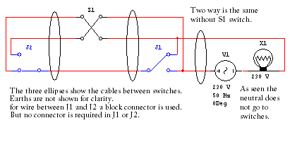

In my flat I have a long hallway which has little LED ceiling lights. These are controlled by 3 conventional 2 way wall switches - all the lights are on the same circuit and come on at the same time.
I'd like to add a 4th wall switch in a particular spot at the end of the hallway. I checked out the wiring and I don't think it's a job I'd like to do myself, so I'd need to ask an electrician to do it, which could get quite expensive (running cables behind walls, above the ceiling, etc.). However I see that there are now wireless wall switches, and I wondered if that might give me a quicker/cheaper way to do it. The choice is bewildering though (eg. I looked on Amazon), and I don't really understand how they work. Can anyone give me any pointers please? eg. a particular switch that I could use, something that's easy to wire up, etc.?
Thank you.
At the moment your will likely have two x two way switches and an intermediate switch, to swap these to electronic switches depends on how wired, with this two-way-plus-inter.jpg wiring in theory the intermediate switch does not require the 'com' wire, in practice normally the 'com' wire will pass through the intermediate switch which is good, but that 'com' wire at the moment carries 230 volt, and with electronic switches it only carries a extra low signal to tell other switches what to do. On an electronic switch you don't have a 'com' you have an 'S' for signal.
Some electronic switches need a neutral, and to be frank if there is a neutral at the switch the type that needs a neutral seem to work better, I have used electronic switches, I used Energenie, I do not rate them very high, as you need a hub and they have required re-booting i.e. turn mains off/on I think it was Nest Mini that caused the problem. Likely the MK quinetic switch is what you want, to simply add another switch, the Energenie connects to internet.
