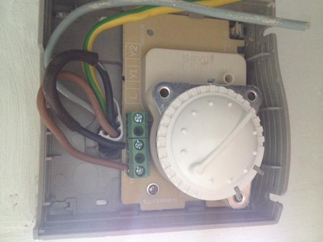

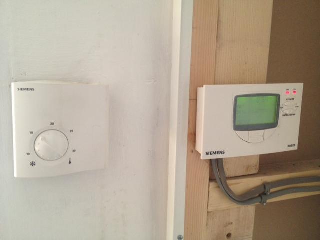

I was just wondering if changing the setup in the photo to a setup with a wireless thermostat is a relatively straight forward job?
Currently the wired thermostat is in the entrance way/ hallway area which never gets particularly warm. I'd like to put a wireless thermostat in an upstairs bedroom and snug.
thanks for any advice you can give me.
Simon
It is a straightforward job but it is silly putting the receiver where the present thermostat is.

The wiring is normally relativity simple but first question is do you really want to move it? The only real problem with wiring is in the main the receiver needs 230v with a neutral. Some wired types use batteries and the volt free contacts may be 24v. Also where 230v often no neutral.
The picture really does not tell us much. Could even be already a wireless type.
Hi Impudence,
There is a wiring box - is your thinking to hide the transmitter away?
We run a little B&B and so want the bedrooms to be controlled so that they're never cold. The rest of the house can be cold (it's an old building, 1728, and trying to keep the whole place warm just isn't worth it). The bedrooms themselves seem quite good at keeping their temperature it's more the bottom of house that remains cold even when the heating is at full whack - I'd rather rely on the wood burner for keeping us warm downstairs.
Where the thermostat is at present is a few feet from the front door and in a space that runs the entire height of the three stories so not a space that tends to get up to any kind of temperature and any heat will rise up the staircase - to be honest I don't think the electrician put much thought into its placement.
Here's a pic of the wiring for the thermostat ericmark.
It's a receiver, the transmitter is the thermostat, but yes and it doesn't matter where it is.
It will require a supply (L,N,E mains) and the control cable for the boiler (the present thermostat cable).
As normally CH systems have a wiring centre with all the cables in one place, so fitting the receiver here is sensible and easy.
The present thermostat position is redundant.
There are two wires only connected so you can't do a direct replacement. Likely you would need to fit the receiver with the time switch/programmer. But not simple change. So question is have you got the expertise required? There are hundreds of methods to control a house and I would suggest your not going to get the best using just a forum.
