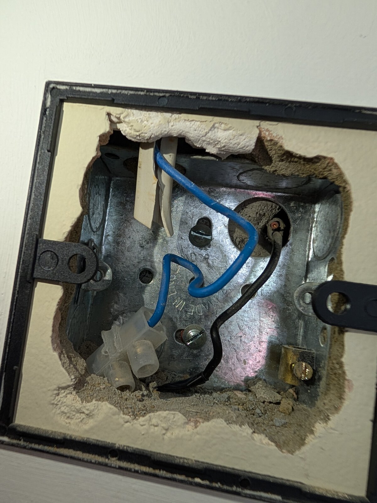

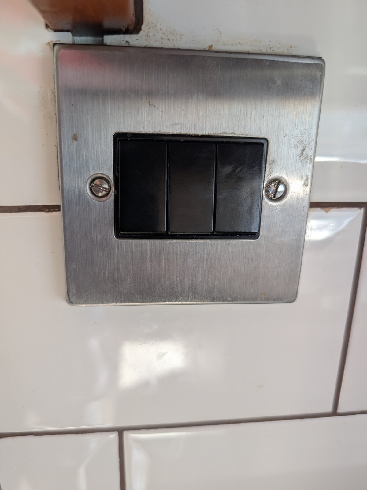

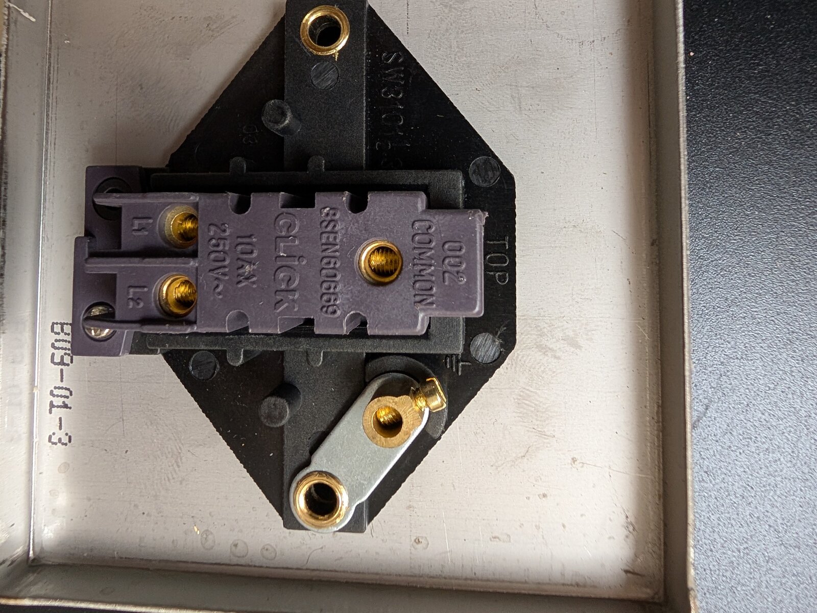

I want to switch a single switch to a single socket. On opening the plate, I found a black and blue wires both connected to a single plastic connector shown in picture. These were both inserted from the same end too. The wires come from different points into the box. Can someone advise which is live/neutral to connect to the socket or are they just L1 and L2 and there is no neutral coming into the box? In which case what can I do? Thanks.

Should also mention this switch is a spare, the switch itself was not wired in. The wires were both in a single plastic connector.

Impossible to say what they are but obviously one cannot be live and the other neutral.
You will have to find out where they come from.

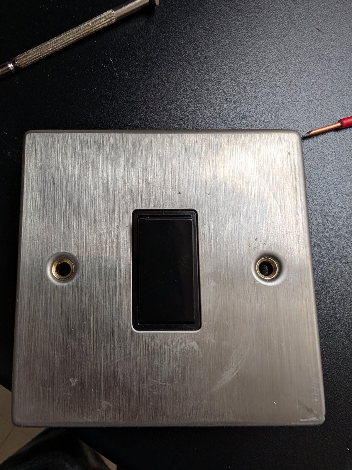

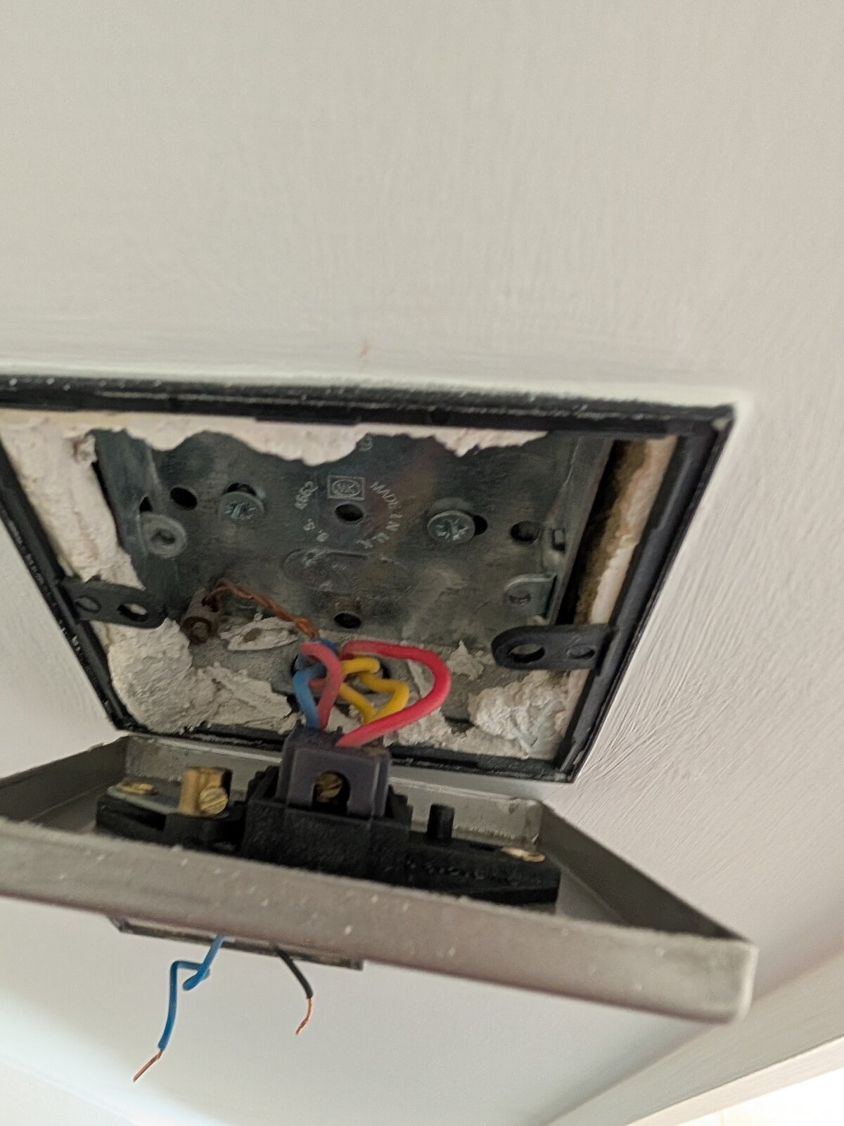

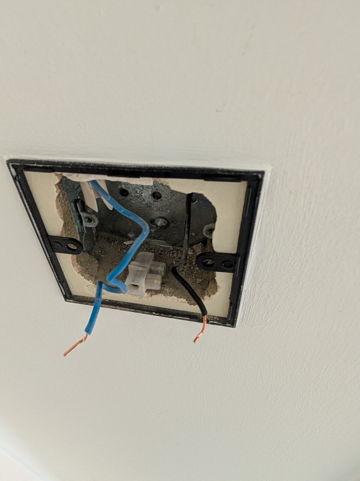

Thanks. So first apologies, I now realise that it's not possible to simply change it into a single socket. But I almost did, I thought the blue was neutral. But then I reversed my steps as it dawned on me that it cannot be if they terminated in the same plastic casing. Hazard averted. But what I don't get is why the wire is blue because that's a colour I take for neutral. To your question, right now I have separated the two wires and no light has stopped working. There is only one light in this room controlled from a switch above this one. But the wiring in that is completely different.. see attached.
Well - yes, it will be used for neutral if there is one but it can be used for anything you want but should be identified.
It is completely different so looks like the other switch is for something else.
This switch is one of two in a 2 way system, in other word you have another switch somewhere which also operates that light.
If you can trace where the black and the blue at the lower switch actually go to, we may be able to help.
At the lower switch, is there an earth wire tucked away?
Or any wires cut off?

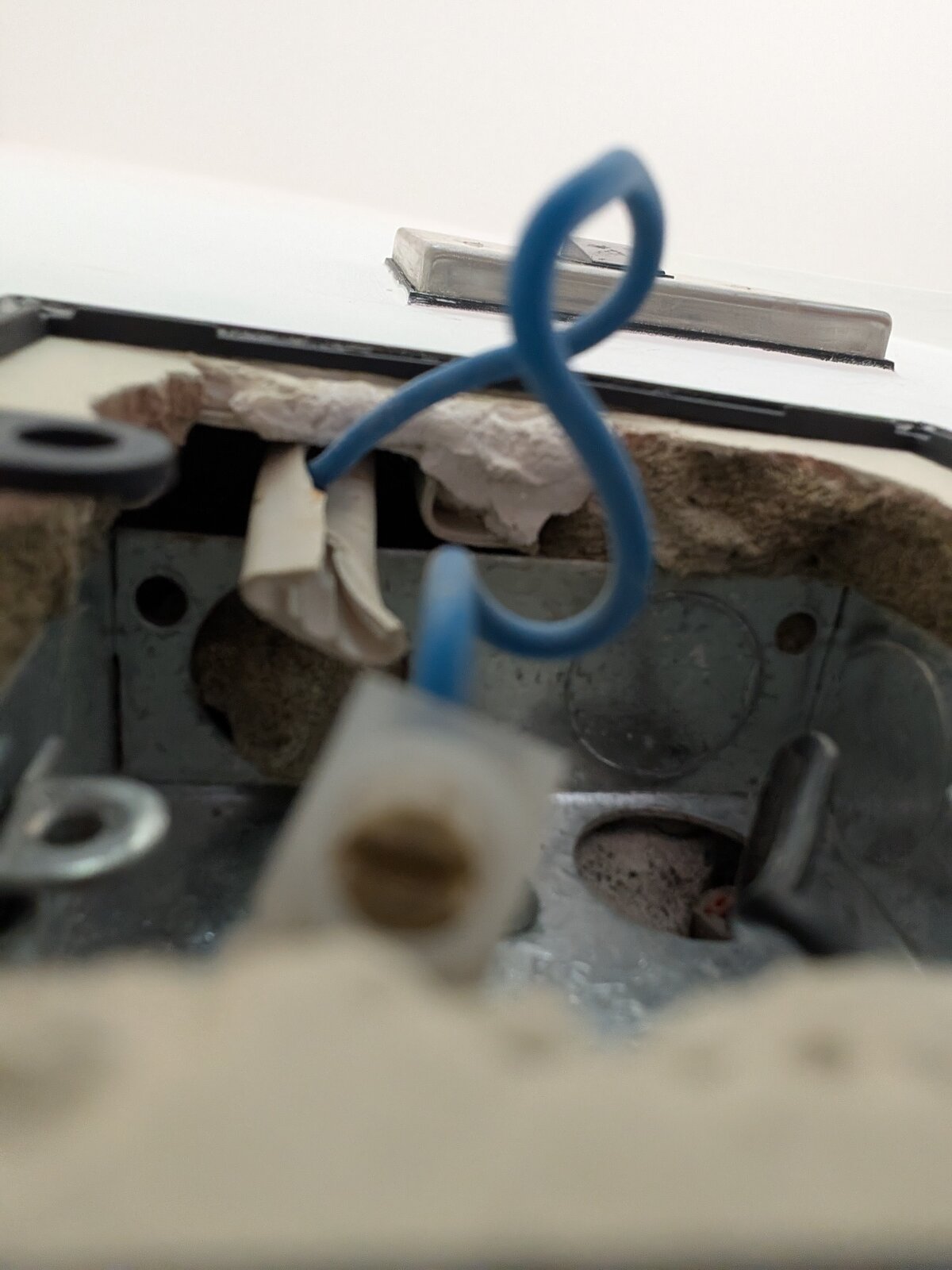

Thanks all! So some more information. The black wire comes from the back of the box and blue wire from the top. Where the black wire comes from, I can definitely see a wire cut off (looks red). The blue wire is definitely by itself. Behind where is switch is located and on the other side of the wall there is a triple switch. I am guessing the black wire is coming from this box? I two of those three switches work, one I can't figure out. Pictures attached.

In the second picture of the last three pics, I can see what looks like an empty conduit, which may be useful.
You say the 3 gang switch is on the other side?
Can we have a look inside the 3 gang switch?

He or she has indicated that a 3 gang switch is the other side.
There may be a neutral here.
And an earth.
He has not specified he wants a 13 amp socket.
He could have a 2 amp or 5 amp round pin socket on the lighting circuit.
He could have a 13 amp socket, if he doesn't overload it.
He could have '5 amp max load' engraved on a 13 amp socket if we're concerned with overloading.
If he or she sends a photo of inside the 3 gang switch, and confirms that it is back-to-back with the box with the two wires, we may be able to advise that he can altering wiring, if it is possible.
When we know that, and if it is possible, we can consider RCD protection, if required.
And the box in question, with the two wires, is 25mm deep, and recessed into the wall a little deeper than that, so more than deep enough for most single sockets .
