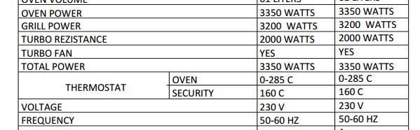

Read label on oven and it says it has a load of 2.9kW and I think the mains is 230V.
From physics I recall that P=IV => I = P/V => I = 2900/230 => I = 12.61A
Would I not get away with a 13A fuse on a plug, which is plugged into the cooker socket, which in turn is on its own circuit connected to a fuse box with a trip switch? The existing flex cable is 4mm flex with 10A fuse, which is connected to the existing oven which also has a 2.9kW load. Could I not just use that and connect it to the new cooker and put a 13A fuse in?

Where did you find 2900W?
From the linked instructions:
3350 / 230 = 14.57A. Hence the requirement for a 16A minimum.

My mistake EFL, the load you linked is the correct one, I must have read the wrong pdf as I had been looking at a few.
@stillp - The core of the flex looks like 4mm.
Anyway it looks like I will need to bite to bullet and get an electrician to install which is unfortunate as do not have much money because it is Xmas.
