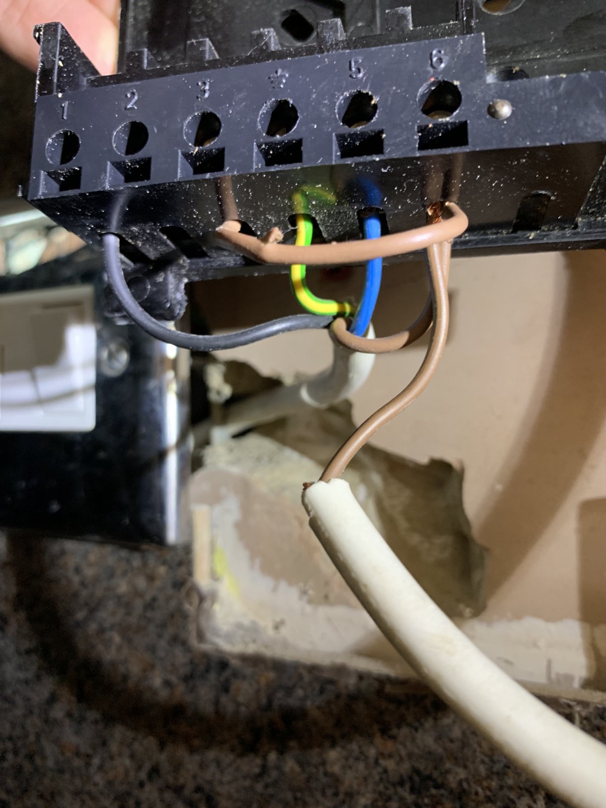

I’ve attached a pic of the current danfoss wiring, the 4 core cable is coming from the mains. The solitary “live” cable heads off to the boiler. My initial assumption was that the thermostat fed in here too, clearly it doesn’t, my next job when I get home later is to figure out where that’s going but I wanted to see if anyone had suggestions on wiring the hive receiver.

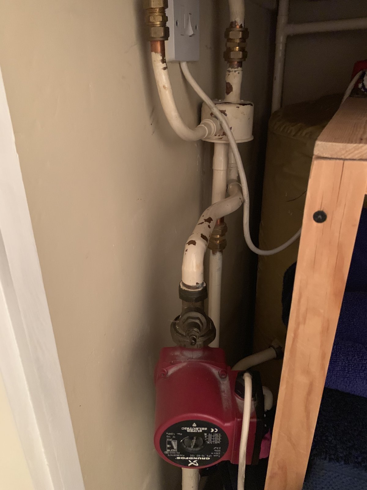

There is a pump in the mix but it matches the gravity fed setup here http://www.handymanknowhow.co.uk/plumbing/howheatingworks.htm

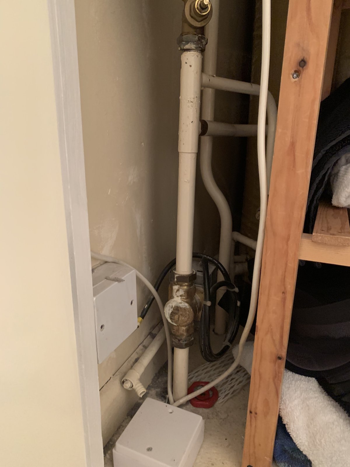

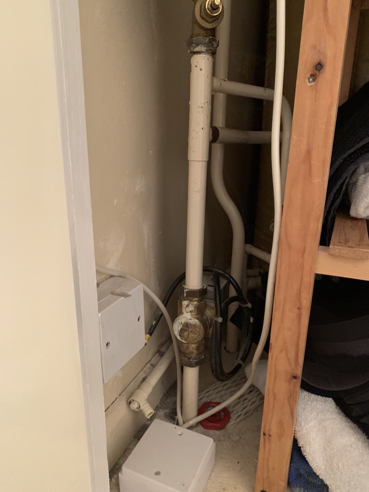

The hot water cylinder is attached to the pipework in the pictures. The switch at the top is for the backup Immersion heater. I confess to not chasing the thermostat wiring yesterday but the new assumption is it comes into one of the boxes at the bottom.
...but it would require rewiring.
When you say rewiring do you mean "get a professional its a huge job" or the existing wiring needs tweaking connect cable A to 1 rather than 3?
Thanks for the help.
I guess then by that, you mean no heating when the room thermostat switches off, but the 103 is still on so heating the hot water. The interesting thing though is that your photo shows a two port motorised valve. I can't see what the pipes are connected to, but I don't suppose there is another one somewhere else is there?
