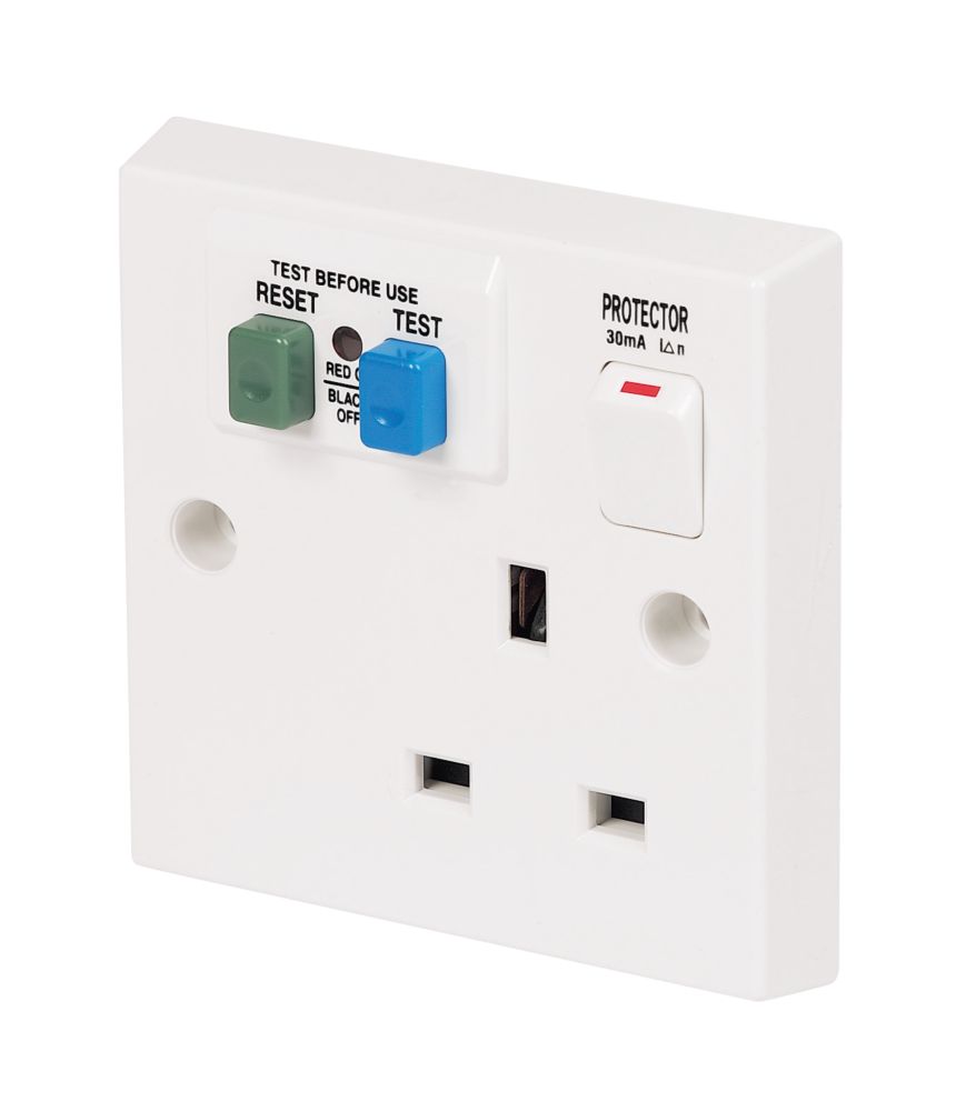

I need a little advice on wiring up a power shower (electrically pumped mixer) please.
I have taken a spur off a socket and want to drop this down into the airing cupboard (which backs onto the shower) then run it to a 2 Way Consumer Unit with 63A 30mA RCD Incomer, 1 x 50A MCB then to a 3A switched box before connecting to the shower unit.
Is it ok to do it this way? If not what is the easiest way for me to do it without the use of an electrician?
Chris
Take the spur to an RCD socket single or double in the airing cupboard and then plug the power shower with a 3 pin plug containing a 3Amp fuse.
Is the mixer in the airing cupboard as well?
What do you mean by RCD socket?
The shower unit is an all in one mixer and pump which is in the shower cubicle.
It's a Socket which incorporates a 30mA RCD.

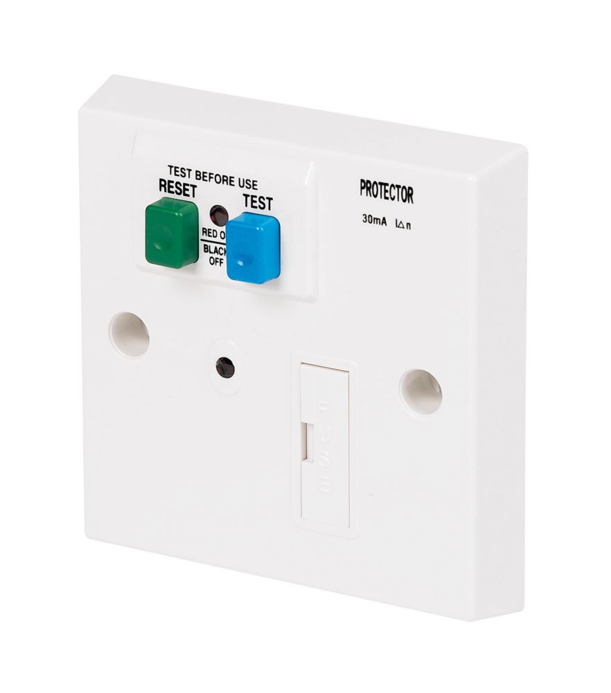

You can also obtain Switched Fused Connection Units with the same arrangement should you wish to 'hard-wire' it.
If that socket circuit you've spurred from is not already RCD protected, then
83049_P
or
27025_P
The sockets are all RCD protected so there for so is the spur.
So is it ok just to connect the spur via a switched 3A FCU?
