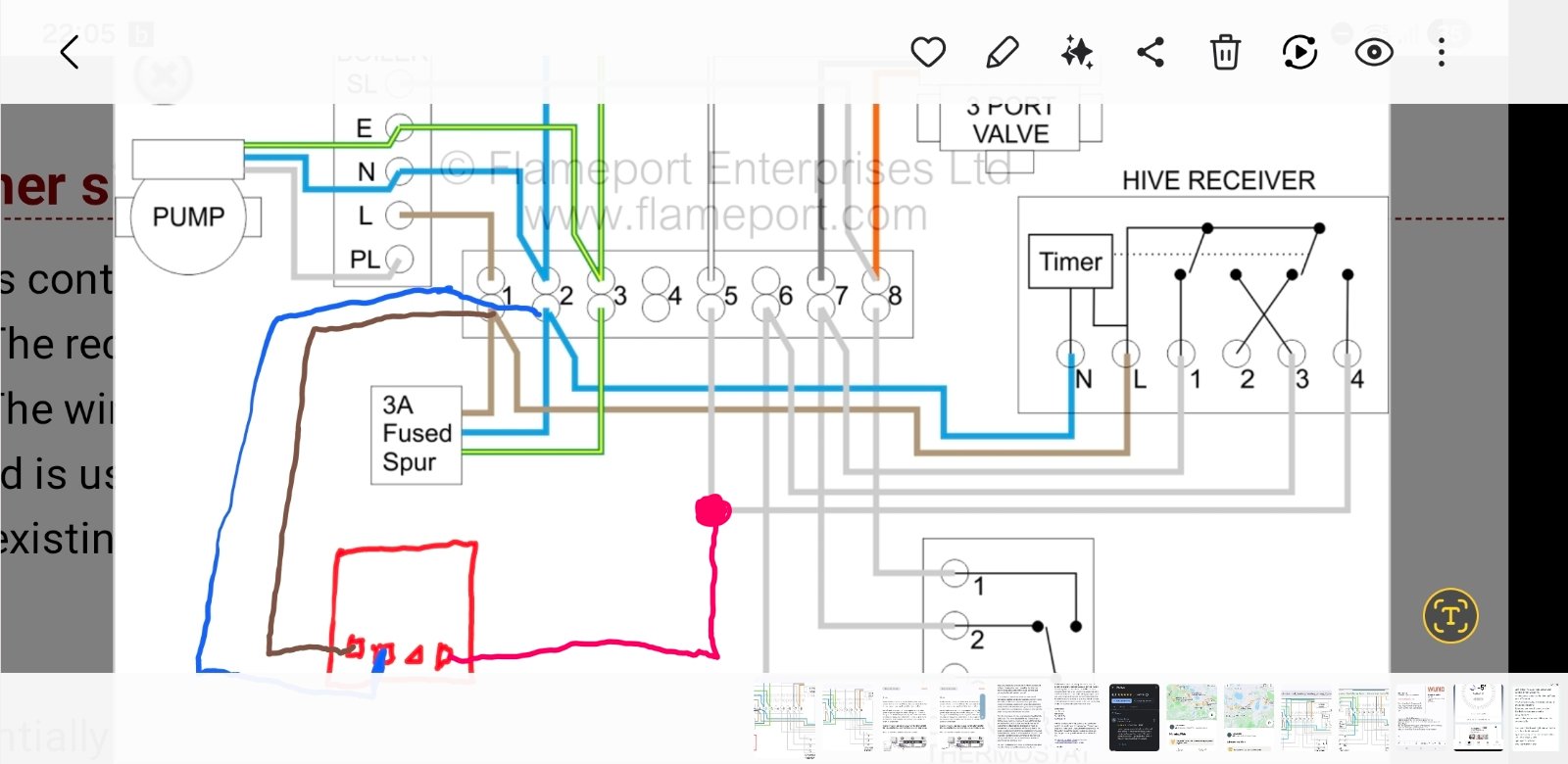

This is good to know. Wiring isn't really my favourite thing to do.You can install it anywhere convenient, where you can intercept the necessary wires. I.e. the wires to the TADO receiver and the wires to the pump (and a mains supply)
So let me just make sure i get this correct for a y plan.
So I have my N L from the fused spur in the Wiring centre which i can take to the relay, then as the CH common is linked from live in the receiver can I link this at the relay? Then the CO which goes to the white wire on the zone valve and so connect into that before the zone valve.
I hope that makes sense.
