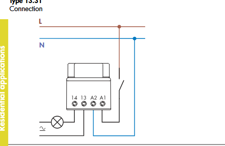

Wiring a relay to protect a programmer help.
I read this as : 240V SwL from Tado HTG NO "call for heat"
closes contacts 13 (in) and 14 (out to load), in your case 13 would be permanent live.
HTH Disclaimer: I'm also not a qualified electrician.

If the pump surges and fuses the switch in Tado then why doesn’t it fuse the switch in the motorised valve?
I think, that the contacts are simply welding up, rather than fusing. The voltage surge, resulting from making the very inductive load, is welding the contacts closed. The relay is adequate for the load, but not adequate for the inductive load.
Also: The Tado diagram posted applies to where the pump live is fed from the boiler ("pump run-on"). This cannot be the case here, rather it would be an old-style Y-plan.

I see in the diagram you posted, you have the neutral and live going to A1 and A2, then the heating NO goes to 13 and then out on 14 to the white wire to fire the boiler. Is this correct?
Also the Tado technical guy had the neutral in A1 and Live in A2. On the manufacturer's schematic, it is the other way around. Does it matter at all?
