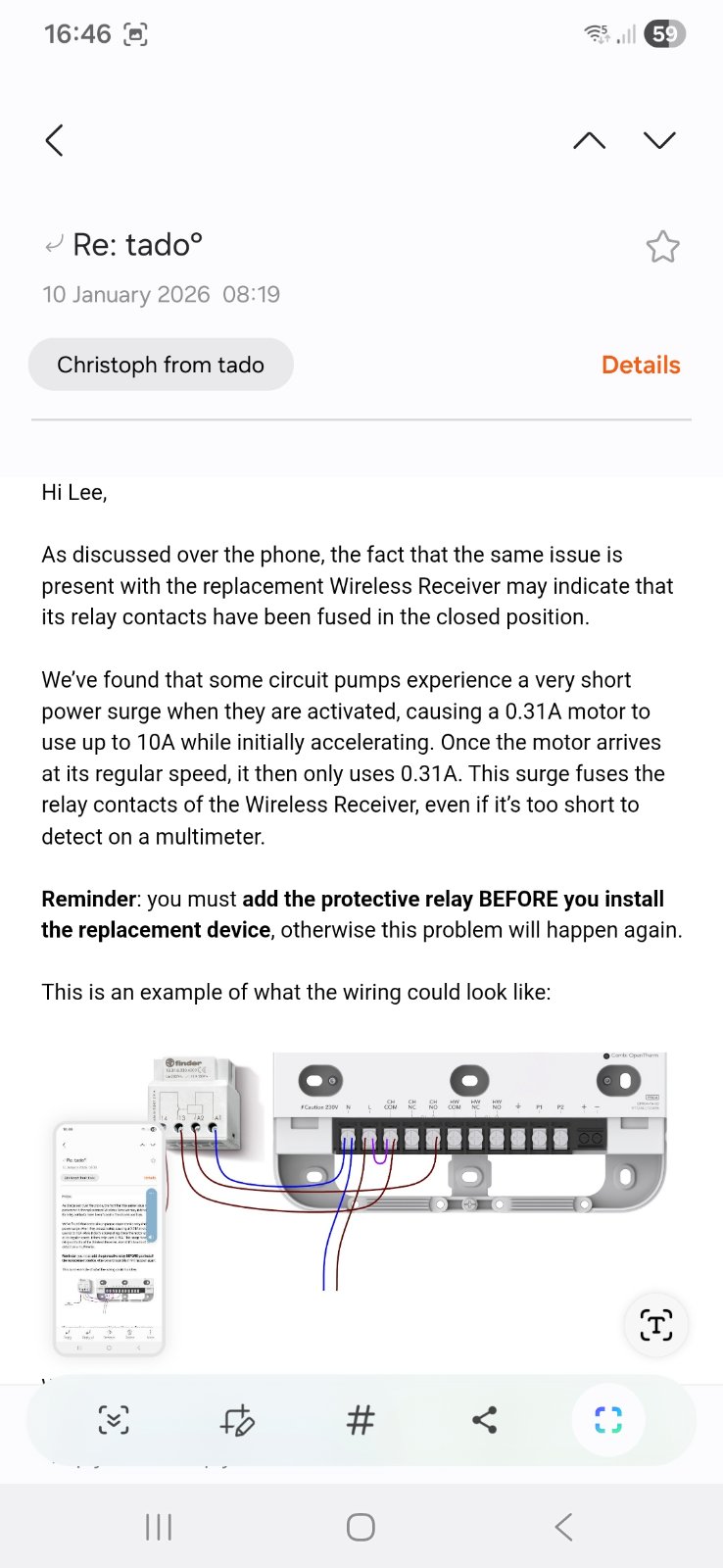

I have installed a Tado v3+ receiver in my house for just over 1year. Around 3 weeks ago, the heating would just stay on always without any demand. As this was under warranty, tado sent a replacement and after 3 weeks it has done the same. The relay has fused closed in central heating mode.

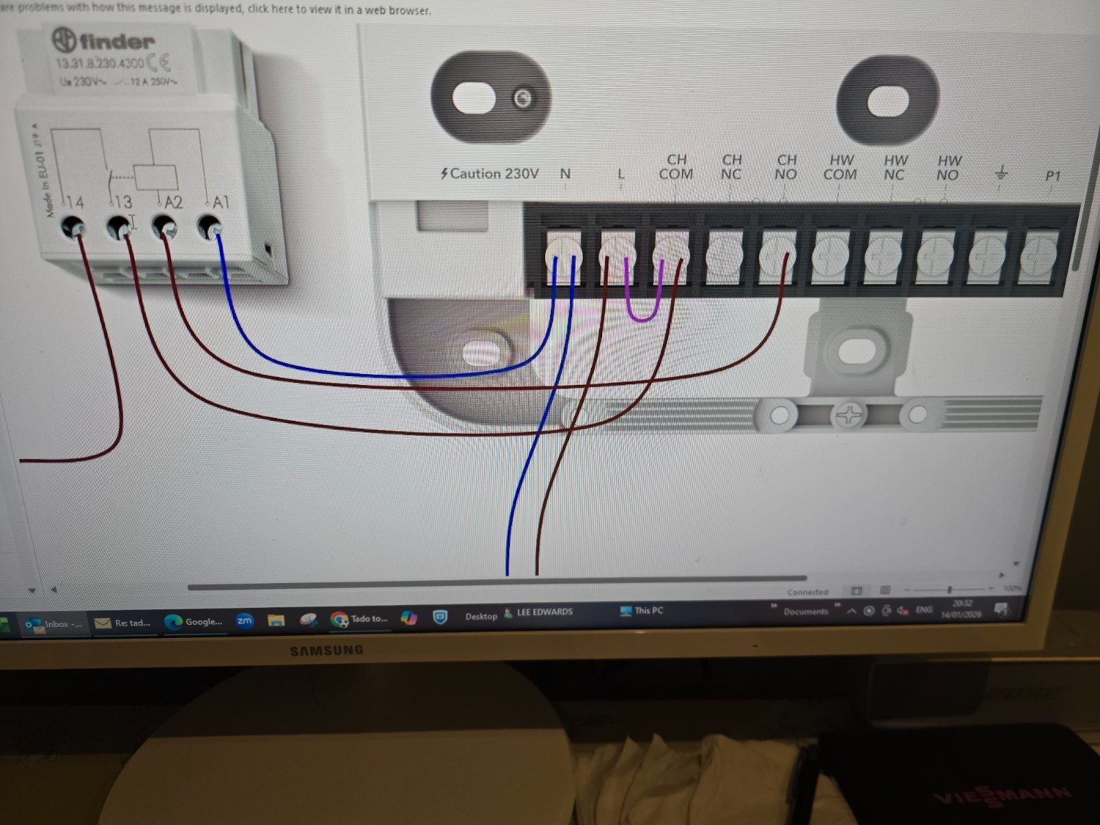

Tado are going to send another one but said I need to install a relay to stop the pump fusing the contact in the receiver. Now, they have sent an image so please find attached. What I need help with is where to install it. Can it be installed in the wiring centre? It is a Y plan set up.
Any help would be fab.
Regards Lee
