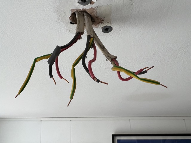

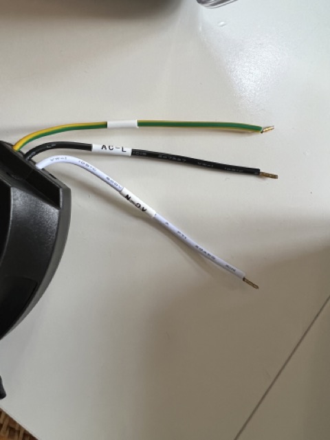

I've just got a Create Windcalm DC fan which is a fan/light unit and only has a live, neutral and earth wire as an input (image 1).
I want to wire this to an existing switch loop ceiling position (image 2), but would like some advice as to how to wire the current wires as there are not enough inputs on the new unit.
Just to add, the light switch will be permanently on after install as this is a wifi-controlled fan.
Has anyone got any thoughts? Thanks in advance!
Windcalm DC Fan unit:

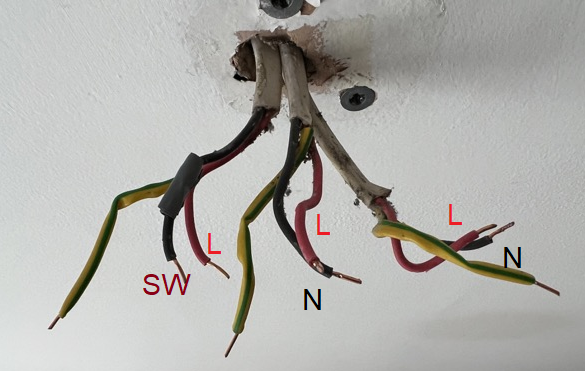

The three L wires should be connected together in a terminal block and nowhere else.
The two N wires and the Neutral from the fan ( White ) should connected together and nowhere else
The SW wire ( with the sleeve ) should be connected to the Live from the fan ( black )
All the Earth wires must be joined together.
