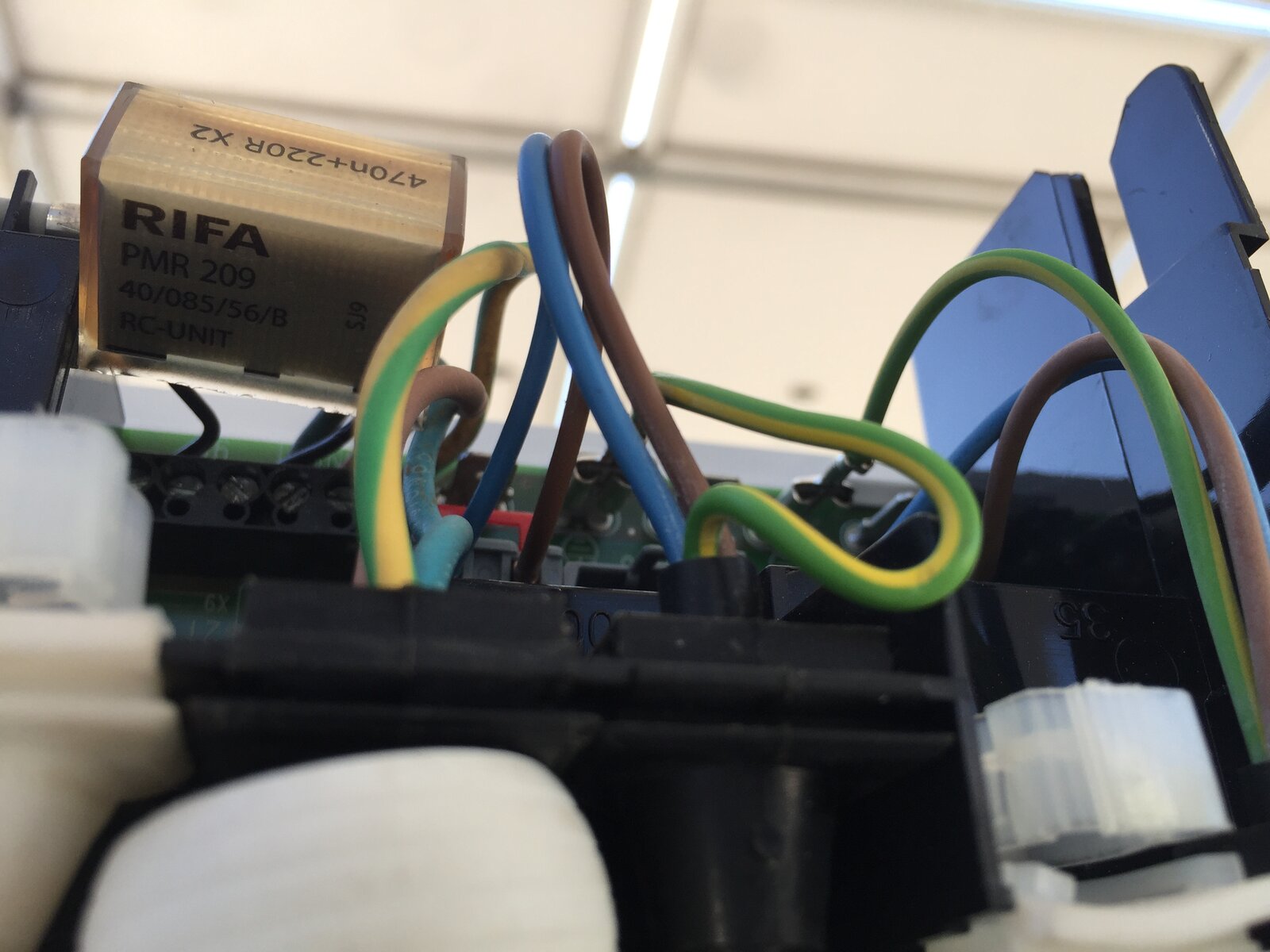

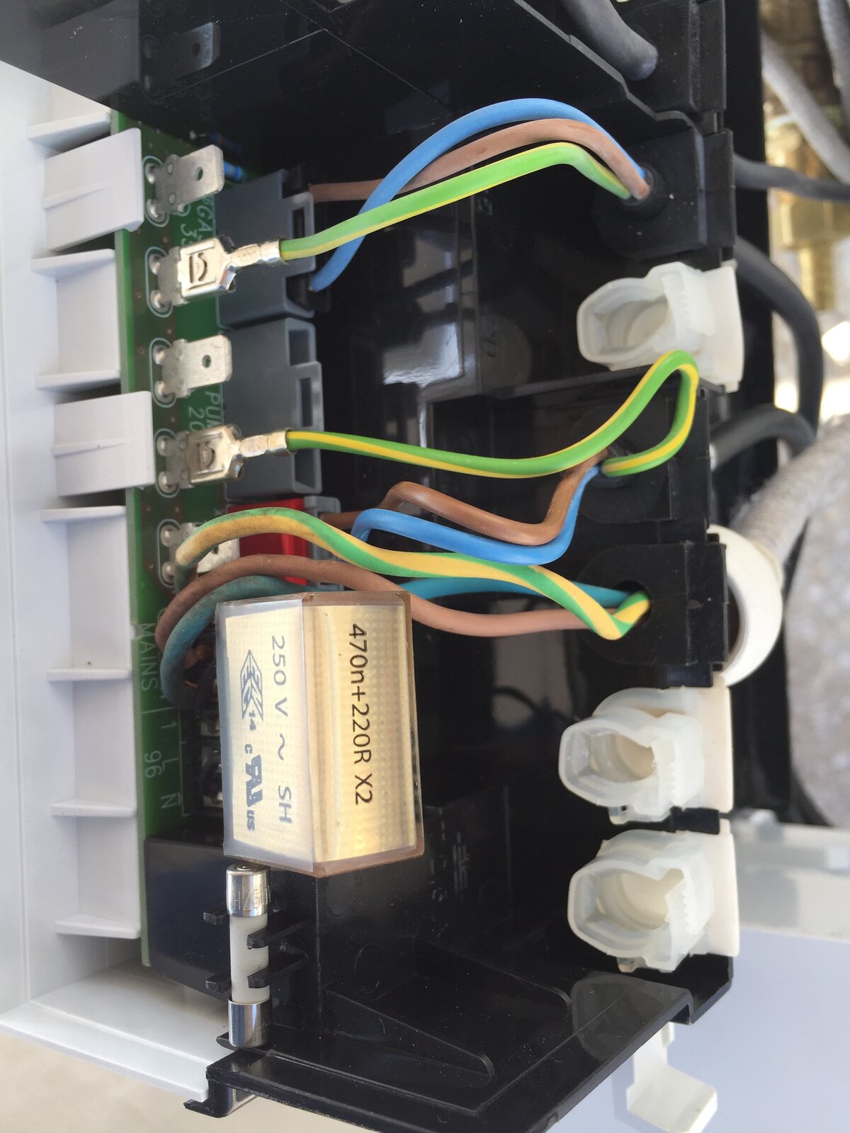

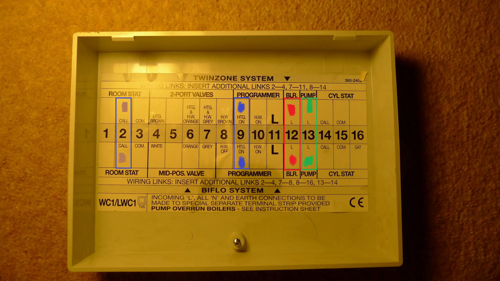

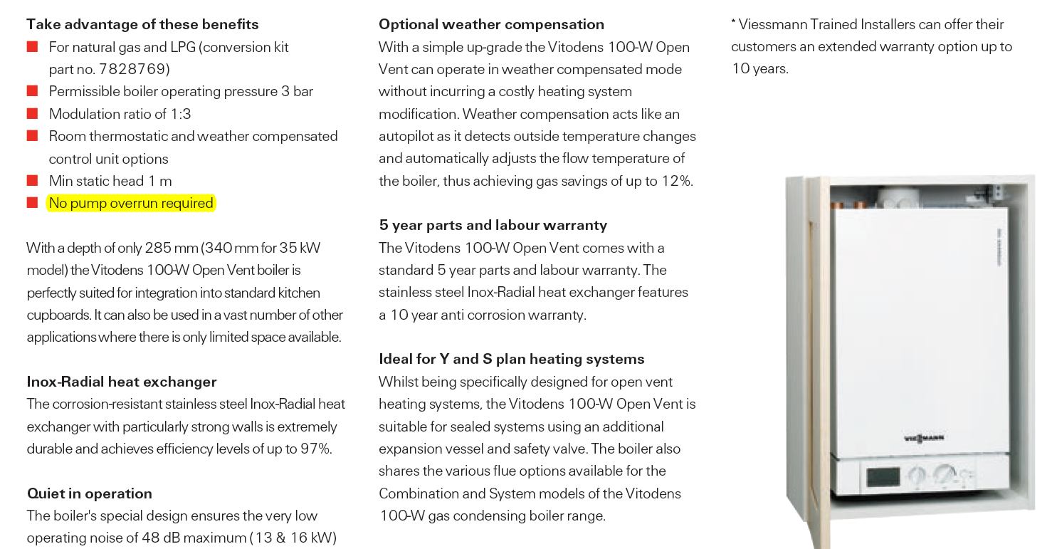

Attached are two pictures of boiler PCB with a capacitor connected to boiler PCB, I am not sure what is the purpose of the capacitor and does it needs to be wired in wiring center? In the wiring center there was a black wire which wasn't connected to any terminal but taped and tucked separately inside, could it be that is coming from this capacitor? I have made connections from boiler's N,L,E to the wiring center, have also wired the external pump to the wiring center under relevant terminals Terminal 12 and 13 marked as boiler and pump terminal respectively. Boiler documentation says no pump over run required.(see attached)
I have run a two core wire (low voltage) from wiring center to Lounge where I want to install programmer and thermostat. I believe this cable will make call for heat via thermostat or programmer, and power (N,L,E connections) can be taken from home wiring? Correct or do I have to run N,L,E connections all the way from wiring center to the programmer?

I have made connections in the attached wiring circuit for boiler and pump, how do I wire programmer and thermostat? (both of them will be in lounge)

Well, I think you’re programmer will need a L, N and switch, so more than 2 core, and depending on which thermostat (wireless or wired) will also depend on cores.
The capacitor is an interference suppressor (a resistor and capacitor in series), normally used across switch contacts. Unrelated to any controls wiring.
Not clear what it's connected to in the boiler, the boiler instructions should have details.

If you are only using the boiler for heating, then you don't need any plan or any motorised valves- it's just a case of the boiler and pump are switched on when heat is required.
Programmer has L,N,E permanent supply.
Boiler may require permanent power, in which case L,N,E to that as well. If not then just N&E permanently connected.
Pump has N&E permanently connected.
The control is 1x switched L output from the programmer to the thermostat, and from the thermostat to the boiler L input and pump L.
That is all.
