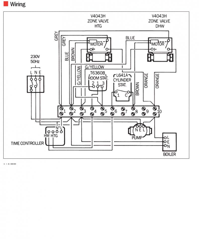

I have the following system:-
Fully pumped Potterton Profile 100e boiler
Separate Honeywell motorised valves for heating and water
Grundfos Pump
Randall Timer
Satchwell room thermostat
Megaflow unvented cylinder
Can somebody send or direct me to a wiring diagram for the above type of system. Is there anything specific one has to bear in mind when connecting the above.

use the zone valve supplied with the cylinder on the hw feed as well as the zone valve in the s plan
wiring for that is in the cylinder instructions :idea:

Can you please explain what you mean by this.
My installation manual for the Profile 100e shows more than 3 wires (live, switched live etc.). Which live and neutral on the S-Plan wiring diagram relate to the wire connection in the boiler.
