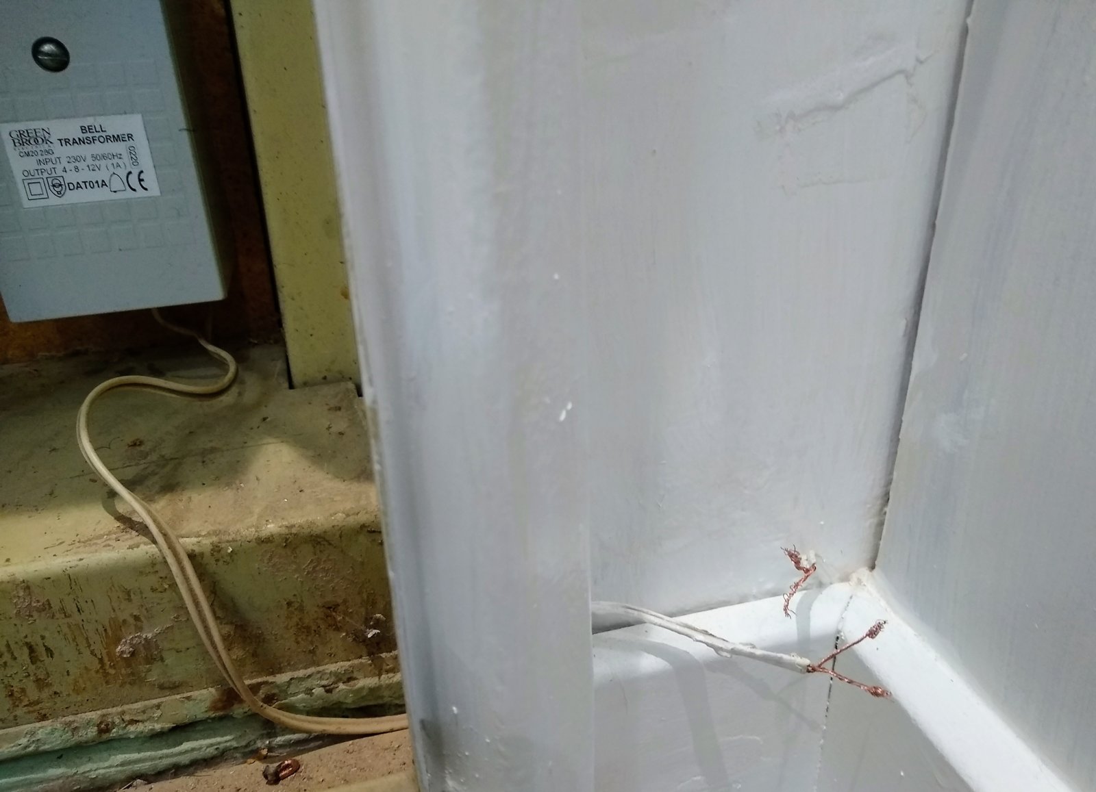

I am attempting to join my doorbell wire which got severed
I have noticed that when i bunch up all the wires (i.e. twist all four wires together) the doorbell works.
Is it okay to do this?
Or do I have to use a connector block to join two wires at a time?
In the end, i plan to stick all the wires in a choc box. However i am curious whether there are any alternatives to this?

looks stranded to me, so wago no good.
Yes, join two wires at a time , otherwise bell will continuously ring!

Initially, i used wago 221's and the bell operated as normal.
I then decided to bunch all the wires up to see what would happen and strangely the doorbell worked as normal too.
However the transformer started humming a bit louder than expected and it got quite hot.
I chalked this up to age so i replaced the transformer. The new transformer is quiet
Any idea why the bell appears to function as normal when bunched together?

To clear up any confusion.... are you saying that 2 wires have been severed leaving you 4 ends and you've wrapped all 4 ends together???
If so, it's shorting out the transformer and explains why it's getting very hot. Bad idea.
I can't explain why the bell still works though, it shouldn't do if the above is true.

Yes, i wrapped up all four wires (for experimental purposes) :D
And yes, the doorbell still worked
I wil connect two at a time and use the heat shrink as SFK suggested
