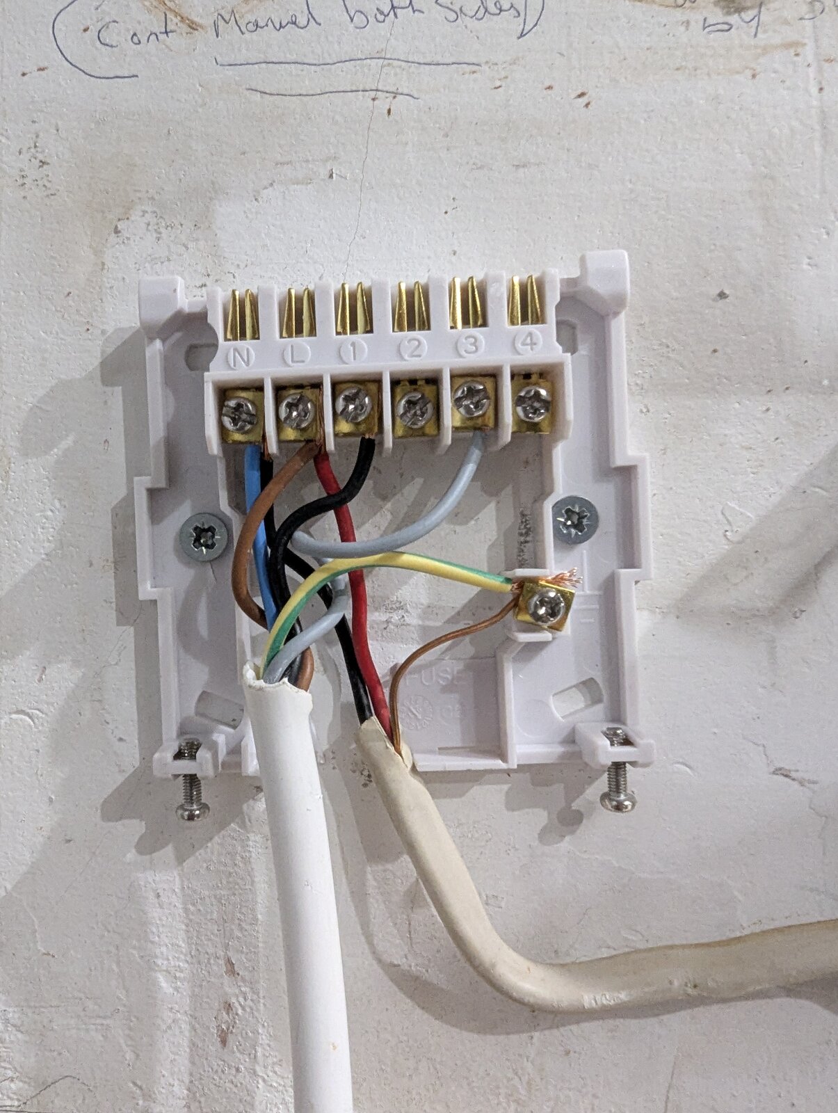

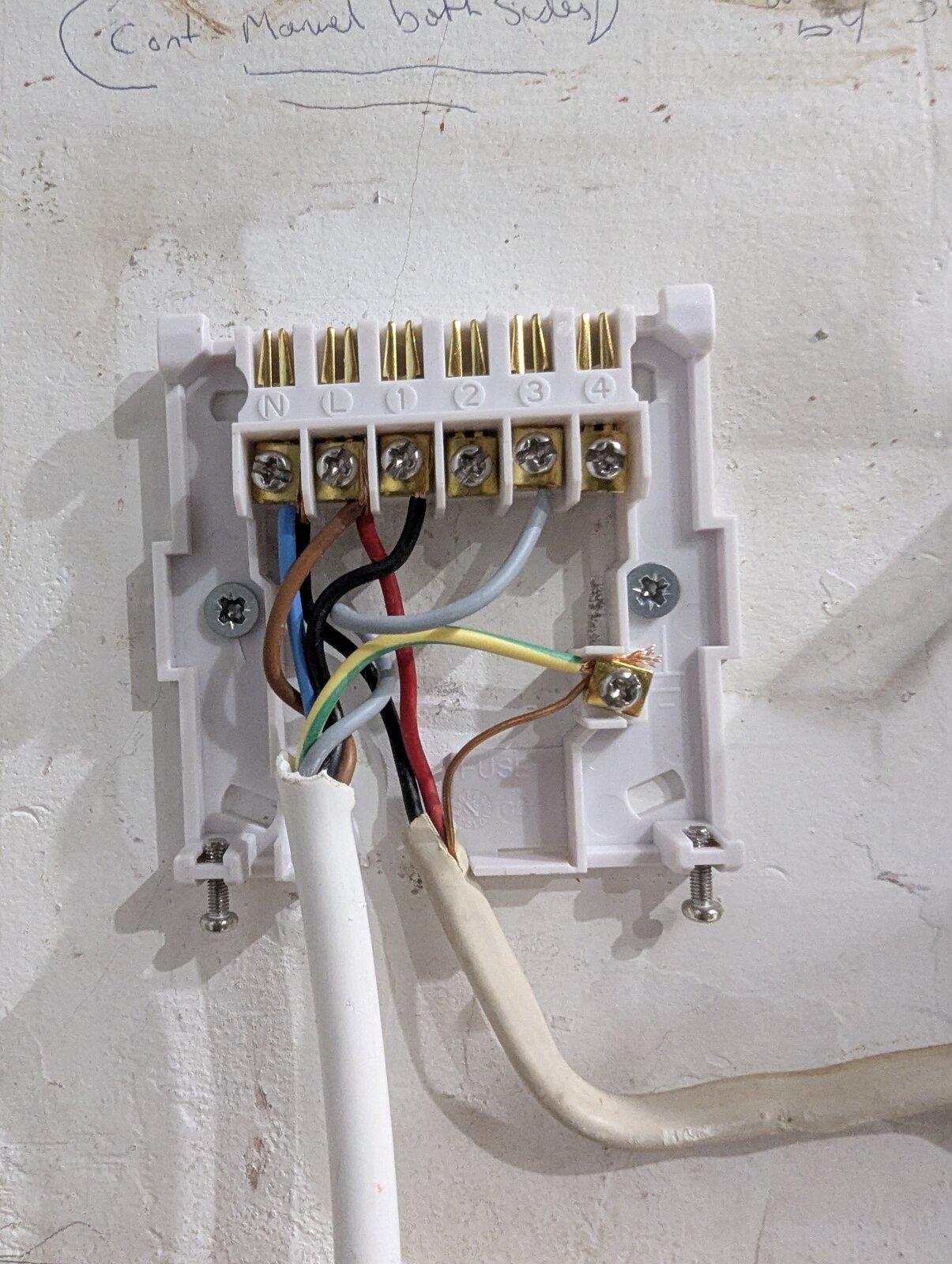

Hello, I know this has been asked a few times prior, but I want to be sure for my specific scenario...
Just had a standard boiler swapped out for a new Vaillant Ecofit Pure 830. Old boiler was connected to a Hive heating and hot water thermostat. I was hoping to use this for the combi boiler rather than mess about changing for the single channel version.
Gas engineer ran out of time tonight so will be back in the morning, but seemed a bit stumped on the wiring. I want to make sure he does it correctly first time (as we currently have no heating).
I've attached a picture of how it's been left, if someone could advise on which wire where that would be great.
I'm thinking live to live, neutral to neutral, then one of the wires into channel 4. There is a black wire (currently in 1) and a grey wire (currently in 3), so which one would that be? And what happens to the spare wire?
Thank you!

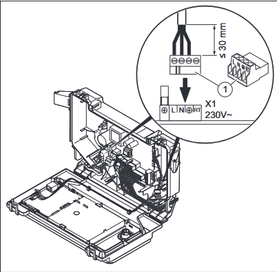

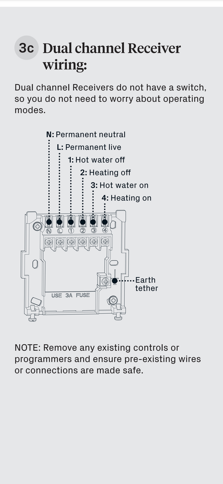

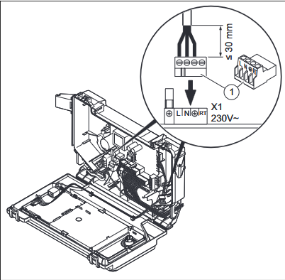

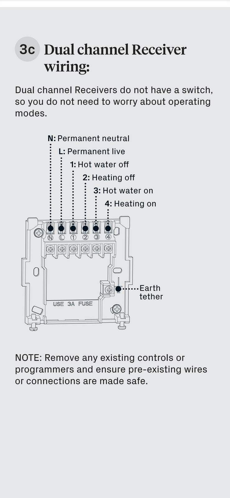

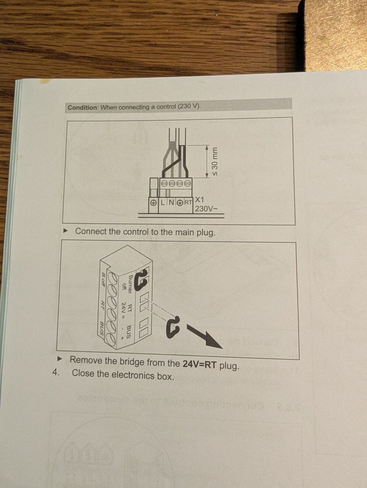

Terminal 4 of the dual channel Hive backplate would connect to RT on the boilers mains voltage terminal block.
As per the instructions, the 24V=RT link wire would also be removed.
The spare wire would be safely isolated and tucked out of the way.
The bare earth wire in the Hive backplate needs a green/yellow sleeve.

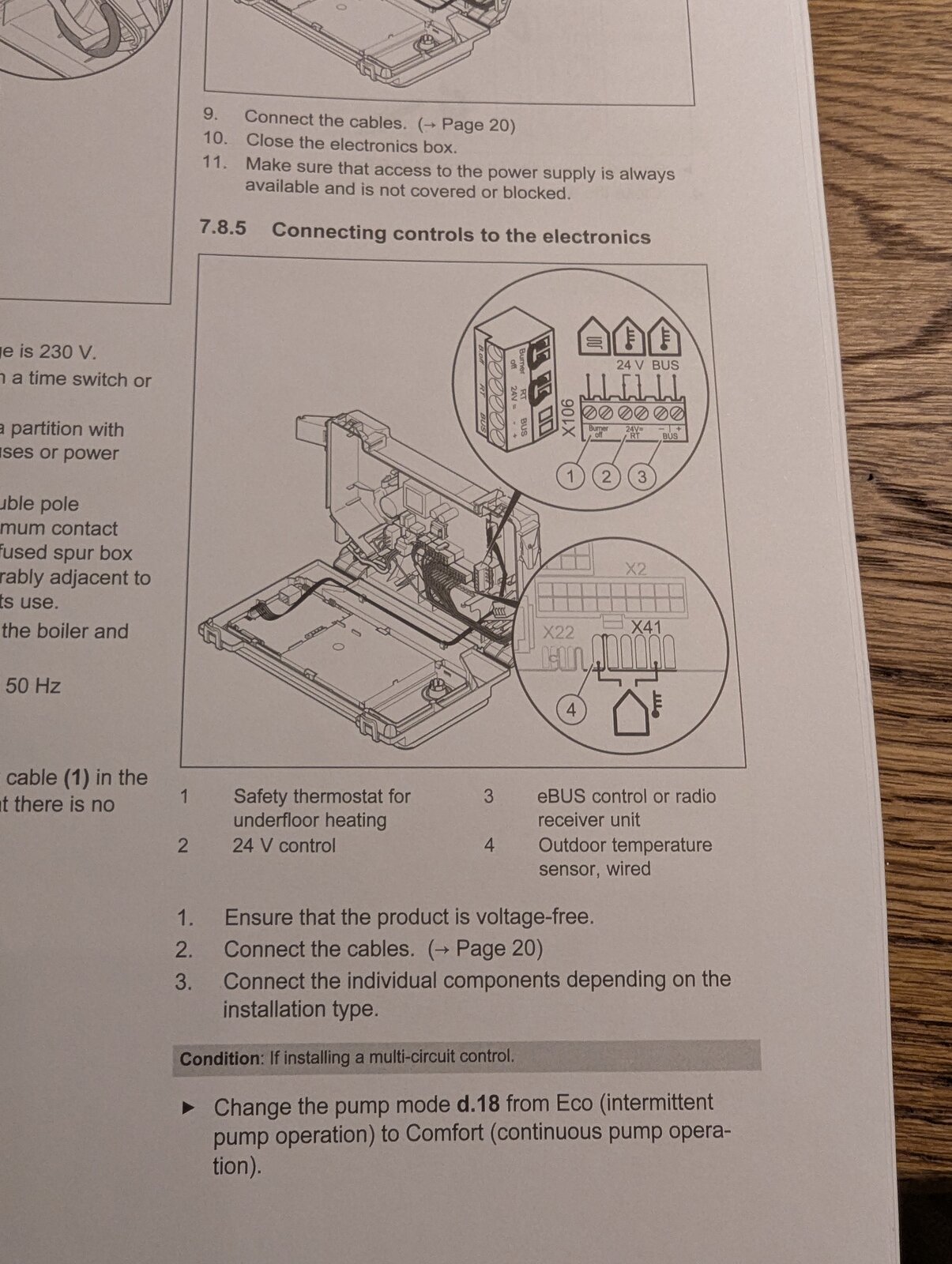

the two terminals at the bottom are for OpenTherm, I note BUS connections, but not sure if your boiler is OpenTherm or if it has its own special system.
The whole idea with a modern boiler is it is not switched on/off, but has analogue controls, so the boiler flame is turned up/down to suit requirements, the boiler will work on/off, but not as efficient as up/down. As to how much it costs to use the old digital on/off rather than analogue up/down, I have no idea.
We are shown diagrams
the idea is the smoother OpenTherm or other ebus control leaves one being able to set the temperature slightly lower. I have a feeling you have to use Valiants own thermostat, but some do offer converters, but your installer should know what is required. But there does not seem to be a 230 volt (low voltage) option, so you will need a 24 volt (extra low voltage) thermostat.

Thank you for your reply. So if I'm following correctly, only one cable wire from the RT runs to terminal 4 in the Hive block. This could be either the black or the grey wire depending on which end is connected to the RT on the main block. The other wire is then not used.
Is the link removed from 'burner off' position too or just 24v RT?
I believe this is a new cable, but I'm not sure. I was hoping the gas engineer would be able to figure all this out, but he seemed unsure as the dual hive is not intended for combi boilers, so I appreciate your help on this. Also, he blew a fuse when initially attempting to connect to the Hive before calling it a night. I wonder if that had to do with the 24v link?
Yes, and make sure the spare wire isn't connected to any terminal on the boiler side either.
No, the link is only removed from the 24V=RT connector.
That's a little concerning - he had the wiring set-up for a single channel Hive using terminals 1 and 3. Hopefully he hasn't connected the other end of the cable to the 24V=RT terminals, or there may be damage to the boiler PCB.
Sorry, yes, page 21 of the manual it shows 1742113937118.png the 230 volt option. Unfortunately, I don't have the option of analogue control. So can't really say from first-hand experience if worth getting the proper thermostat. As long as also using the linked TRV heads, then likely there will not be a large difference.

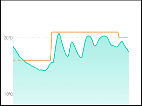

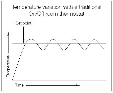

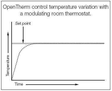

If I look at my TRV it gives a patten like this 1742114690821.png because my boiler does not modulate, and can only switch on/off, can't see the point of having a modern modulating boiler, and then not use the better control offered.
