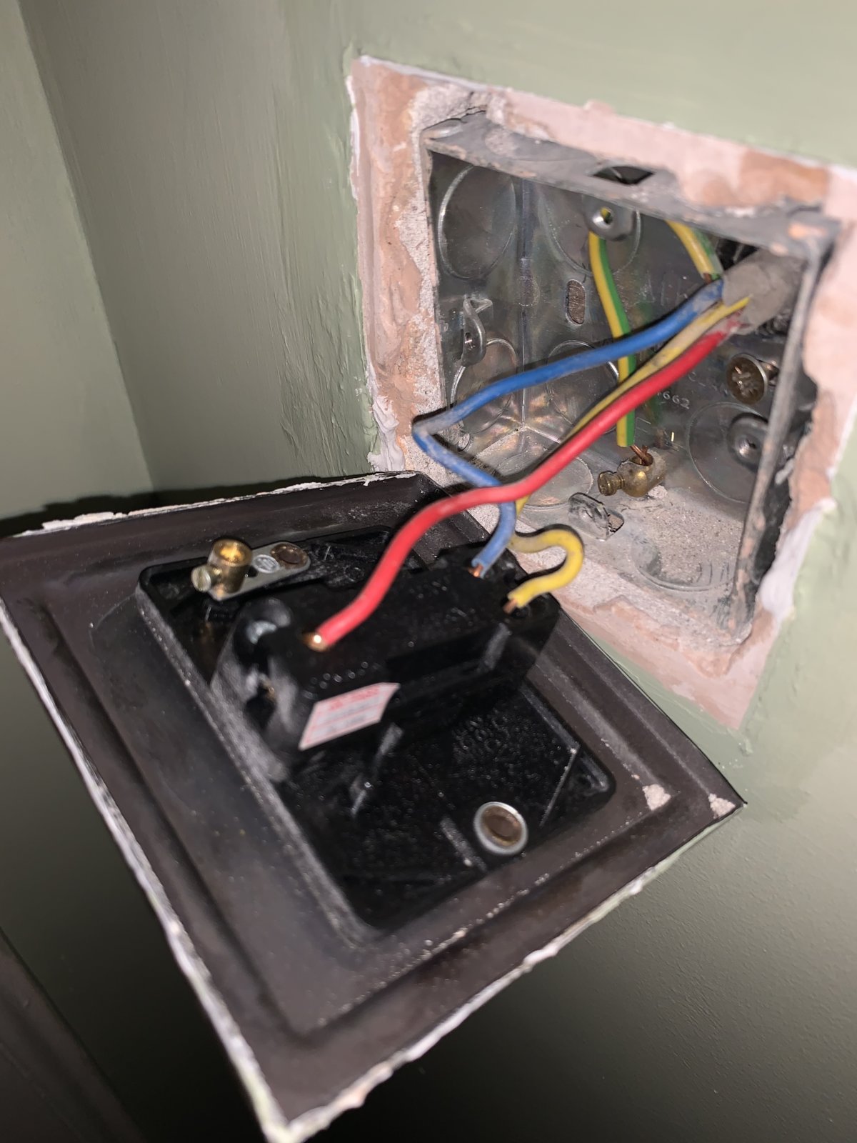

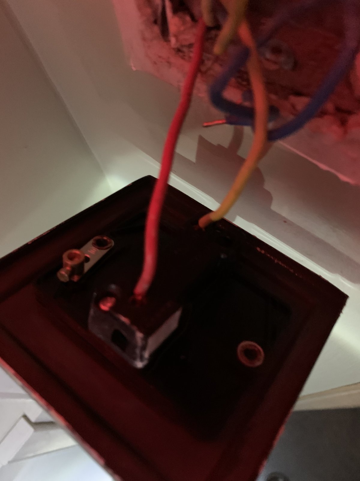

I have attached pic of both the switches. The one that is connected was the switch that was working fine. I have made no changes. The other picture is the bunch of wires I have to connect the replacement switch.

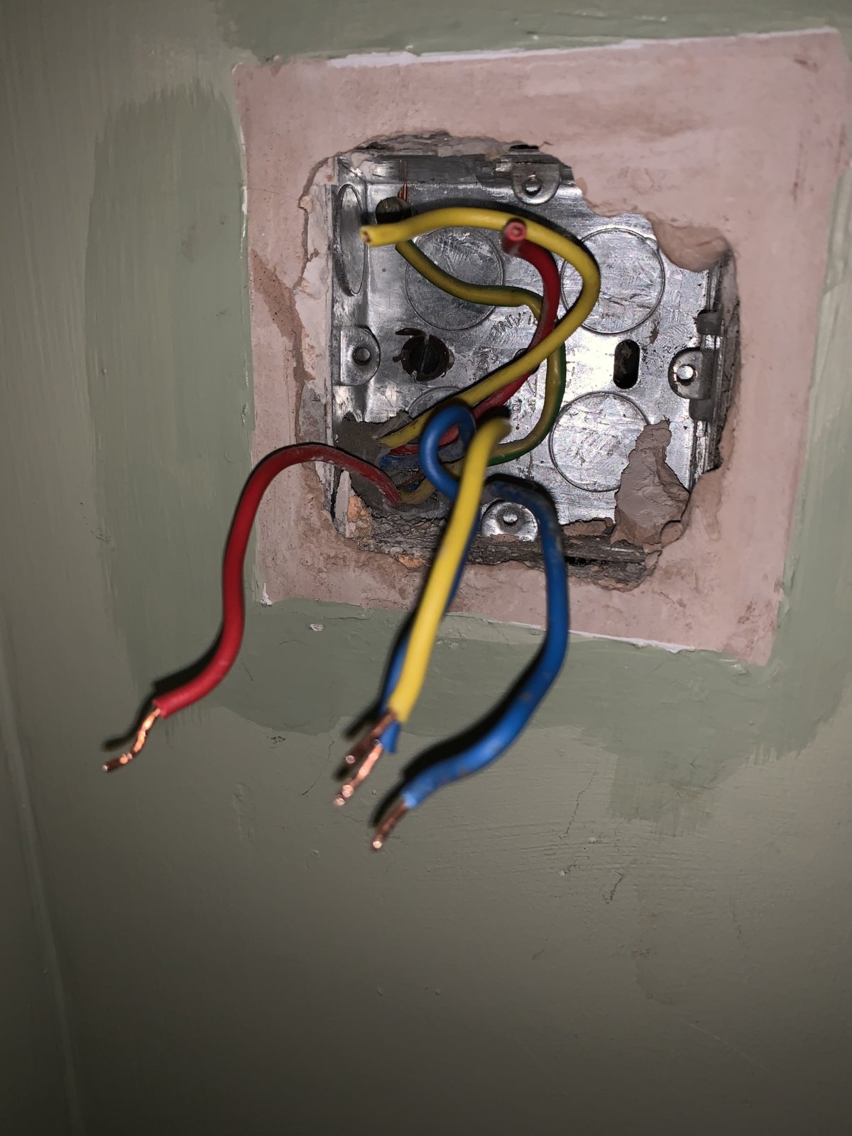

In the cable sheath that contains the red conductor that is " cut off and tucked out the way " ,what other colours does it contain ( forget the bare copper earth conductor)
It contains a single yellow and a single blue wire.
Your original post does not give the correct description . there are two yellow and two reds . The switch plate is metal ,and the earth conductors must be connected to the earth terminal on the back of the switch plate.

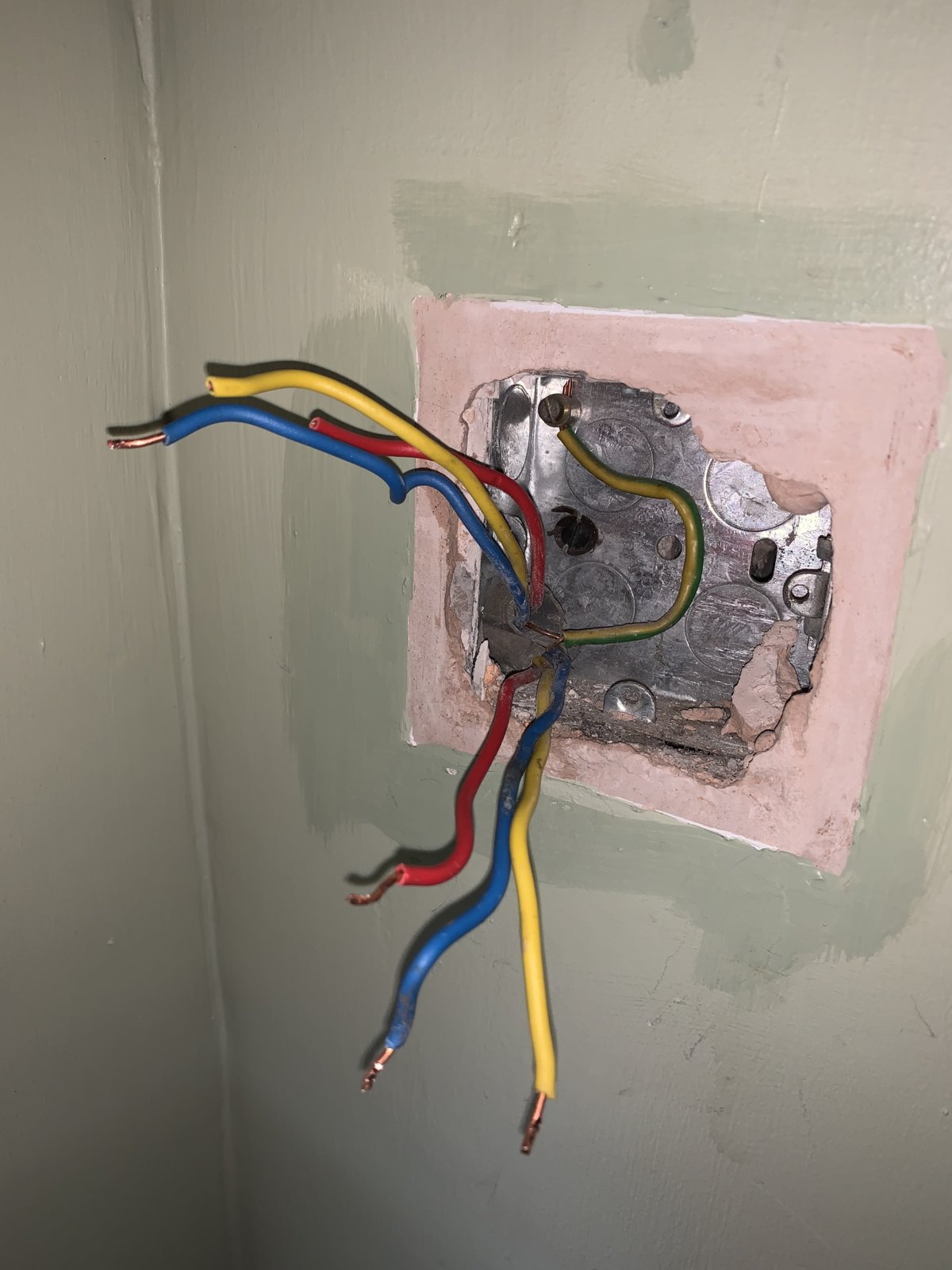

Here's a better pic.
Apologies. That will be my lack of knowledge of anything electrical.
Did you take pics of the original switch and the wiring ?
You told us that the two blue conductors were not connected in the old switch , the two way switching quite simply could not work if they were not connected , if they were loose ( not connected to each other) and the bare copper exposed ,its likely that they have come out of the terminal when you pulled the switch from the wall.
They were definitely not connected but may well have popped out as I was pulling the switch out.
Not a great pic but that was original switch after being removed from wall.
