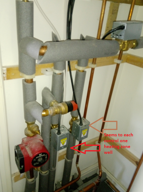

Thanks all for the responses. It is the ultracom hxi model. I will take some airing cupboard photos when home – to answer the question around why I didn’t think the HW was controller by the timer – I turned the timing mode to OFF last night on the HW side, however the water was still perfectly heated when I needed It this morning.

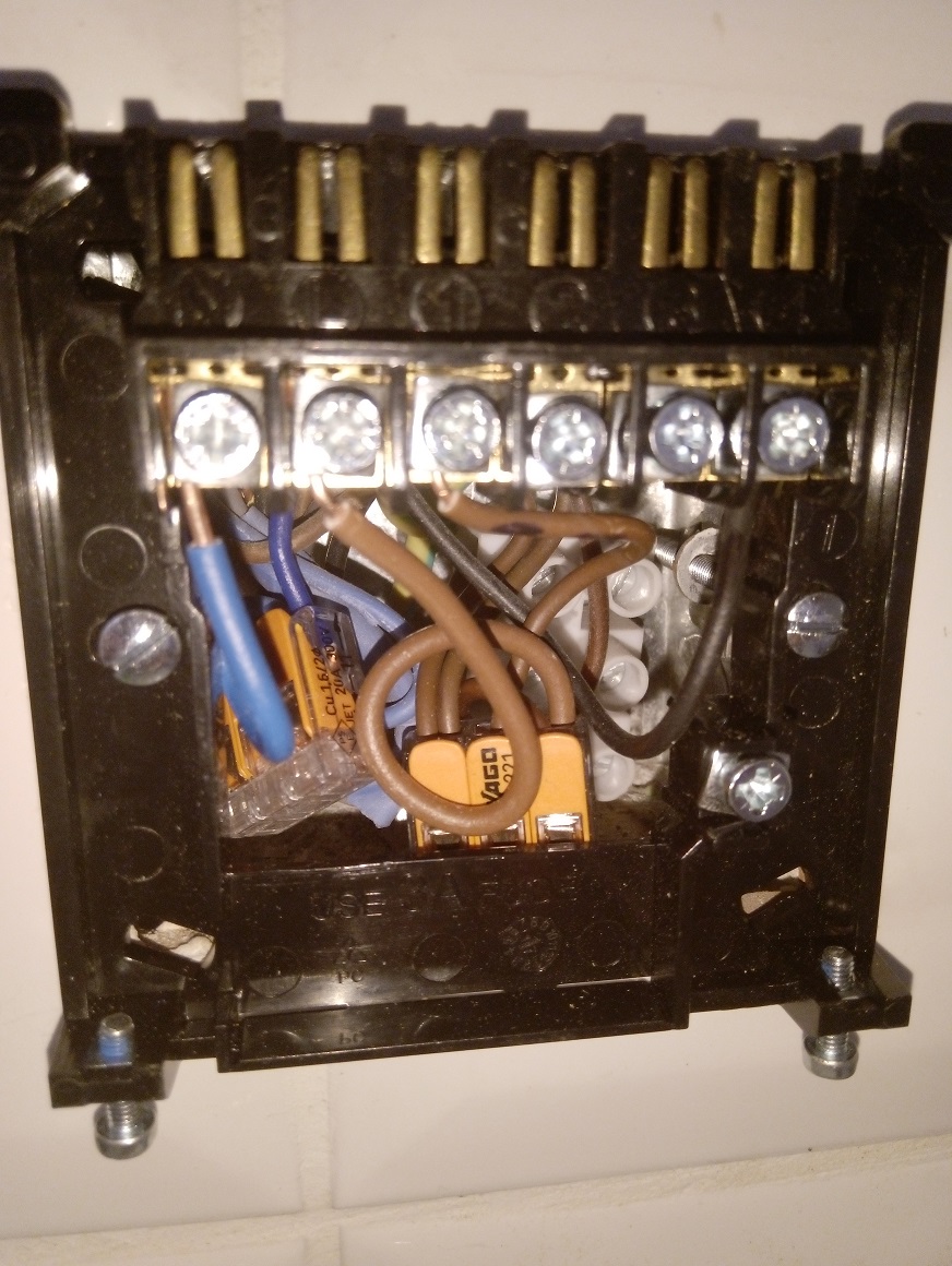

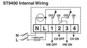

on the sticker on the ST9400 it says it is -- i guess im not clear enough to know if this can be altered etc.
I'm not recommending that you go altering things in an ad-hoc fashion, without finding out where wires go and what they do first. But the hot water control wire would normally be in (3) 'Hot Water On'.
There are some systems that use the Hot Water off (1), but even they still have a connection to (3) Hot Water on as well. But you say yours doesn't have a connection to terminal (3).

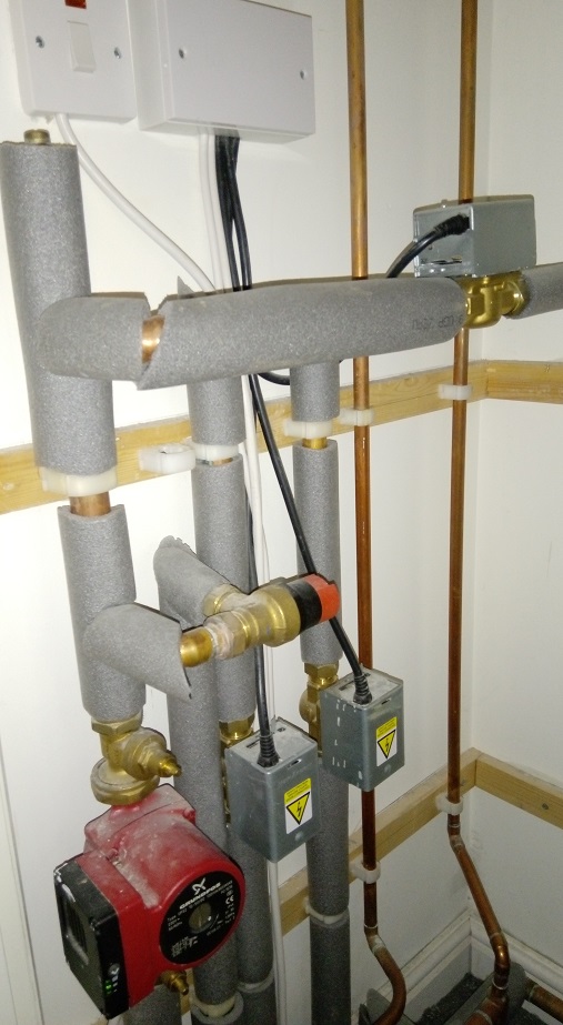

once again - appreciate all the inputs. there is definately no connection to 3 (HW on). there is a black wire to 4 (CH on) and brown wire to 1 (HW off). the wire from 1 looks to go into a wago 221 connector and link to the L wire. airing cupboard is per the attached.

here it is -- there is a wire in L,N,1 and 4

There is indeed a wire in (1) 'hot water off' and In that case, unless you know what is on the other end of the wire, I can't guess why it's there, especially when there isn't a connection in 'hot water on' (3) unless it has simply been put in the wrong terminal, but I would have thought if it was, that you would be aware of that. I'll explain.
With this type of system, normally there would be a wire in terminal (3) 'Hot Water on' that goes first to the hot water cylinder thermostat and then on to the Hot Water motorised valve. When Hot Water is required by both the programmer and the thermostat, the motorised valve receives 230V from them and it winds open. When it's open a small internal switch starts the boiler & pump.
There isn't a connection to 'Hot Water off' required because when the programmer or thermostat switch off the hot water, the motorised valve simply looses its power supply and a spring pulls the valve back to the closed position. (accompanied by a whirring sound)
If it were simply a matter of the wire being in the wrong terminal, the Hot Water would be working in reverse, ie 'on' when the programmer was 'off' and vice versa. You could try a simple test:
1) With the heating set to 'off' and the hot water set to 'off' at the ST9400. Turn the hot water cylinder thermostat to maximum and wait for a few seconds. Is the pump running? It shouldn't be.
2) Now, leaving the cylinder thermostat on max, turn only the hot water on at the ST9400 and wait. Does the pump start up? This time is should.
If it's working in reverse to the above, then the wire in (1) should be moved to (3)
It also looks like there are a couple of wires in terminal 2 (Central Heating off) as well, or is that an optical illusion?

stem and others -- thanks for all the advice. i will perform the test above tonight and report back. i can confirm there is no wire in terminal 2, it is an optical illusion.
this has turned into a real bug bear - i cant work it out. even with the testing above. i recognize its hardly a bad problem in the current environment though. if i turn the heating zones off - the valves make a sound, and the pipes post the valve slowly cool down. i dont find anything immediately happens when i take the test above on the HW. should the valve at the top do something? or only the pump? or both
