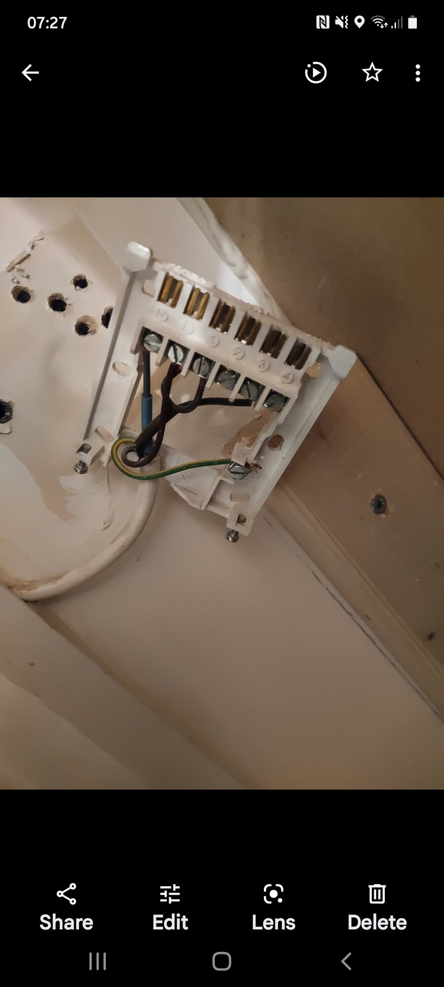

Hi just want to make sure I do it right. On the the old reciever I have a l going into l and a link to 1.
I have a neutral going to neutral.
I have another wire going to 4 terminal. And I have a earth going to the earth terminal. So how do I use those wires to make sure I do it right on the honeywell. It's a t4r reciver. The old one is a drayton digistat 3. Cheers.
I think a photo would help better, as I don’t think the Drayton has numbered terminals.
I've got a wire in n a wire going from l to 1 and a wire going into 3.also last wire is the earth into a earth terminal.
L to L
N to N
Link L to A
Transfer 3 to B
So exactly the same but the wire that is in 3 on the drayton goes in b on the honeywell.
Usually an earth park on T4R, if not connector block.
As @CBW says the earth isnt needed, a pic would be better, just because it is a yellow and green wire doesnt mean it is an earth on a heating system

The old Drayton thermostat is a Digistat, but the receiver part will probably be an SCR. If so, the SCR has the following connections:
If your T4R receiver box looks like this:
Then the existing wires move from the terminals at the SCR to the terminals at the T4R that have exactly the same functions:
SCR N to T4R N
SCR L to T4R L
SCR 1 (Common) to T4R A
SCR 3 (Call for Heat) to T4R B
The two L terminals in T4R are joined together, so effectively the same terminal. The second one is for convenience to use as the link between L and A
As has already been said, if you have anything different post back a photo.

Can someone just clarify what's been said in post now put pic up of the wires.
