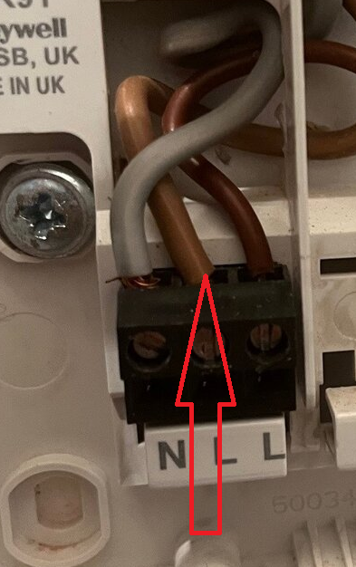

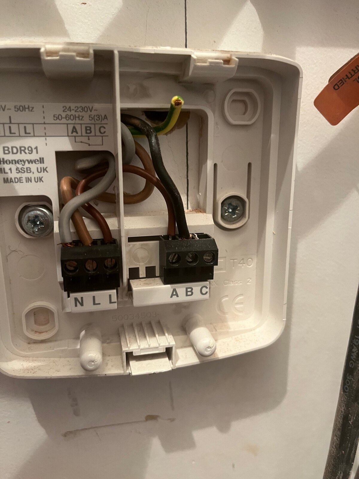

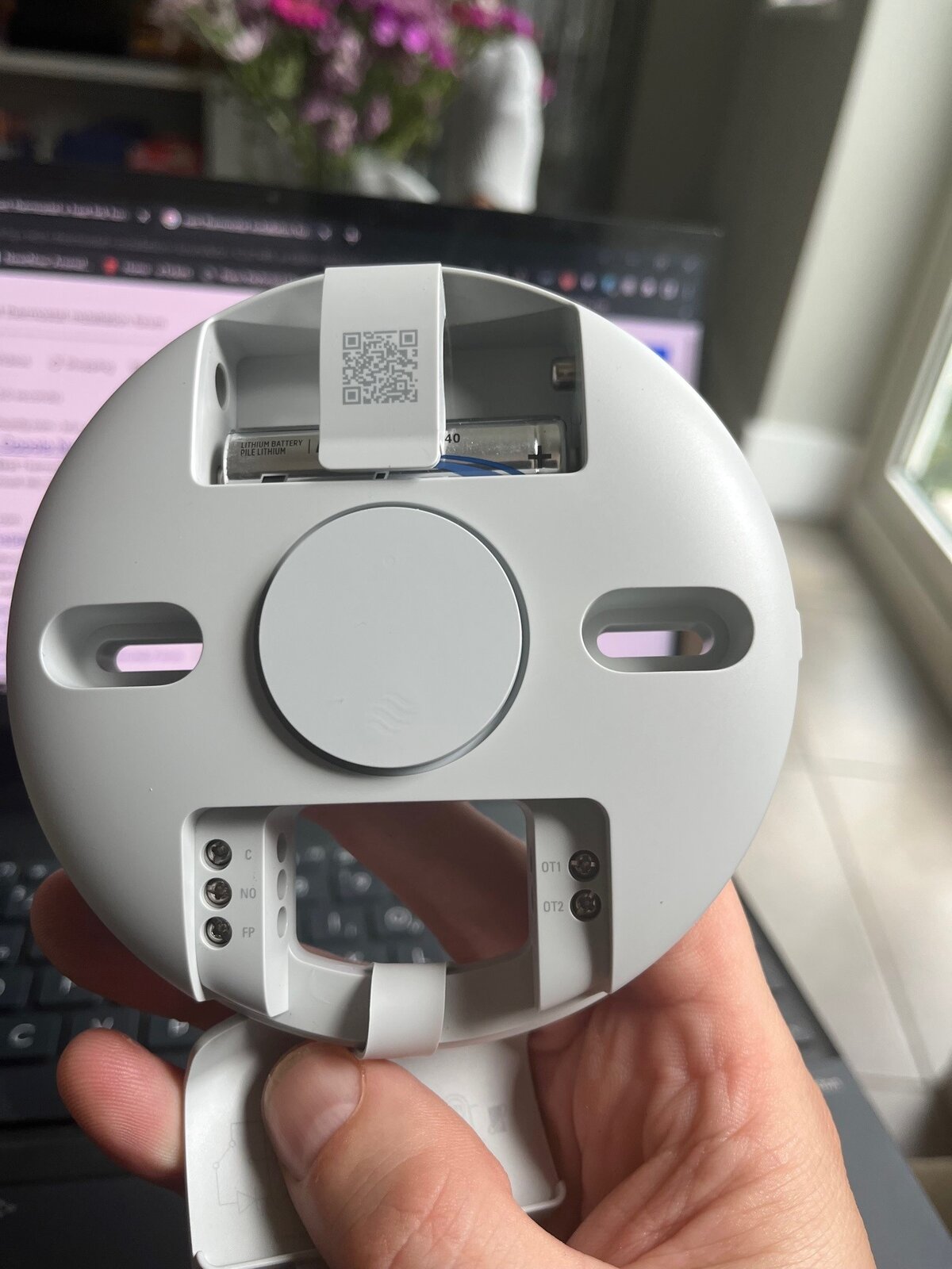

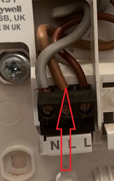

So I really should have got an electrician but there you go. So after wiring I get the message from the thermo that it cannot detect and open therm.
I terminated N and the middle L and connected B to No. What has thrown me is the the L on the right was connected to A. So that wire is now removed and I have nothing in A on the Heat Link :(
Hope that makes sense!

The BDR91 isn’t wired up to opentherm either, so this would need changing at the boiler end if your boiler supports it.
ok :) so as I understand it. From left to right on my BDR91
N = terminate
L = C (on Heat link)
L = now empty
A = now empty
B = NO (on Heat link)
