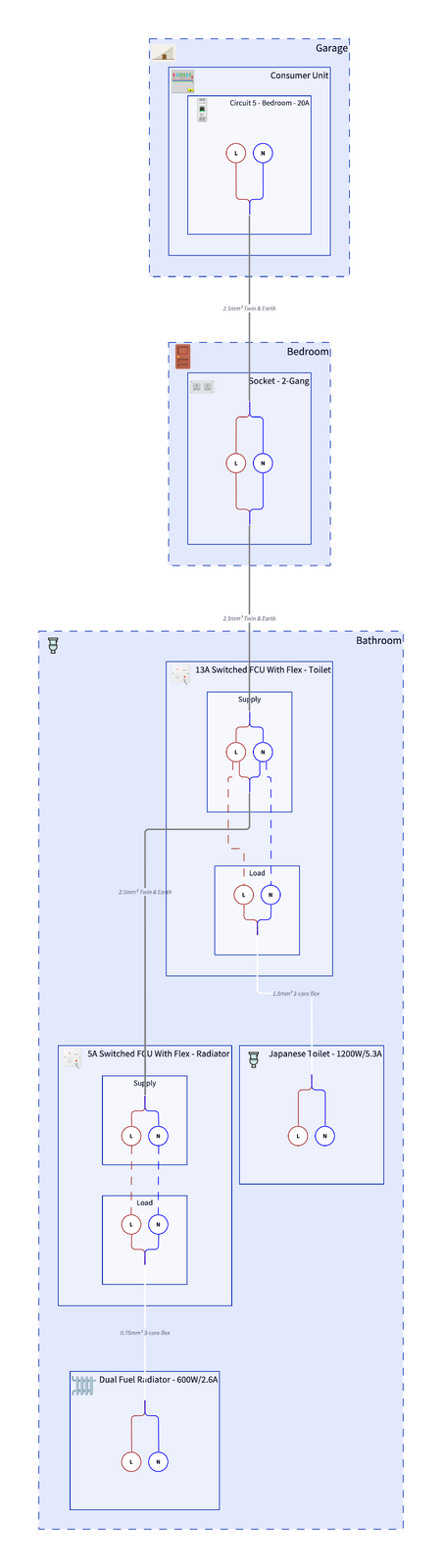

I am planning to wire a Japanese toilet and a dual-fuel radiator in my bathroom.
My plan is to tap into the bedroom radial circuit to supply 2 switched FCUs: one for the Japanese toilet and one for the dual-fuel radiator. Both FCUs are in the bathroom but outside the zones.
There is also a ring final in the house for supplying all the other sockets, but I wanted to avoid tapping into it, as it is already serving most of the house. I figured using the bedroom radial would keep things more balanced (as it is barely utilised, only for hoovering really). The radial is also next to the bathroom so the wiring is easier.
I have created a wiring diagram. Is my plan sound? Feedback appreciated!
Diagram PNG (if this doesn't load properly, please see the attached PDF)
