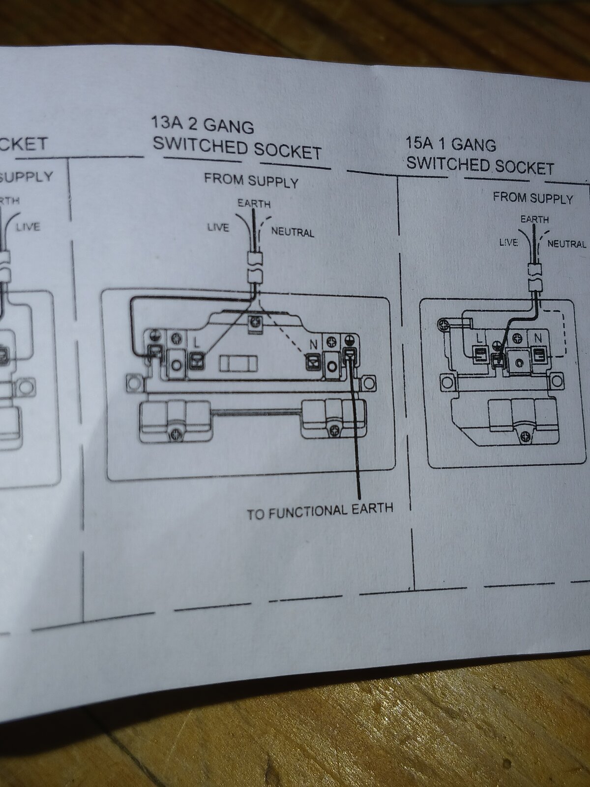

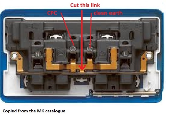

Sorry to make more than one thread, but I figured it was clearer to do separate threads for separate questions. I need to put in a couple of sockets and the ones I bought contain something I haven't seen before -- the instructions specify connecting a wire 'to functional earth'. I've included a picture of the instructions as well as of the box. My guess is that it's a wire extending from the earth terminal on the back of the plug, to the small terminal at the bottom of the back part. Is that right? Is it because the box is metal rather than plastic? Thanks for your help!

That socket is confusing as it does not treat the Protective Earth as being separate and different from the Functional ( Clean ) Earth
A Functional Earth (FE) is used for operational purposes such as reducing noise and improving signal integrity in electronic systems.
A Protective Earth (PE) is used for safety, preventing electric shock by grounding exposed conductive parts.
1. I don't think the OP needs a clean earth as Bernard pictures.

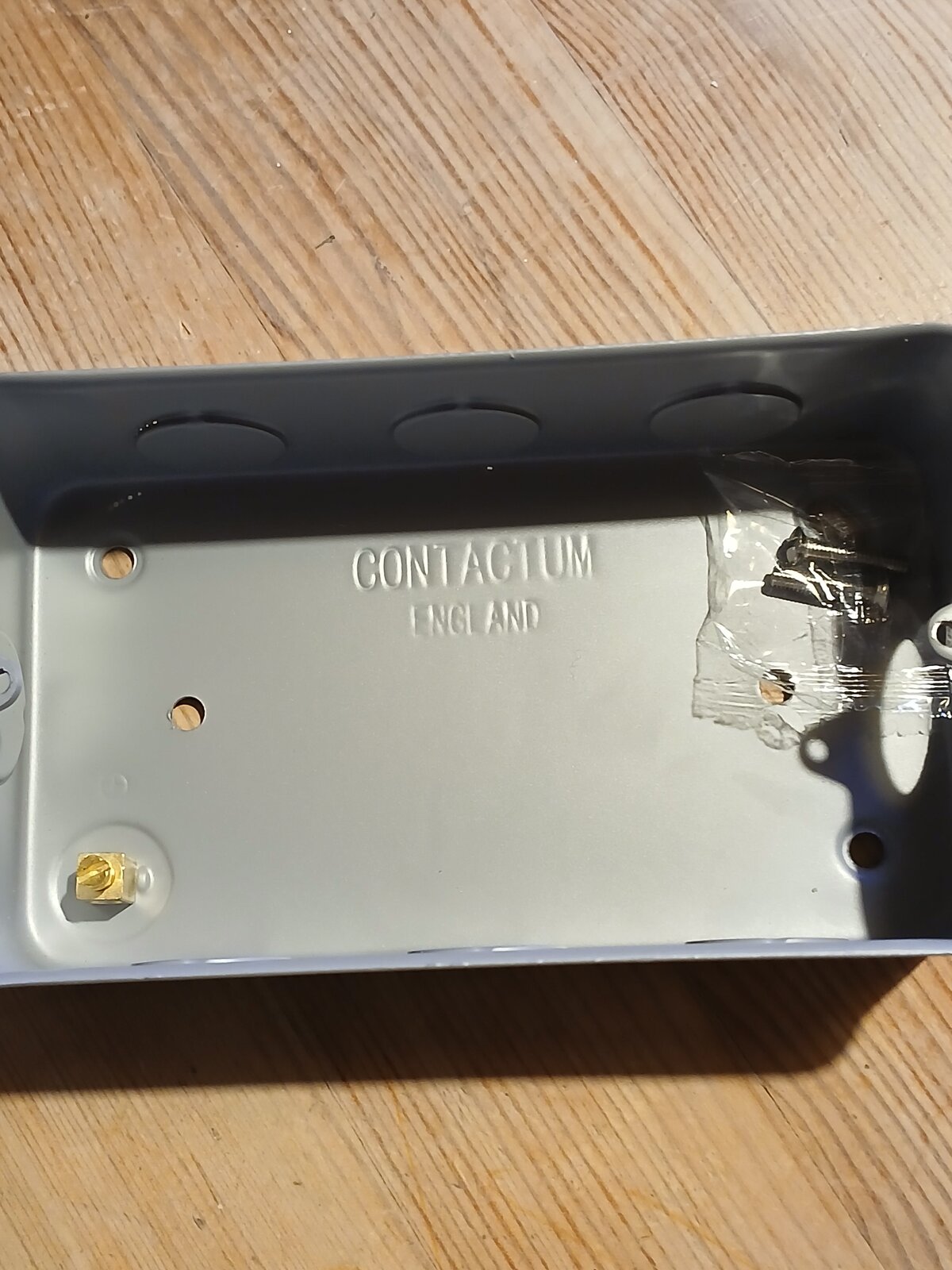

Just connection the socket up normally. Yes, it makes sense to connect that spare earth terminal upto the backbox (as you have metal clad sockets)

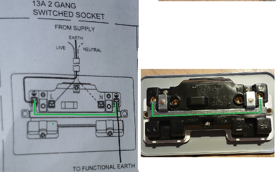

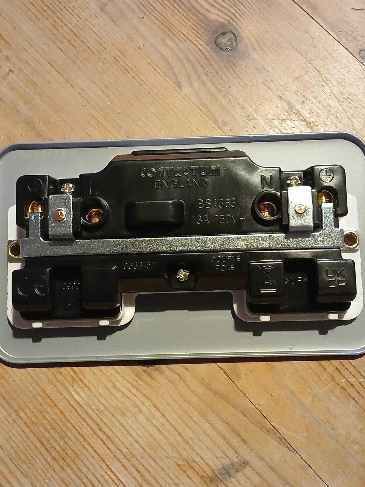

So would this be the gist of it? Sorry for the entry-level questions, just conscious this is an area where you don't want to mess around.
Yes, but it is nothing to do with what is called a functional earth.

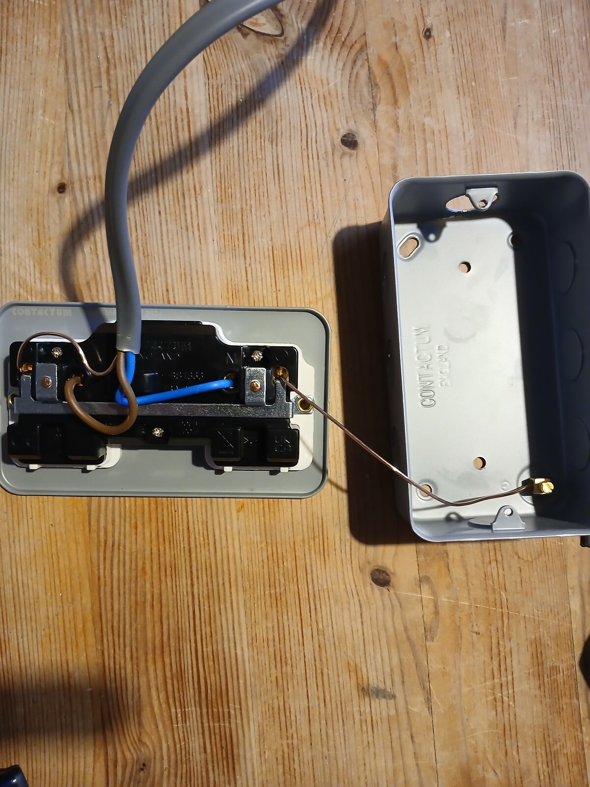

The bare wires should be sleeved with green and yellow.
Great, thank you. The cable's 2.5mm but Screwfix doesn't seem to have green/yellow sleeving in that diameter in quantities of less than 100m. Is it ok to use a larger diameter sleeve, since I can get that in smaller lengths?
the cpc - earth wire in 2.5mm twin and earth - is 1.5mm
on a ring/spur/radial - I would often sleeve both wires with one bit , and so use larger sleeving

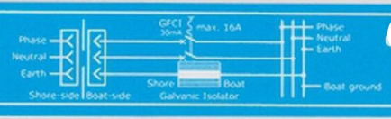

I am sure when I did my RAE this was covered, but this was some 40 years ago. If I needed to fit a functional earth today, I would need to do some heavy reading. There are some odd systems, I seem to remember diodes in the earth as galvanic protection,
it seems wrong to rely on the current through a diode to earth bond, but it is common with canal boats. The instructions
I will guess more than one diode in the unit, as difference between copper and iron is more than 0.5 volt. Also in salt water the hull would be a good earth anyway, although not so much in fresh water.

Doesn’t matter what size sleeving you use.
Can get off eBay if u don’t want 100m!
Best to go a little bigger

The diagram instructs the installer to connect the FE to one of the two Earth terminals and to connect PE to the other Earth terminal.
The picture shows a solid metal link between those Earth terminals
PE and FE should never be connected together,
