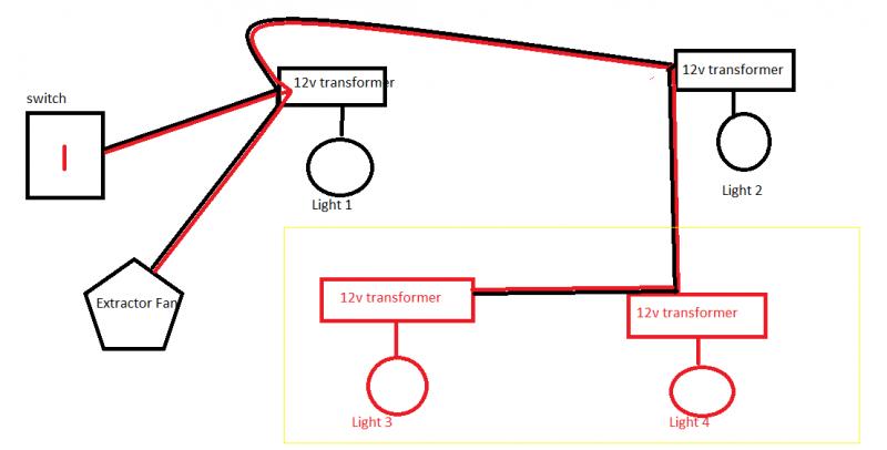

Hi all,
I have recently added two new 12v 35w halogens into the existing circuit in the bathroom. 1 of the new lights went off after about 30mins. I have replaced the transformer and the same thing happened.
My diagram (sorry it isn't great!) shows what I have done. The bit in the yellow box is what I added. Everything else was there already and working fine. I know it may look like I have joined lives to neutrals but that's just my poor drawing skills, all lives are joined to lives and neutrals to neutrals. There is no earth connection.
I believe the power must be coming from the switch, so these are all kind of like a chain of spurs. My entire light circuit is like this.
Any idea what is wrong?
Everything you show seems fine but this is a UK forum and we likely do things a little different here. There is a Non UK section maybe the Sysops will move this post?

The transformers came with the lights so they are correctly rated, I'm just trying to figure out if I've done something that is causing the final transformer to fail. Could it be too many lights (and extractor fan) on one switch?

We don't know where the supply is coming from, and your sketch does not show us.

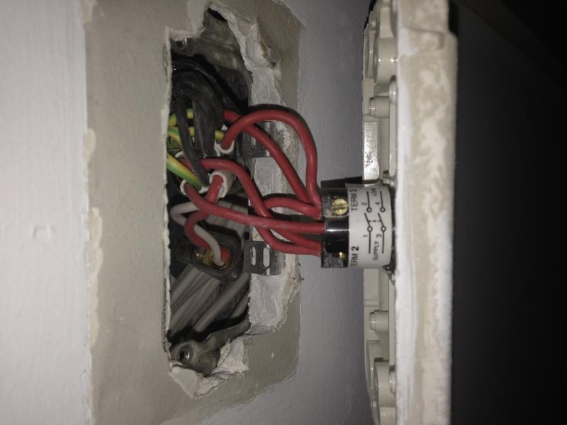

It might be interesting to see behind the light switch. Have you got a multimeter? If not, go to a hardware store and buy one.

Sure the tranny is correctly loaded? Can you post a piccy of one?
