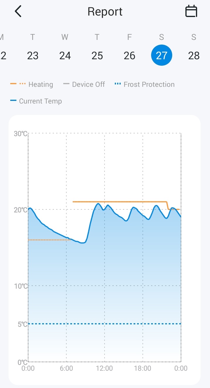

I really can't see the point of changing, I made the same mistake, I fitted Nest Gen 3 under the impression it would link to my TRV heads, but found out it did link but it did not accept demands for heat from the TRV heads so it was rather useless.

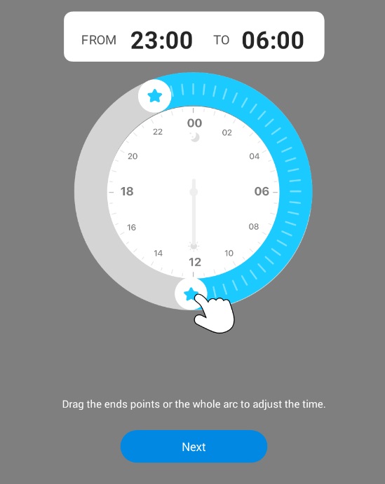

It may work if you carefully set the TRV heads, the idea is the TRV head sets the room temperature to below the point when the wall thermostat will turn off, so when we get a warm day, the boiler will then shut off and it stops the boiler cycling. The TRV heads connect to phone, so we get a report Report full day.jpgshowing how it has done, and we can set when each room is heated, in my case only 4 of the 9 electronic TRV heads are wifi connected, the other 5 bluetooth only. Times are set on the TRV Tapo-TRV5.jpg all the wall thermostat does is turn off boiler on a warm day.
