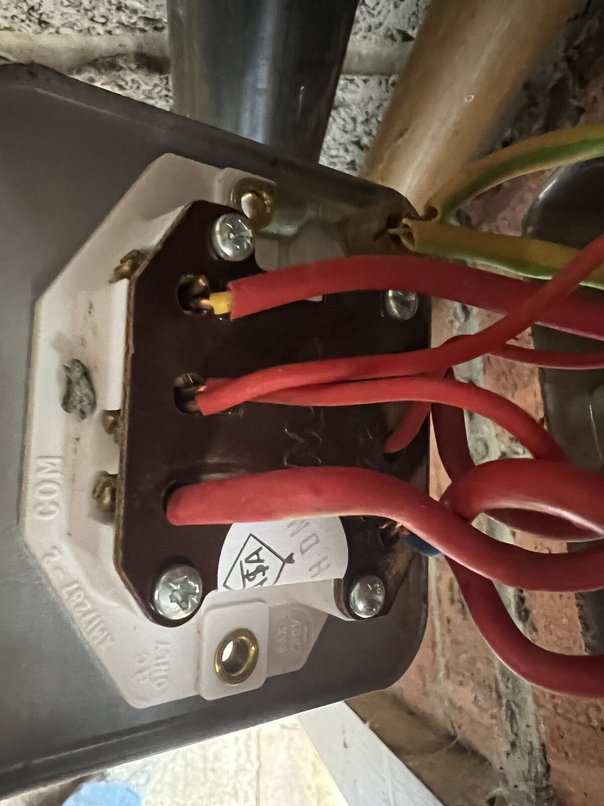

Wiring up 2 way light switch
14 Feb 2016
42

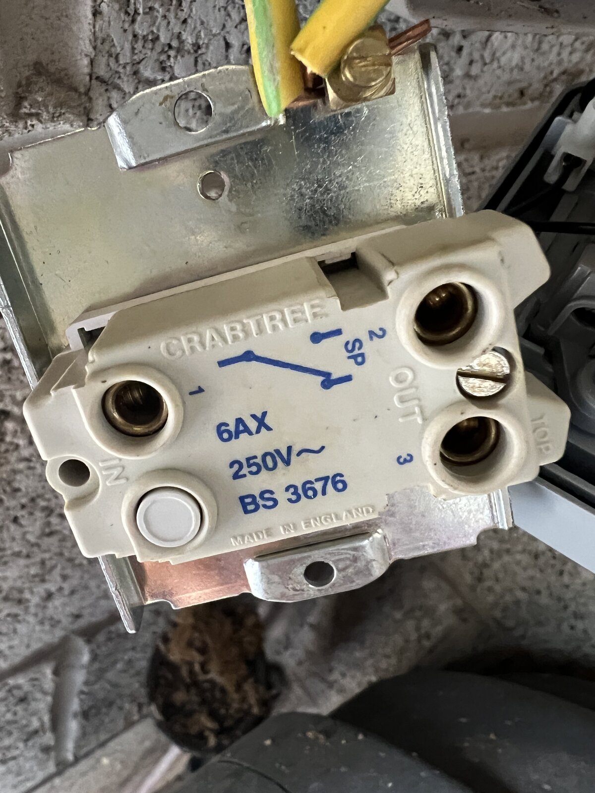

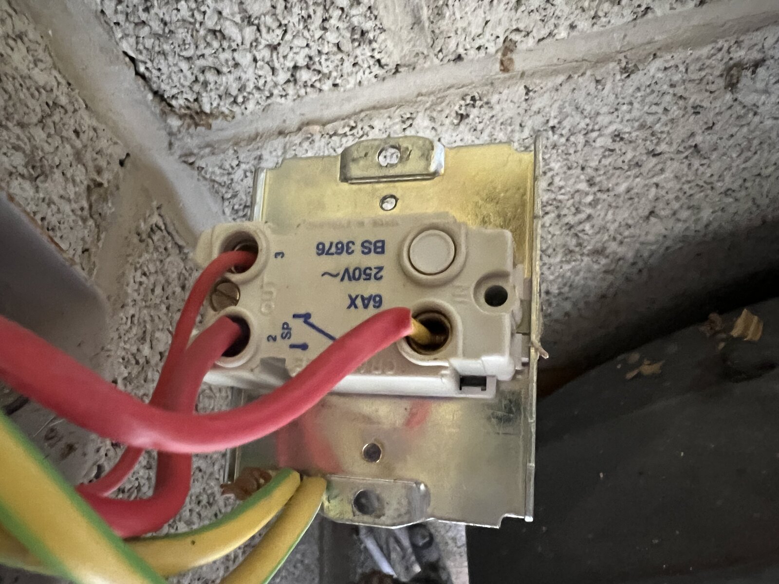

Just swapping for a waterproof switch it’s a two way in the garage,old wiring not marked up three reds 2x2.5 and a 1mm or 1.5.
To the old switch marked 1,2 and 3 the 1mm or 1.5mm was in terminal 3,one 2.5mm was in 2 and the other in 1,both lower terminals marked out and top one in.

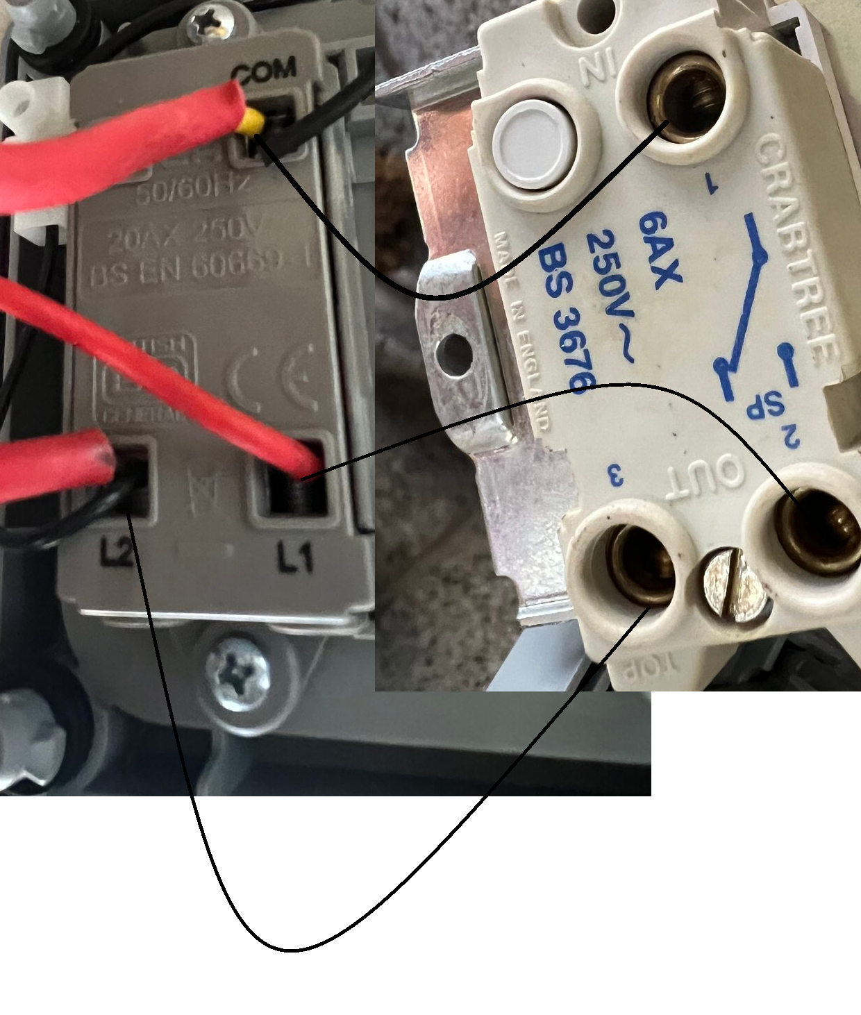

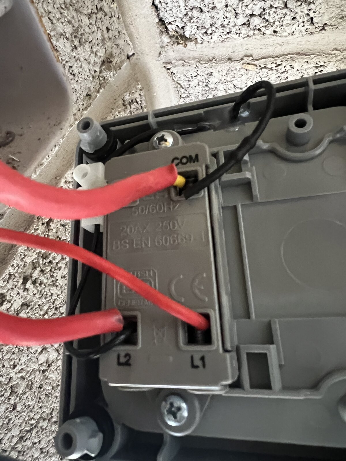

New one has common ,L1 and L2 as shown.
The one 1mm or 1.5mm is live permanently which the new switch says to put in L1 ?
Switched live load to L2 and common to common between the switches.
What’s the best way to find the switched live load?.
Ble black lines indicate the equivalent terminals.

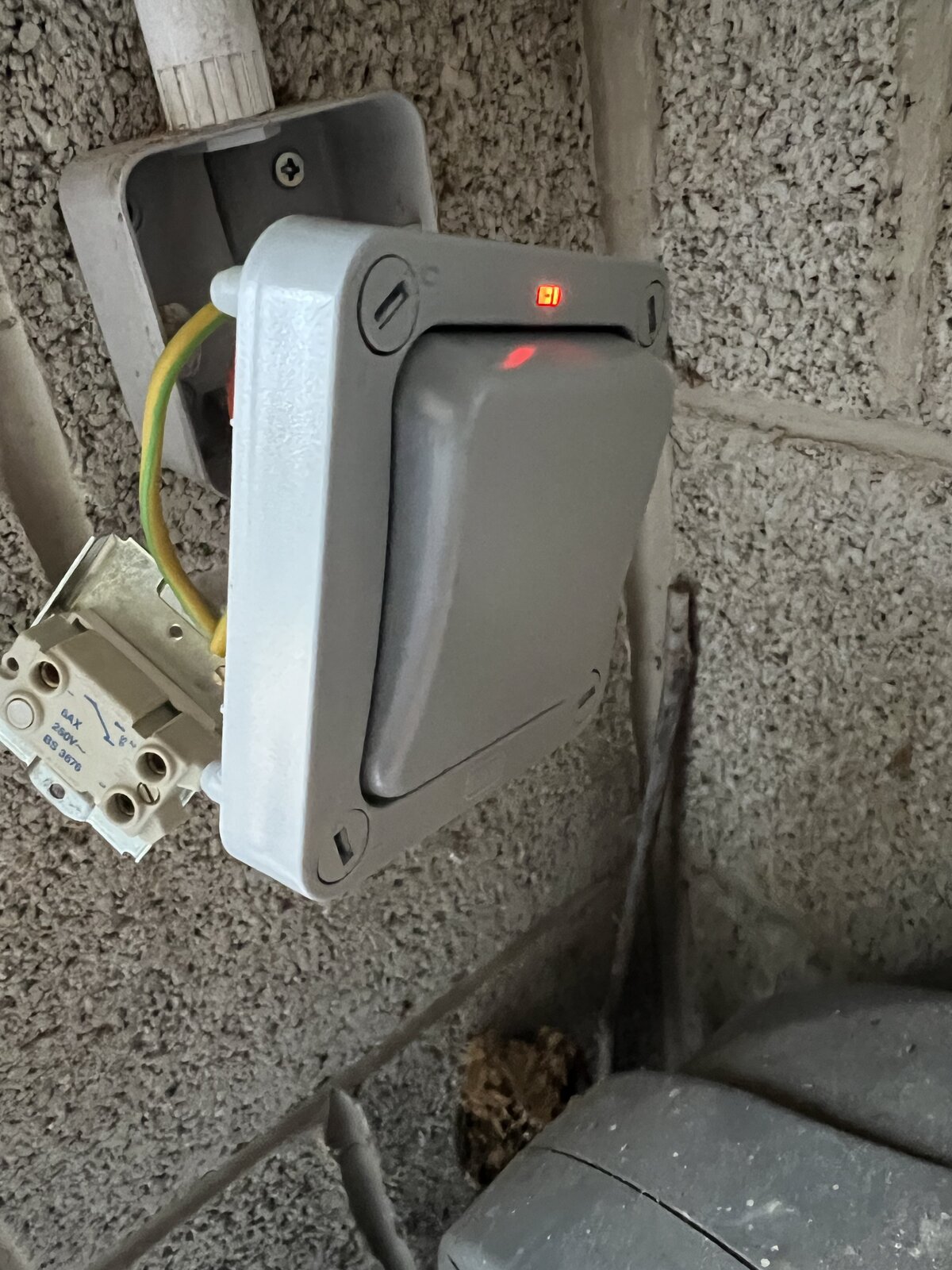

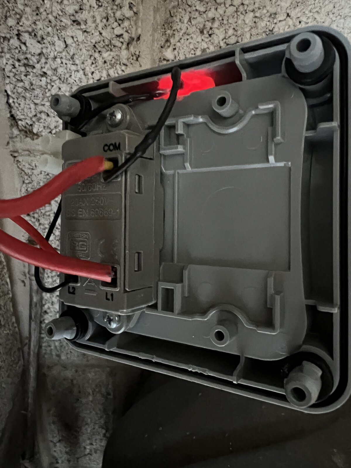

Can the neon light be disconnected as it’s showing red when light are off but switch is on
The lights are switching on and off at both switches,should there be 240 on all terminals when this one is off and the other has been switched on?.
Was yellow connected to common on the old switch? ANSWER THIS FIRST.
I would say on YOUR 2 way switching set-up, you have COM at the top, and the bottom terminals consist of switch live and permanent live. Logic may suggest red is permanent live, and blue is switched live, and yellow is common.

This was the original wiring,the one with the yellow on was in terminal 1 marked IN.
The 1mm cable is permanently live.

Ok. The yellow is in the correct terminal.
To clarify, it's all 1.0mm2 T+E wiring, The red sleeves over the yellow and blue make it appear larger wiring, but it isn't.
So red is perm live, blue is switched live.
There should never be a case where all three terminals are live at the same time, so I suspect the neon light wires are in the wrong terminals.
If you don't need the neon, easier just to disconnect it.
Does the switching not work correctly with the neon wires connected?

If the light has been switched on at the other switch the neon lights up on this one as pictured above.
From what you are saying the yellow common is correct and the switched live should be in L2 with the red in L1.
Again Thanks
On 2 way switches, it makes no difference if L1 and L2 are swapped around - it just means one of the switches will appear to work 'the other way up' than it did before. Getting the correct wire in the common terminal is the important factor, and you have done that correctly.
Does everything work satisfactorily, with the possible exception of the neon?
Everything works as it should,can be switched on and off at either end,the neon just connects between L2 and common,I’ll disconnect this as it can be confusing.

If you connect the neon to L1 and L2 it will be lit when the light is off which could be handy if the swtch may be in a dark place.

Still having the 240v on all terminals when the switch is on,lights on at this end,when switch is off I have 240 on the common and L1.
Switch at the other end is exactly the same when lights are on at that end 240v on all three terminals,switch off and 240v on common and live,nothing on switched live.
Is that correct?
Thinking about it all three must be live at the switch at one point,permanent live will send 240 to common terminal and when light switched on switched live will put 240 to common and both will have 240 on plus permanent live will be live also ?
