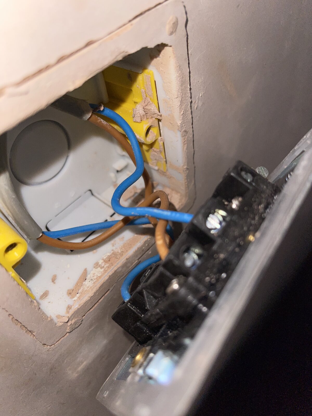

Hi there. I redone my bathroom and I wanted to know whether or not this is correctly wired? This switch is a double switch, one for the lights in the bathroom and one for the cooling fan. Isn’t there meant to be an earth wire!?!?! Also the cooler fan has stopped working for some weird reason. I have checked the terminals and they all tight, still doesn’t work.
The Earth wires in the cables need to be connected together and if that switch has a metallic front plate then that front plate must be earthed.
That is essential for the safety of anyone who touches that switch. ( humidity is a bath room can result in the back of the switch becoming damp )
Ok thats fine. It is a metallic switch. It hasn’t been earthed and there is a slot for the earth wire. The switch socket is outside of the bathroom, not inside. Also do you know why the cooling fan has stopped working? It doesn’t switch on, the terminals are tight and I have also made sure the actual fan is on by pulling the string, still doesn’t turn on!
Either the fan has failed,the switch has failed,or the wiring to the fan isn't intact. Testing for voltages present at each point would indicate which. If the fan has a transformer supplying it ,that's another possibility. What fan is it, make / model ?
Your earthing needs immediate attention.
