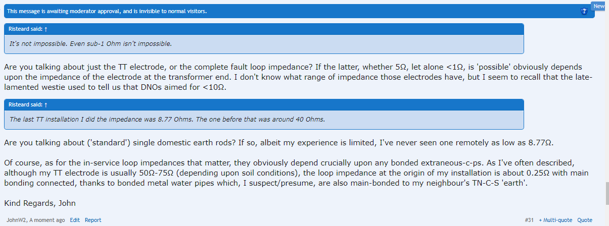

It's not impossible. Even sub-1 Ohm isn't impossible.
Are you talking about just the TT electrode, or the complete fault loop impedance? If the latter, whether 5Ω, let alone <1Ω, is 'possible' obviously depends upon the impedance of the electrode at the transformer end. I don't know what range of impedance those electrodes have, but I seem to recall that the late-lamented westie used to tell us that DNOs aimed for <10Ω.
The last TT installation I did the impedance was 8.77 Ohms. The one before that was around 40 Ohms.
Are you talking about ('standard') single domestic earth rods? If so, albeit my experience is limited, I've never seen one remotely as low as 8.77Ω.
Of course, as for the in-service loop impedances that matter, they obviously depend crucially upon any bonded extraneous-c-ps. As I've often described, although my TT electrode is usually 50Ω-75Ω (depending upon soil conditions), the loop impedance at the origin of my installation is about 0.25Ω with main bonding connected, thanks to bonded metal water pipes which, I suspect/presume, are also main-bonded to my neighbour's TN-C-S 'earth'.
Kind Regards, John
