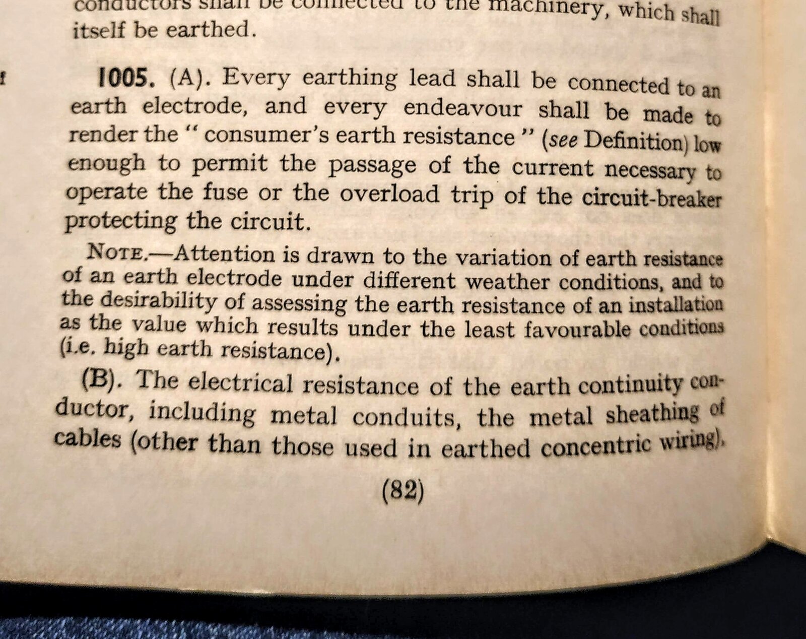

Earth electrodes have been required since at least 1939 (11th edition), with the intention that a fault creates enough current to operate fuses or circuit breakers.

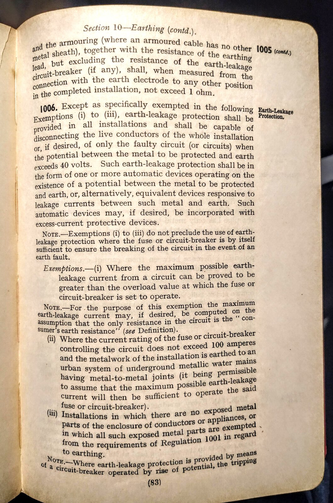

In the same edition, earth leakage protection is required unless certain conditions are met, one of which being earthing via 'an urban system of underground metallic water mains having metal to metal joints'.
. Interesting - but I can't help thinking that the "every endeavour" was rather by way of 'wishful thinking' :-)
Fascinating As I've said, even decades later I virtually never saw VOELCBs. The first, and only, one I ever 'owned' was the one I inherited here in 1987.
