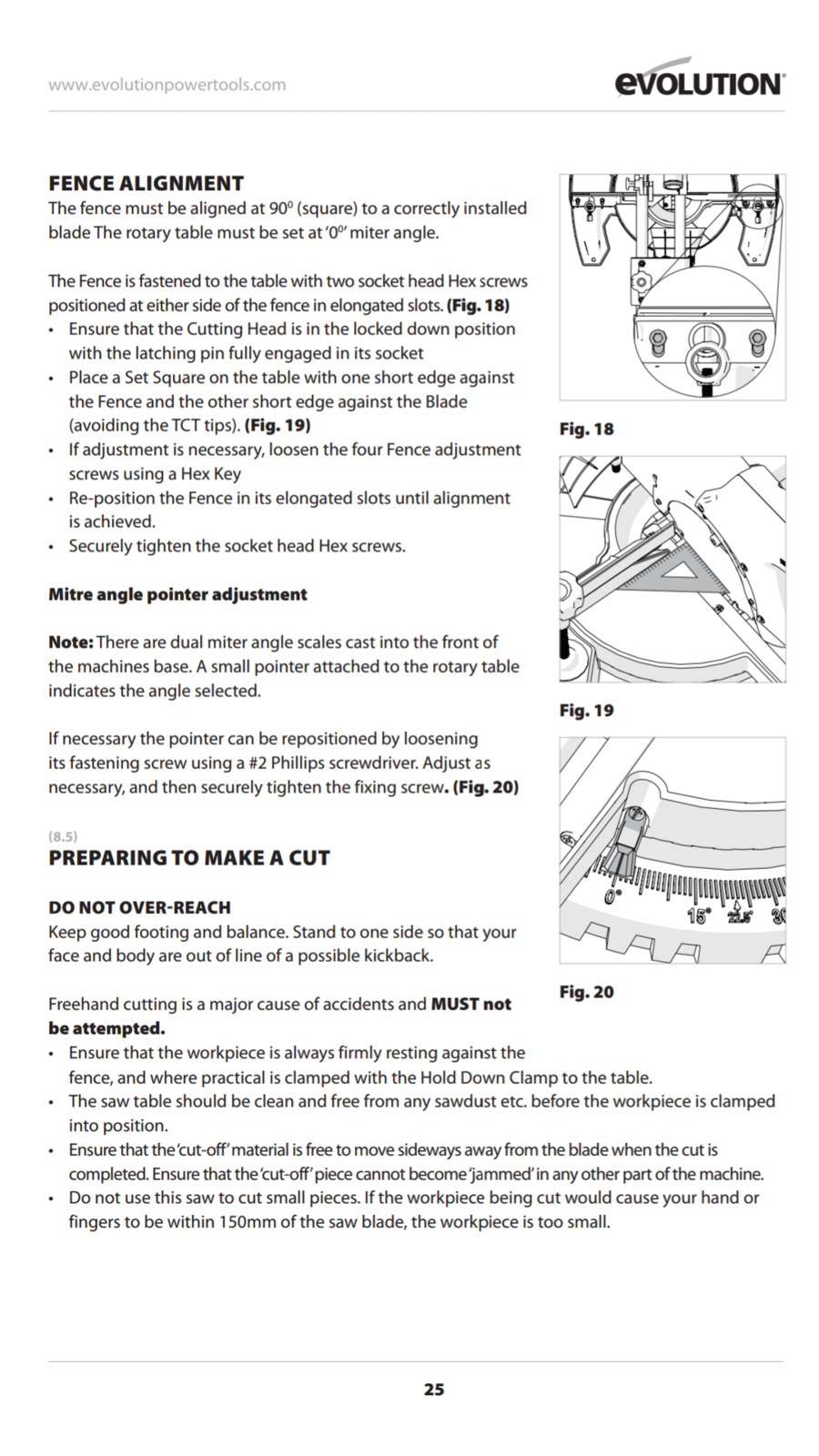

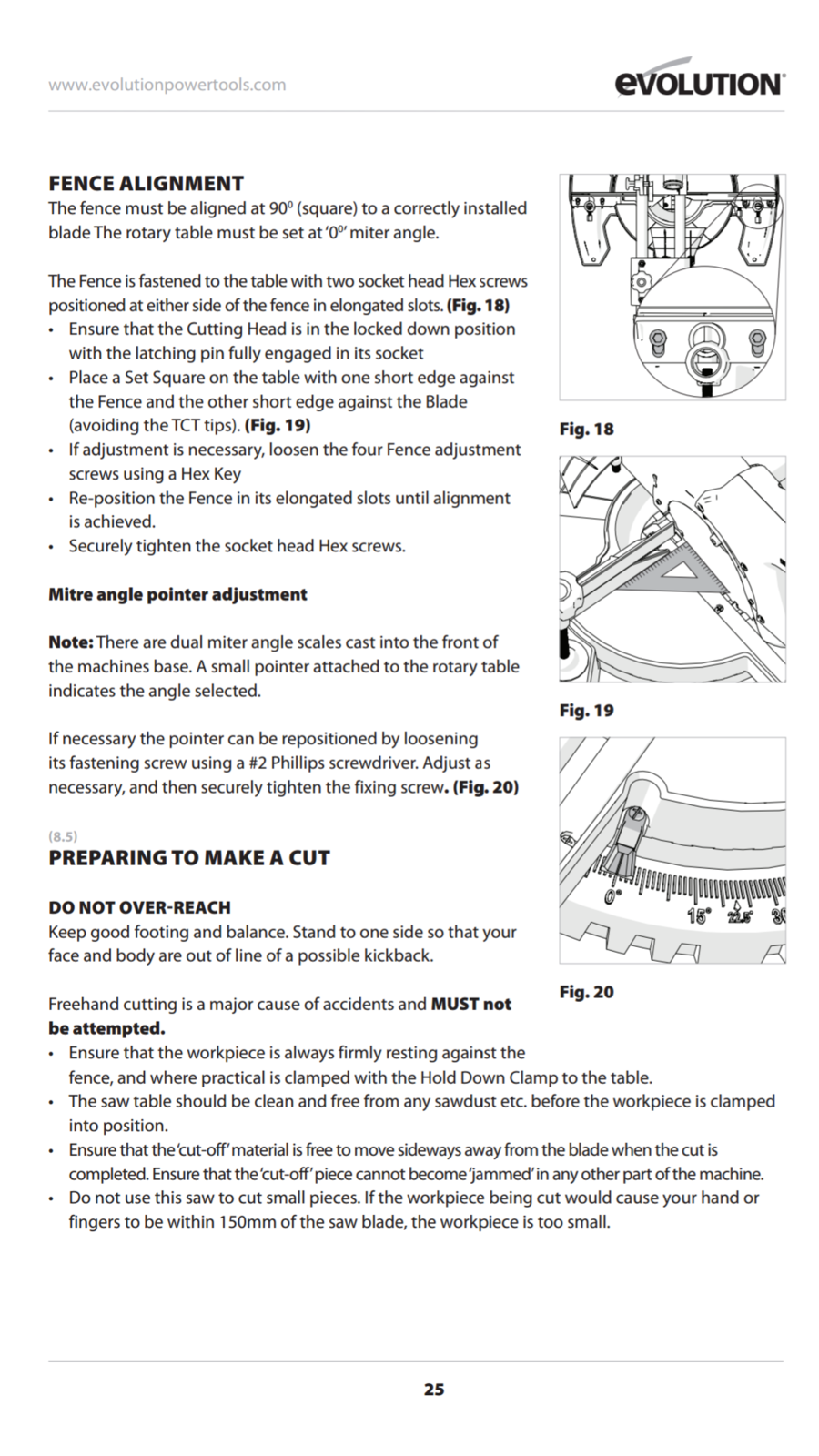

You haven't mentioned which model it is, but do the guide rails at the back have bolts; if they do, then one of them isn't tight enough. Shop bought squares may not be perfect, but you cut a piece of wood, check which way it's out, and then undo the bolts a little, and tap the guide rail till little, tighten the bolts, then make another cut and check it. And you eep repeating the process till you get it as accurate as possible.
Had a quick look at the manual. Looks like the adjustment is set by moving the fence so I'd start there.
A good tool to get which I use for quick adjustment is the trend digital angle finder.
