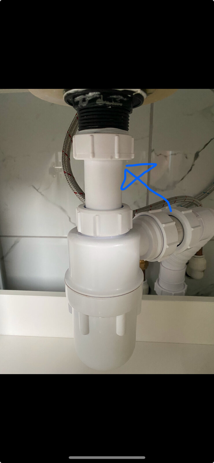

Hey all
I’ve just fitted a new basin and the thread on the waste is leaking. It’s coming out underneath the nut that the trap is screwing on to. It’s a mcalpine trap so I don’t think it’s that. However, when I screw the trap on. It doesn’t go tight it just keeps turning. I tried some ptfe but that hasn’t helped. It was a cheap waste so I’m assuming that may be the problem.
Any tips on how to solve? I don’t think it’s leaking between the waste and the sink. Just the waste and the trap.
Any advice would be appreciated.
Cheers

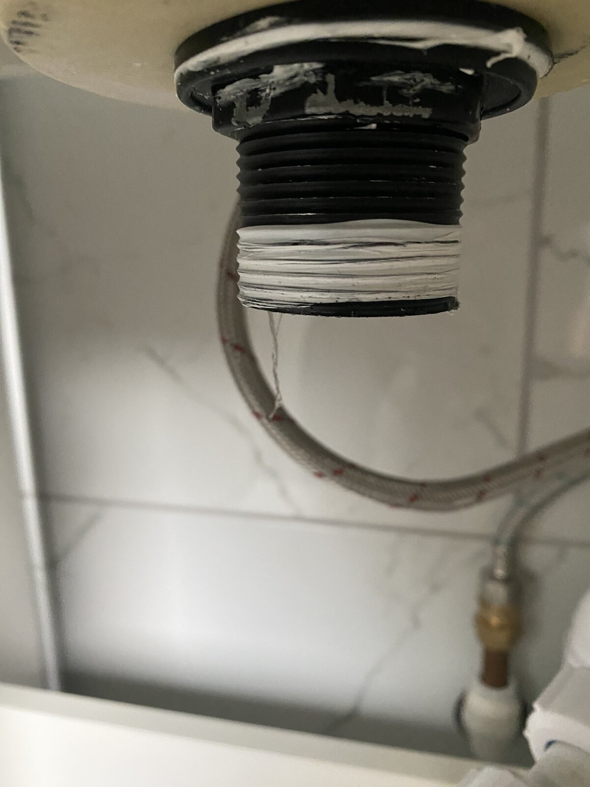

It’s almost like the thread is too small for the trap. You can wobble it off. But should both be 40mm. The leak is coming under the nut where the blue arrow is pointing. Everything above it appears dry so I’m assuming it’s the looseness of the connection.
All the parts are brand new. Wouldn’t expect the trap to be at fault being mcalpine.

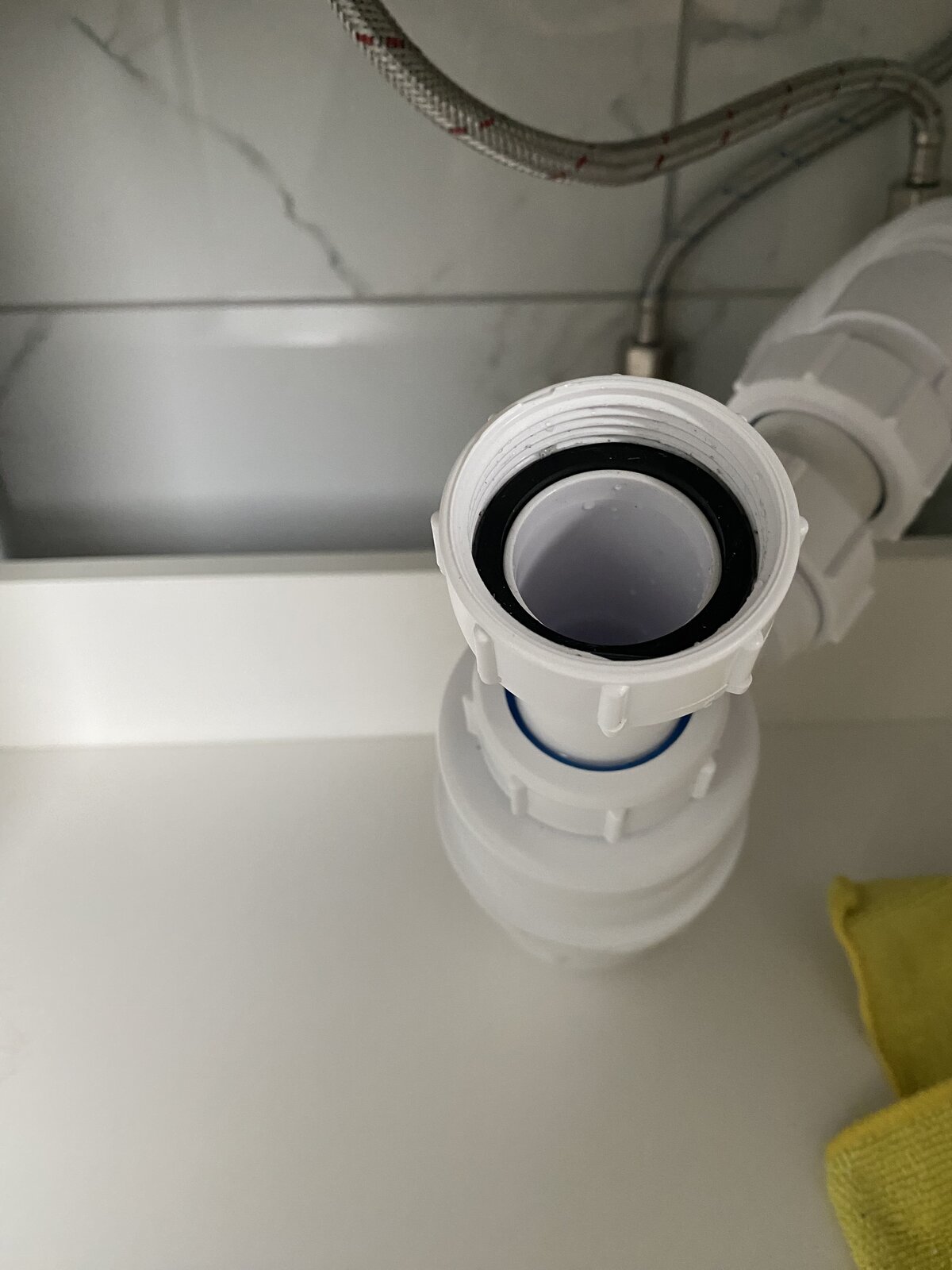

Clean under the rubber seal.
I think you have a bit of compatibility problems.
If you have a McAlpine trap buy a McAlpine waste.
As above its acompatabiliy, you could probably bodge it with tape or sealant
Could it be a euro waste and a uk trap lads?

Yeah think you’re all right. Just got a mcalpine waste and it’s fitting much better. Annoyingly it’s not Matt black on the top like everything else in the bathroom. So might try ordering a different one off Amazon and see if that works better than the one I’ve got.

You shouldnt need PTFE tape on the waste thread when the nut feels tight when all put together, the rubber seal is the sealing face not the thread.
You could leave the black waste there are buy a EU-UK thread converter,
