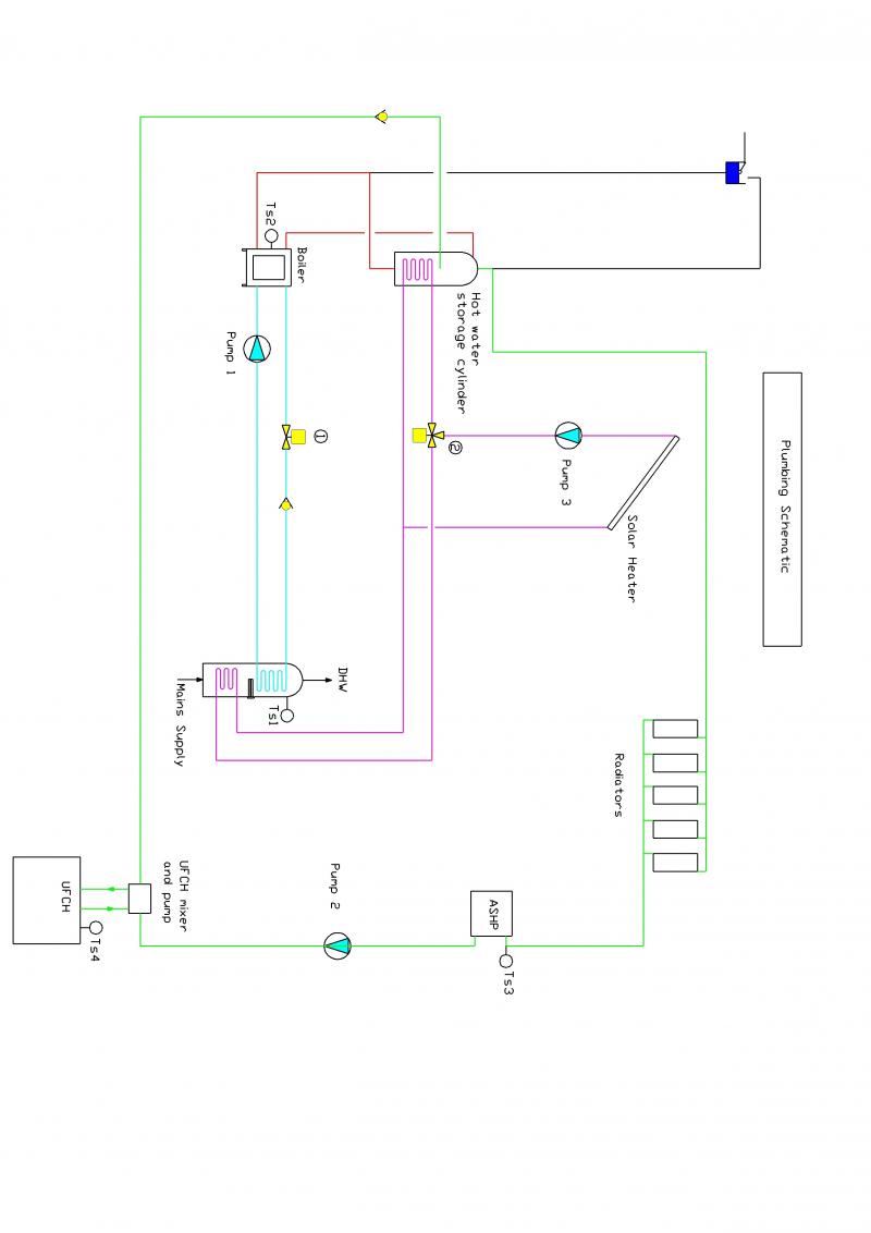

Hi, sorry I'm new to the site and only seen the topics today. This one very interesting as I am planning something similar and would appreciate any advice or comments.
I've no mains gas and fuel oil is expensive, hence want to rely on renewables (and a heat pump)
Central heating has a 213L vented heat store cylinder with a coil for solar. The WBS will be the main heat source. From the heat store the circuit pumps first thro the rads, then via the underfloor heating and back to the store. The heat pump is between the rads and the ufh so that when the fire is off first call for the heat pump is to the ufh with balance to the store. The rads will get a little warm until the fire is lit or the sun comes out. When the water in the circuit reaches 45 or 50C the heat pump will cycle off (so i'm told). The solar circuit will prioritise DHW then when this is 60C it will route to the heat store.
The DHW (unvented twin coil cyl)also has a pumped loop through a coil from the WBS. Reading all the comments I am now more confident that I have sufficient security if when the DHW reaches 60C, the circ pump will stop and the spring return valve will close. I was thinking about another safety angle to tee off another valve (power to close, power off open) which would vent the water from the WBS in event of a power failure, it would be replaced by cold water from the header tank. Would this be an overkill? Is my plan to route return from the rads into the underfloor heating circuit ok? (rather than a separate pumped system)[/img]
Strange; have you employed someone to design this for you?
The UFH will only work when the radiators are on. You'd usually want the UFH to be able to run when the rads are off, due to its high thermal capacity and long warm-up times. The intention seems to be to use the CH return to supply reduced flow temperature for the UFH. I'd suggest a TMV or a motorized mixing valve.
Similarly does the ASHP only run when the rads are on? What happens when there's no demand for heat and the TRVs have shut? A separate circuit would be better.
There will be no circulation between the thermal store and DHW cylinder without a pump, unless the solar pump is supposed to do that; circulating hot water through the solar panels on dark winter nights is not a good idea.

OK, I can provide a separate pumped circuit from the heat store. This will mean the WBS will dissipate heat only by convection, will this be OK?

What I've done is to simulate all the conditions with the actual valves and thermostats on my kitchen table. I connected them according to the Honeywell sundial wiring diagrams which I found on the net, they are very informative. I powered everything up (very carefully) to make sure the valves were opening and closing at the right settings.
[Onetap: Strange; have you employed someone to design this for you?]
No, onetap, can't afford that. I did it myself, I've learned a bit of AutoCad in my employment.
[Onetap: The UFH will only work when the radiators are on. You'd usually want the UFH to be able to run when the rads are off]
Good point, I've made a change and will fit a three-way valve before the rads. This can bypass them and direct water around the heat pump and uf heating when the storage cylinder water is less than say 60C. Above that the valve will direct hot water as originally piped. I'll have two of the bathroom rads with no TRVs just to be safe
[Onetap: There will be no circulation between the thermal store and DHW cylinder without a pump, unless the solar pump is supposed to do that; circulating hot water through the solar panels on dark winter nights is not a good idea.]
I hadn't planned for circulation between the thermal store and DHW cylinder. The solar circuit is intended to pump as priority (with its own pump) to the DHW cylinder, at which time the loop into the thermal store will be effectively a dead leg. When the DHW temp reaches 60C, the solar flow will change over to the thermal store and there will be no flow through the DHW coil. There is a cut out on the solar unit to prevent it pumping when it is not developing heat.

I'm a little confused by this. I thought that my vented 213L storage cylinder with all my input and output connections would actually be a thermal store (sort of).
