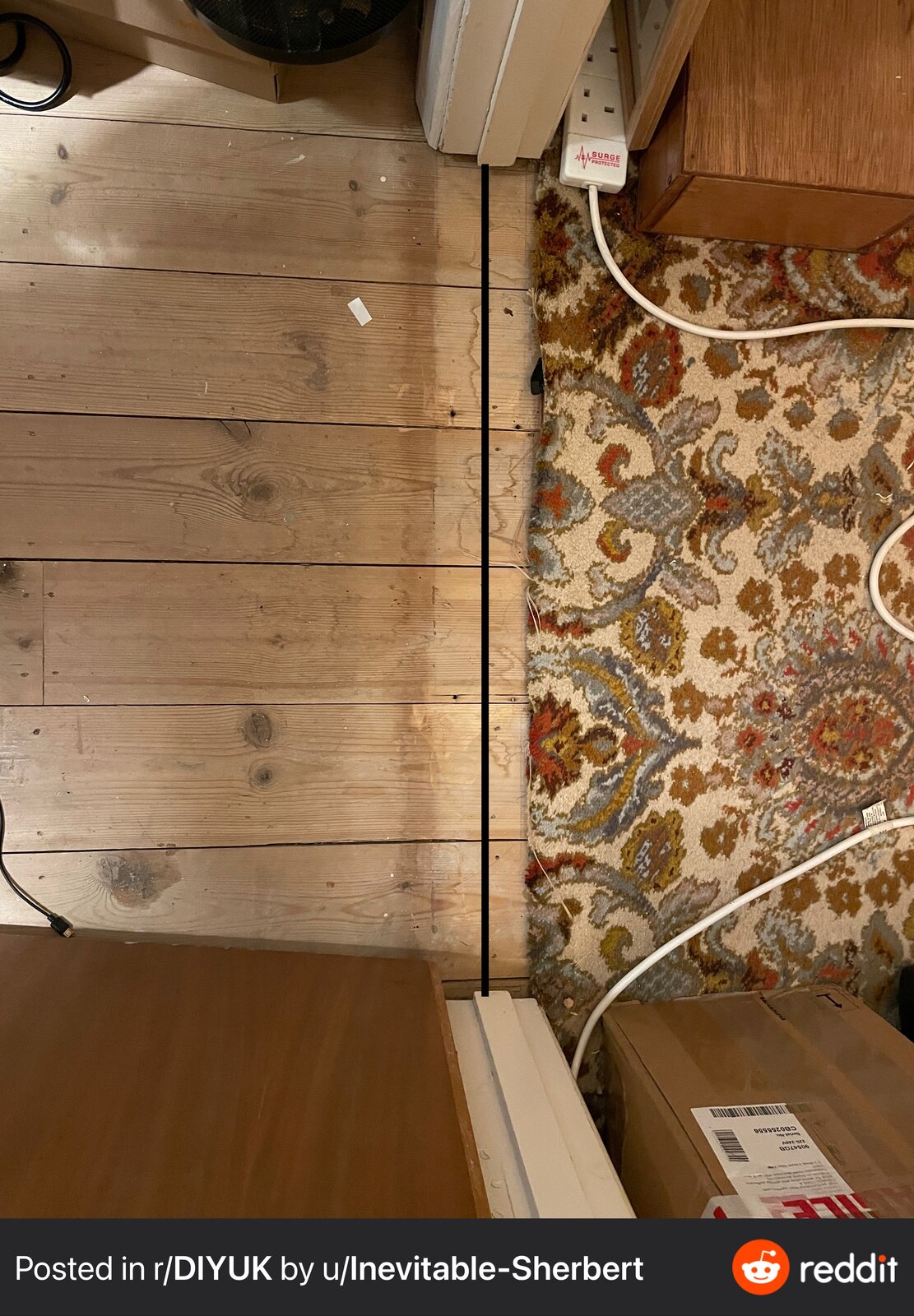

There's all sorts of useful info on laying wood floors and fitting around architraves, going through door ways etc, but not when you have a doorway that will have a different surface on the other side.
I'll be laying planks 90 degrees to the original floor boards. Am I best off starting at the opposite wall and ending up possibly having to cut down the plank width to get it to fit the doorway as I want (to the black line) or start at the door way with a full plank and then cut the entire first row to fit?
Long term a new carpet will be fitted (with threshold) where the current old, old carpet is.
Or any other ideas?
I would measure the distance to see if you'll have a slim cut either end
Then start from the door so there is as big a piece as possible there as that will take the most impact.
The black line you have drawn should be a bit further into the room so the closed door will cover the join.
I always start in corner of room and work back to doorways.You need to measure carefully to avoid any thin sections at opposite wall .
