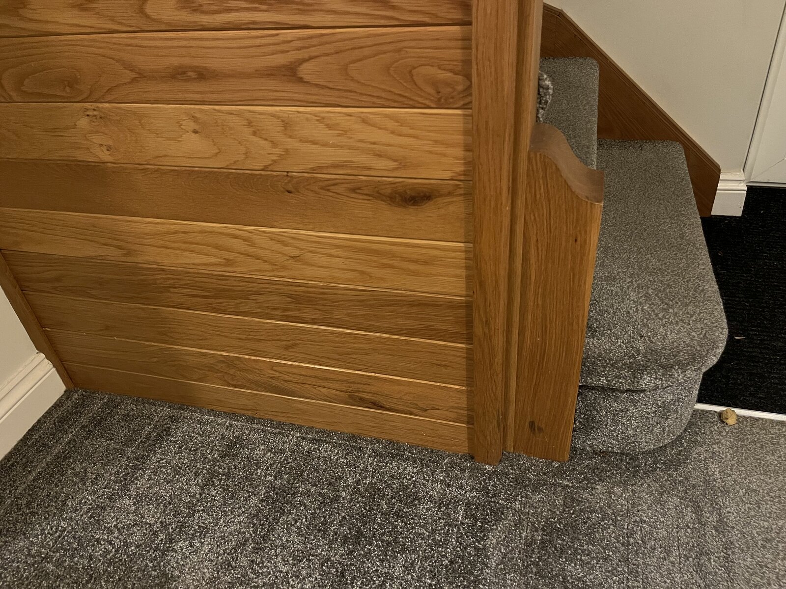

Hello.
Looking to replace grey carpet in hall - I will be keeping black entrance island due to door clearance - see two attached photos.
I will be removing skirting and undercutting jambs.
BUT not sure how I deal with the section under and bottom stair curve...advice please !
Thanks.
Phil
Cut around curve , leave small expansion gap which is hidden under carpet on bottom step .
Expansion gaps can also be filled with cork strip when they are visible. This tends to merge in quite well with most solid timber or engineered flooring
