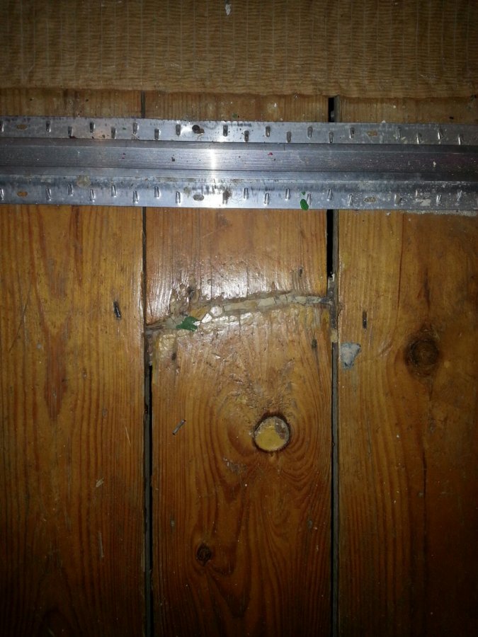

In my parents house, where I've lifted boards countless times with my dad, they've always been like this - just straight up planks which rest on the joists, no overlapping what so ever. The house in question is a 30/40s terraced house. I did have a picture on my phone but it seems to have vanished for some reason!
I've found one of the pictures I snapped near the door...
That's a board we intend to swivel round to get the end under the landing which is better. As you can see, it looks like someone has treated the floor originally anyway.
Yep, its been varnished before. The gaps are big enough to get the slips in - there at least.....looks like someone may have been there with some filler too, unless its just the perils of a tiny screen.
John :)
Yeah someone has varnished it before, I tried sending with 40 grade on an orbital sander and it didn't take much to take it off. Those gaps are fairly representative of the rest I'd say.
Indeed, that filler looks a bit rubbish there, that's a board were hoping to turn around.
