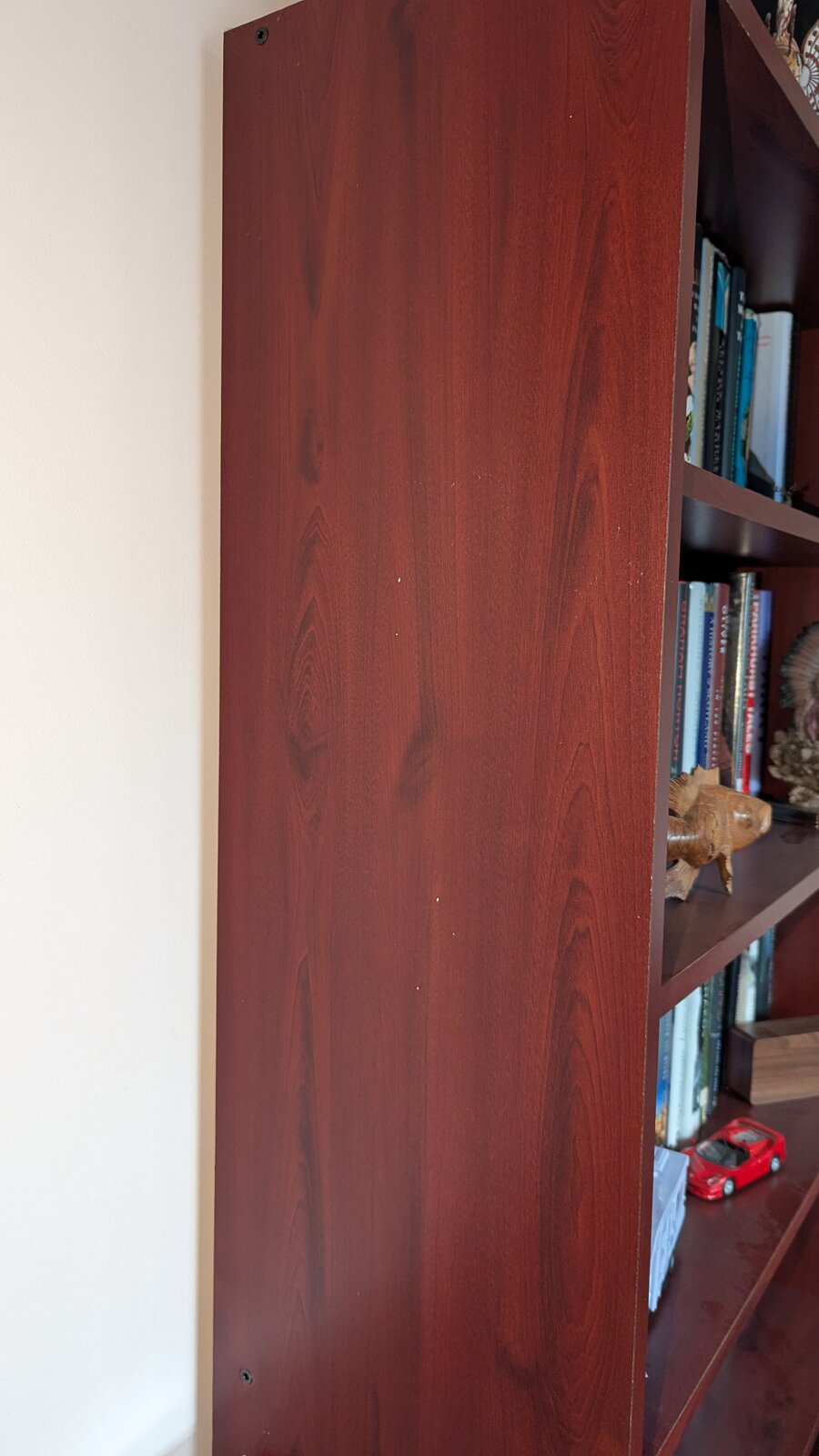

My first post so hello everyone.

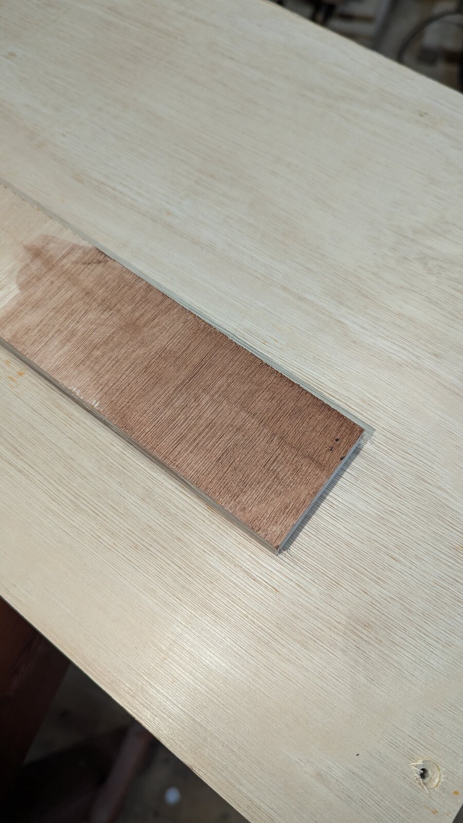

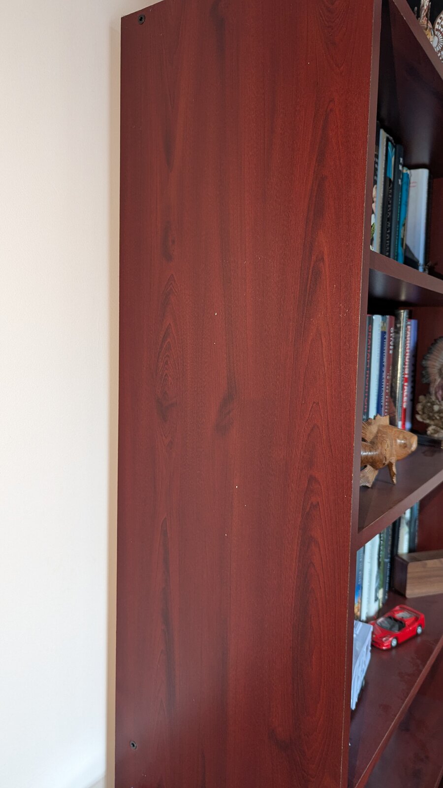

I am trying to match the colour of the rosewood furniture that used to be in vogue but no longer. I have attached a photo of the bookcase I am copying. I have tried Colron wood dyes, Indian Rosewood (the other photo), American walnut, Peruvian mahogany and Dark Jacobean oak, all to no avail. I am staining hardwood ply as shown.
What am I doing wrong? Clearly wood dye is not suitable. Thanks for any advice you can offer.

Peruvian mahogany is red but it has much the same effect. Just not dark enough. Extra coats do nothing. Have contacted Colron and Little fairs.

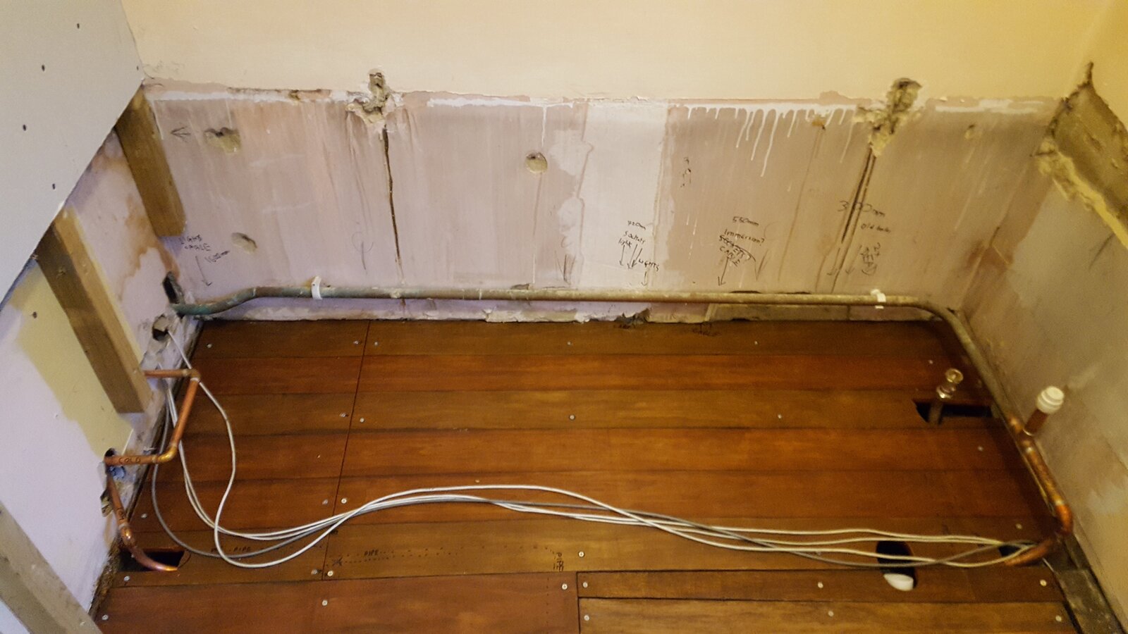

(I have a stained floor, where I used the same dyes, in strips, but one side looks different because the wood was a different batch.)

Repeated coats make little difference to the first coat. As you can see in the photos, the shade is way out.

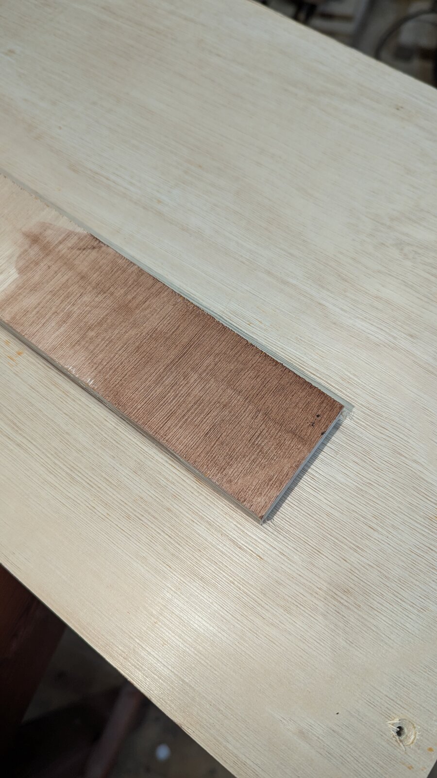

I have used "hardwood faced ply" that has a reddish veneer on one side, and a light veneer on the other. I prefer the reddish side. However it is not very good quality, the face veneer is paper thin, not a hardwood ply like I previously used for boats (much more expensive).
The red face goes to a better colour when it is dyed and varnished.
The hardwood ply I have used is shown in the photo. Both sides were very light.

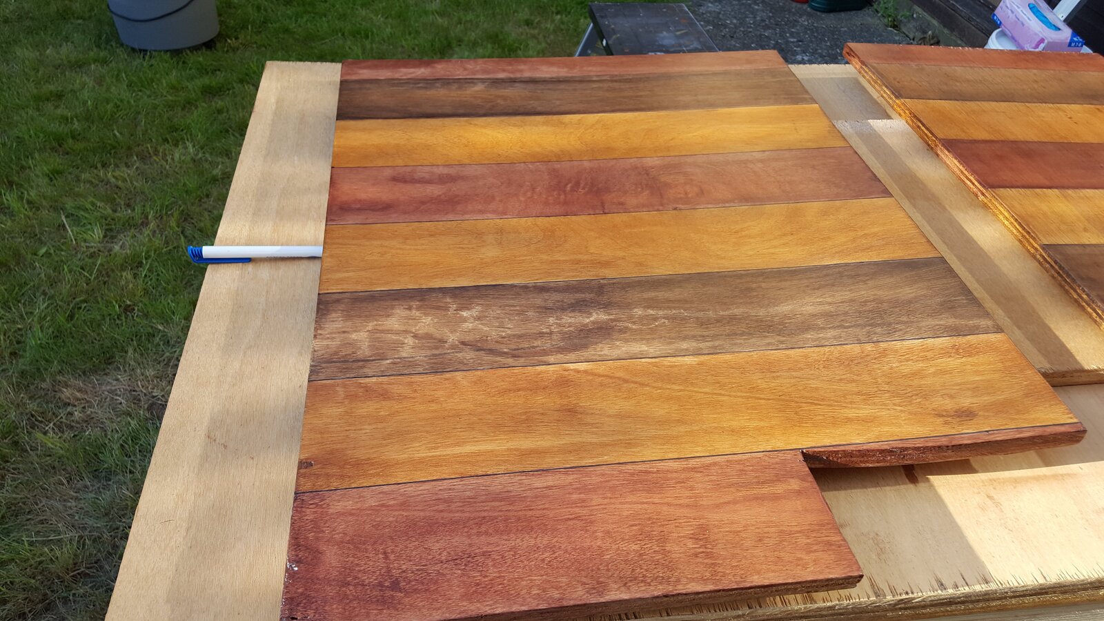

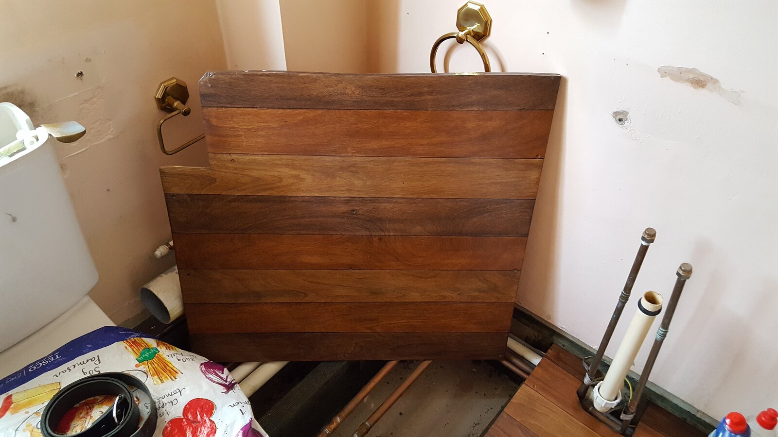

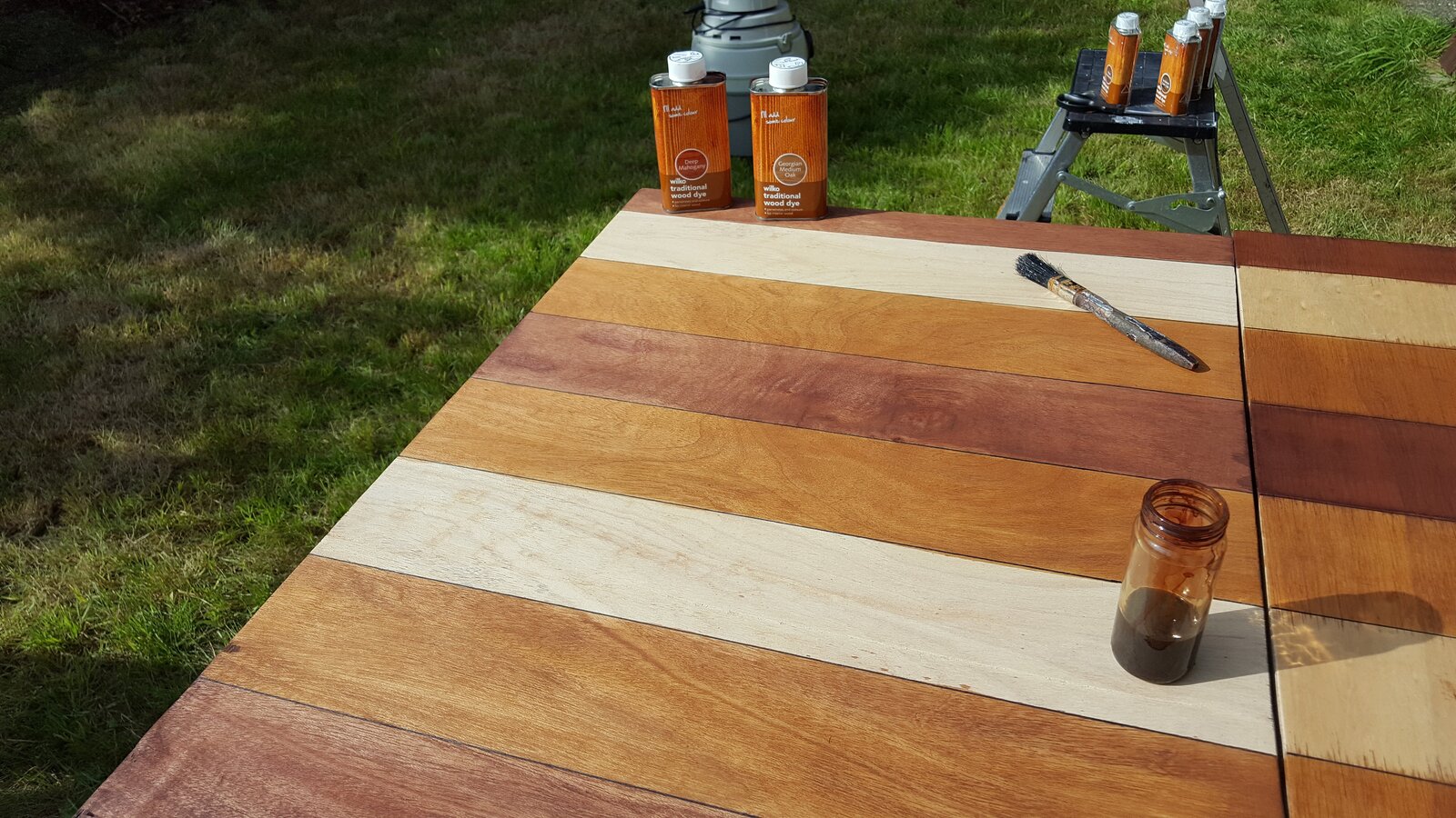

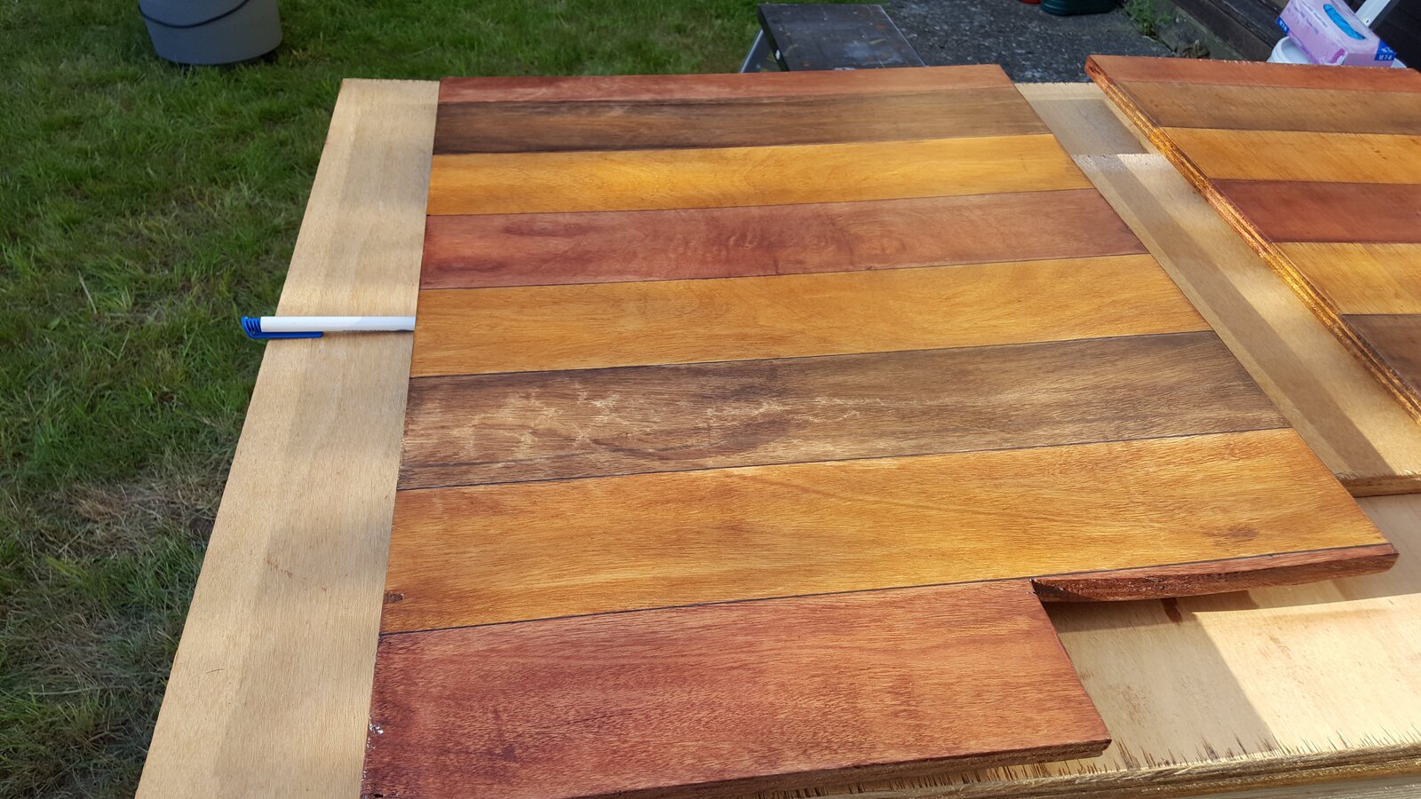

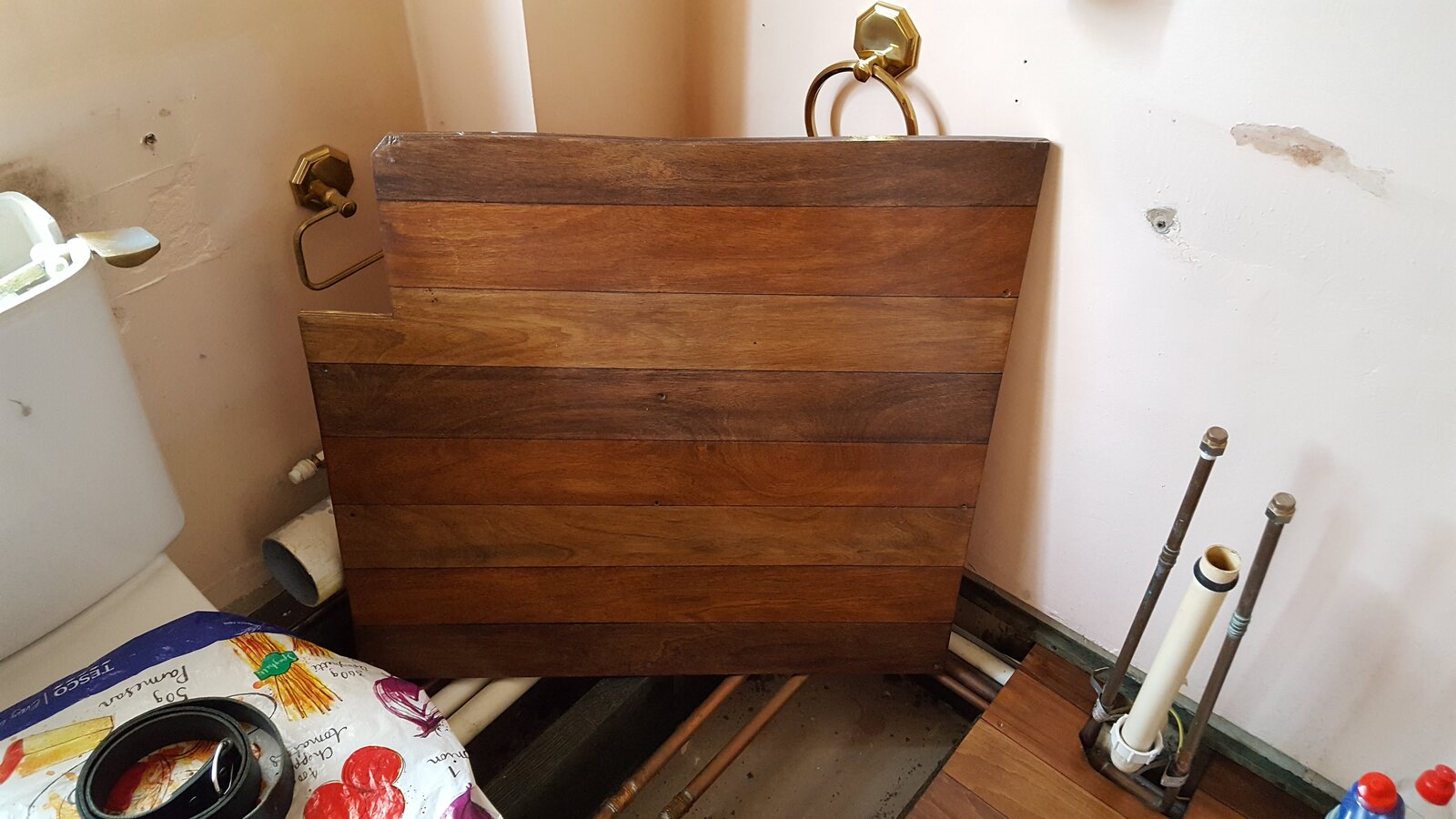

I looked up pics of some samples I made. The mahogany stain was unconvincing on a pale ply.

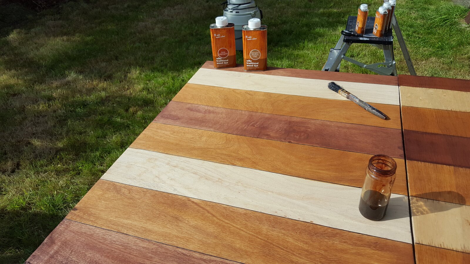

But I used it on some doors made of red tropical hardwood (sold as mahogany, but really some substitute) and the colour was as good as a Victorian sideboard
The brownish colours (including rosewood) came out quite well.
