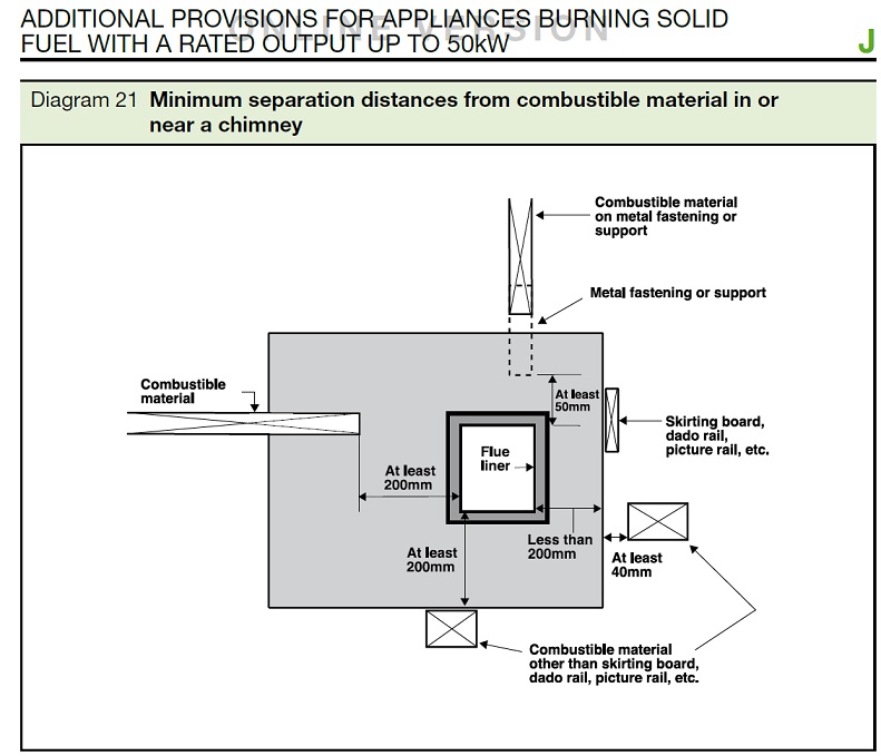

From page 37 of https://www.planningportal.co.uk/in...ombustion_appliances_and_fuel_storage_systems
As you said the regulations do allow for less than 200mm but only if the flue liner manufacturer states that a separation of less than 200 mm will be safe with their product. I very much doubt that a single wall flue liner would be safe with less than 200 mm. I did quite a bit of research on this having just had a flue liner fitted and having to take into account that the cottage has a thatched roof
