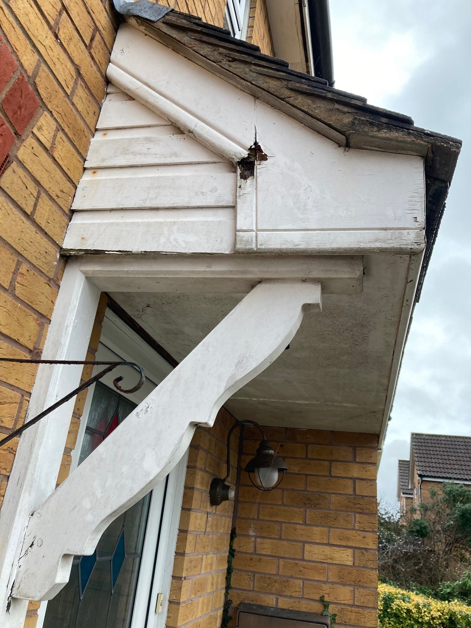

wooden fascia board

Hi all
As shown in the photo, there is a hole in the wooden fascia board. It is at the front door porch. It's been there for some time. Is there any quick fix?
Thanks for your advice.

Scrape out all soft wood, clear off paint about 50mm past this, brush on some wood hardener to the bare wood and let it dry, then fill with a two part epoxy wood filler ( external grade). Prime and paint.
