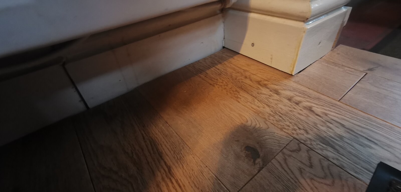

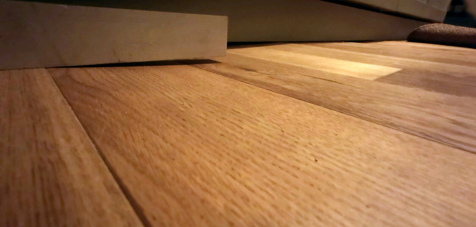

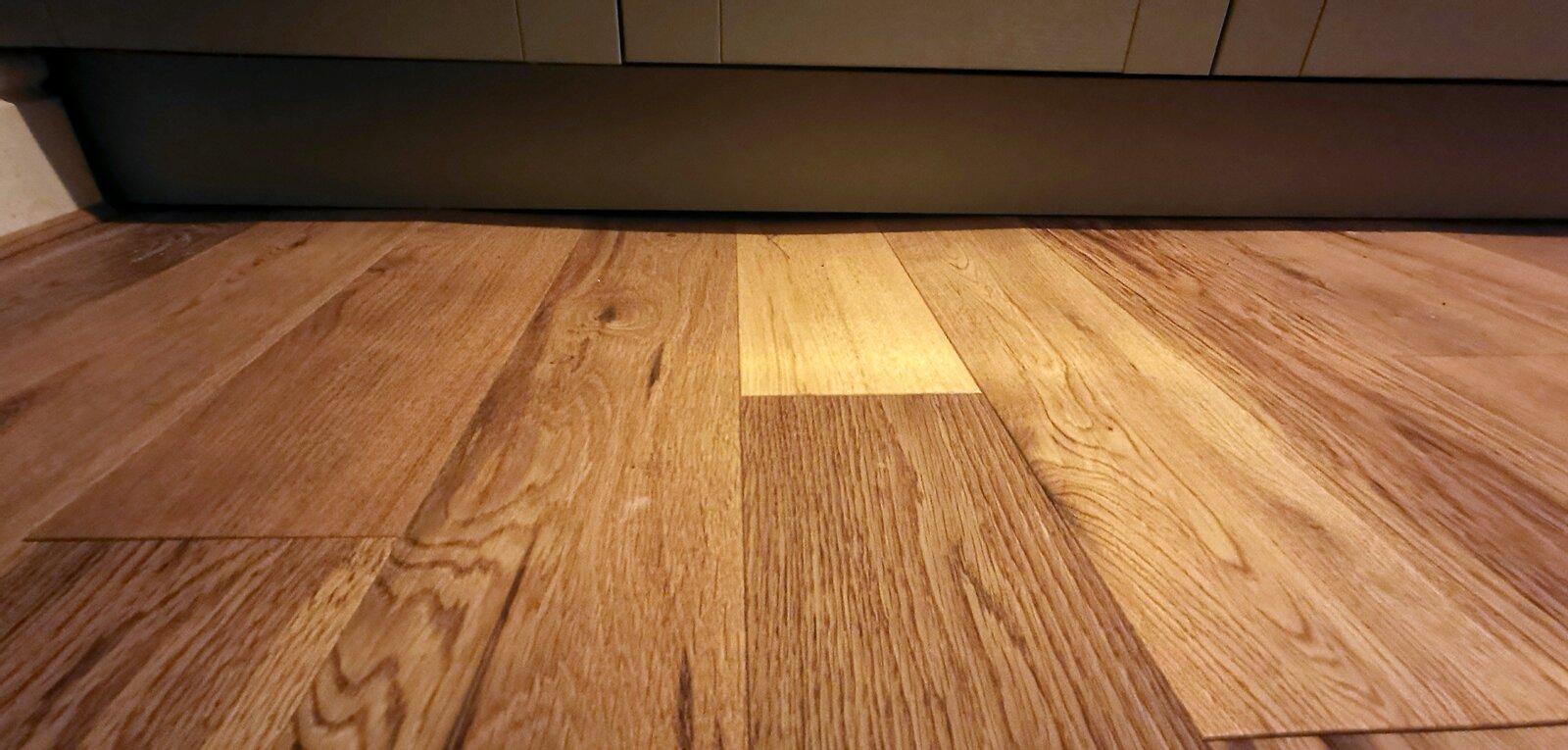

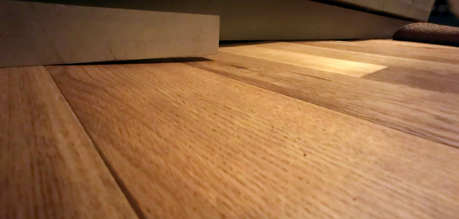

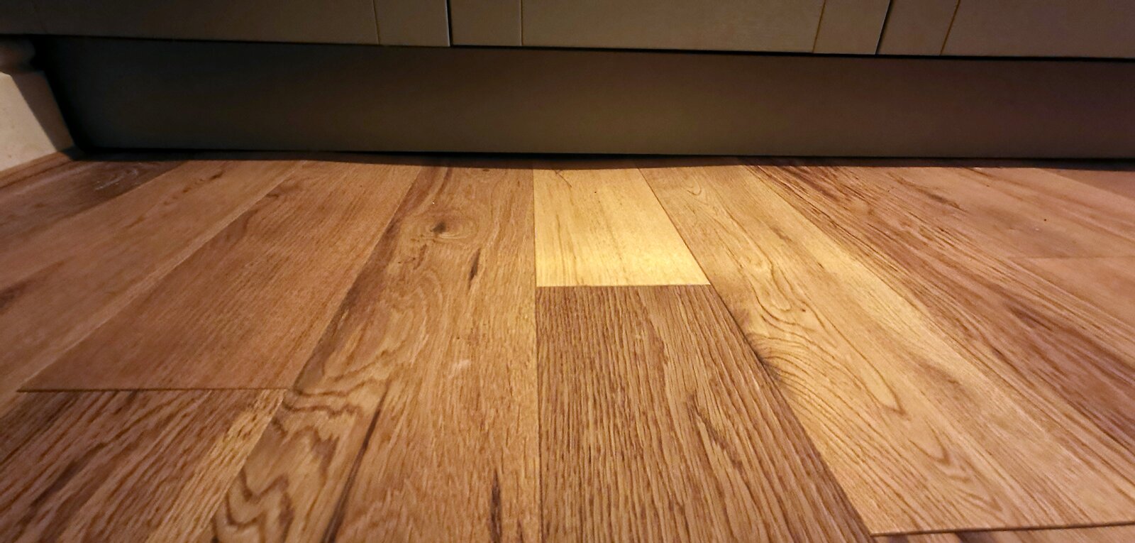

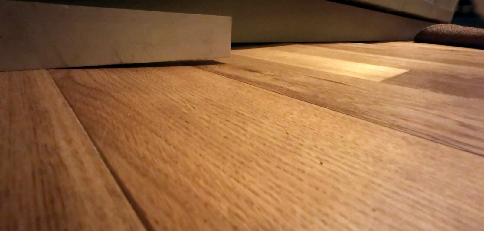

Well, I'm gutted because we only has this 100% hardwood Woodpecker floor laid in the kitchen (stated on the box for kitchens and living rooms) by our fitter in early Summer and already it has warped twice!. There is always a little movement here and there but this end got so bad a few weeks after the job was finished the fitter came back and adjusted the ends to give more space and re aligned. It was like a springboard. As you can see by the kickboard and the piece of wood I have laid across it has started again. There is absolutely no water getting anywhere on it (there was a little initially before the first warping from the sink drainer which was identified and stopped)
I am hoping it will settle again as I think the humidity outside and time of year + cooking could be affecting it but why only this area ? The floor is concrete with the old lino on it left underneath (for extra cushioning and insulation) with new under floor matting before the wood was laid. It's just so depressing to have it start to go like this so soon, especially as we paid decent money to have it laid.
Best I can do is get the dehumidifier in there.

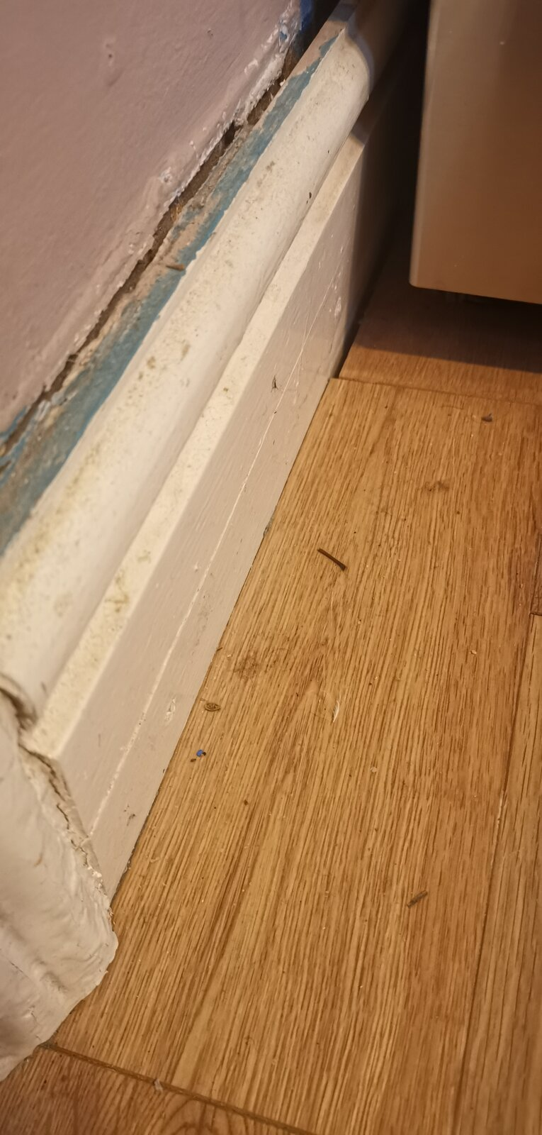

Do you know if there is an expansion gap at the wall? If you're not sure, perhaps pull up a section of the beading next to the wall.
If there is no gap, this could explain why its warping.

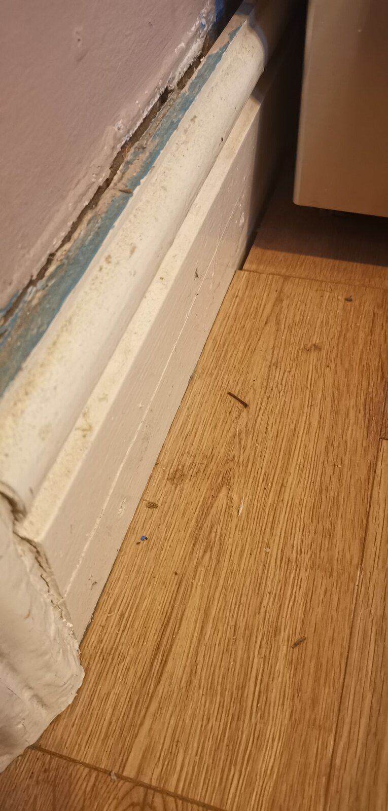

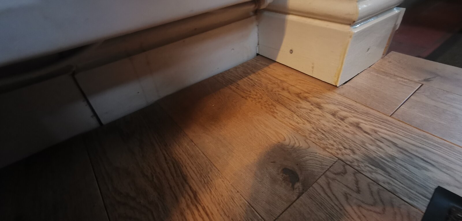

It's solid wood. I did the beading but don't remember much of a gap. Besides, he came back and adjusted last time and it evened out agan flat. Just can't understand why it it happening again. It can't endlessly keep expanding. At the other end it has caused the skirting board to ping away at the top but the floor hasn't warped. I can live with it if it fluctuates but it is annoying.

Looking at your images, I think it's still too tight to the skirting. Wood moves more across the plank than it will lengthwise.
You should have a suitable expansion gap on all walls (8mm at a guess), especially the walls across the width of the planks. Wood being a natural product will contract and expand through the year.

Take all the scotia off and plinths off. Check that you have a 10mm gap everywhere. No wood can be touching any legs or skirting.

Yes this. It appears to be very badly fitted with not enough expansion room in some areas and also there are points with no gap at all by the look of it. Full oak may not of been the best choice for the room either as it expands more than engineered oak for which the backing stabilises the oak

I would take off all of your skirting board and the last plank and refit the last plank to be under the skirting board after its refitted, also if there is plaster to the floor behind the skirt then take that bottom inch off to allow room for the floor, you then dont have to worry about the floor being too short for the skirt to cover it as it will be well under.
It looks to me, as if the skirting etc., is undercut, to let it slide under. It still needs space to expand under, before it hits a solid surface. Lack of adequate space, means it has to expand by lifting mid-span, as you seem to be experiencing.

Kitchen humidity will be constantly changing along with the expansion, contraction of the timber.

It looks to me like the top part in the picture here has a gap but the bottom part near the architrave does not. But the gap at the op is not enough anyway.
Then this picture it looks like it gos under on the short corner but then touches on the end and looks like it is up against the skirt on the left with the water marks. Unless this is what it was like and now there is a gap, or it only looks like its touching but is in fact going under the skirt. But looking at the undisturbed layers of paint on the skirt they do not look like they have been taken off to put the floor under them.
