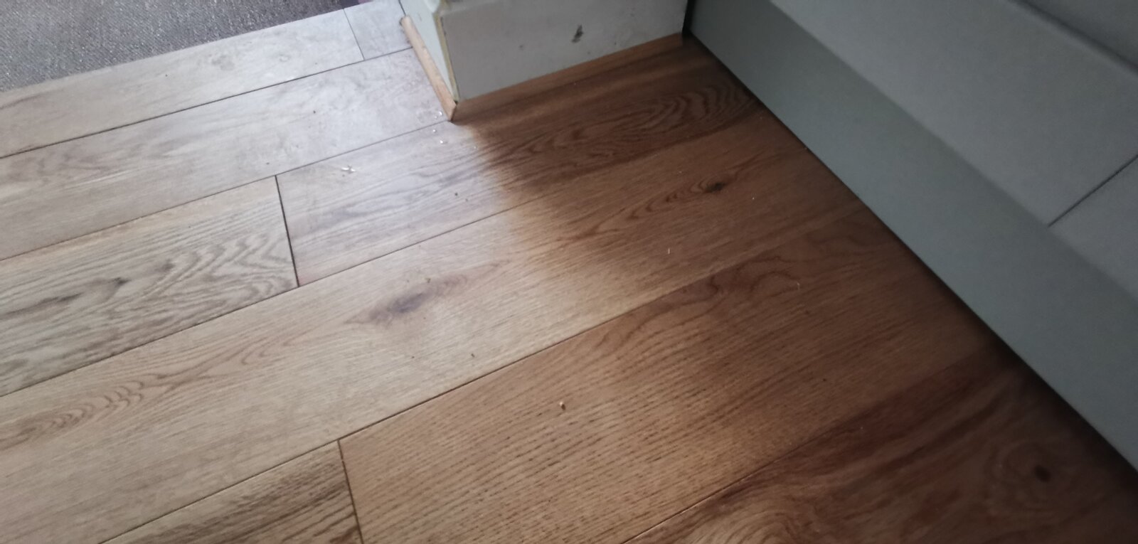

Does the floor go all the way to the wall under the cupboards. As it could be touching the end wall under the cupboards.
The intense scrutiny is because we think its has not been fitted correctly leading to "cupping" as it expands. It looks like it has but does this floor have a coating - did the chap do it or was it like that out the box (factory lacquered )

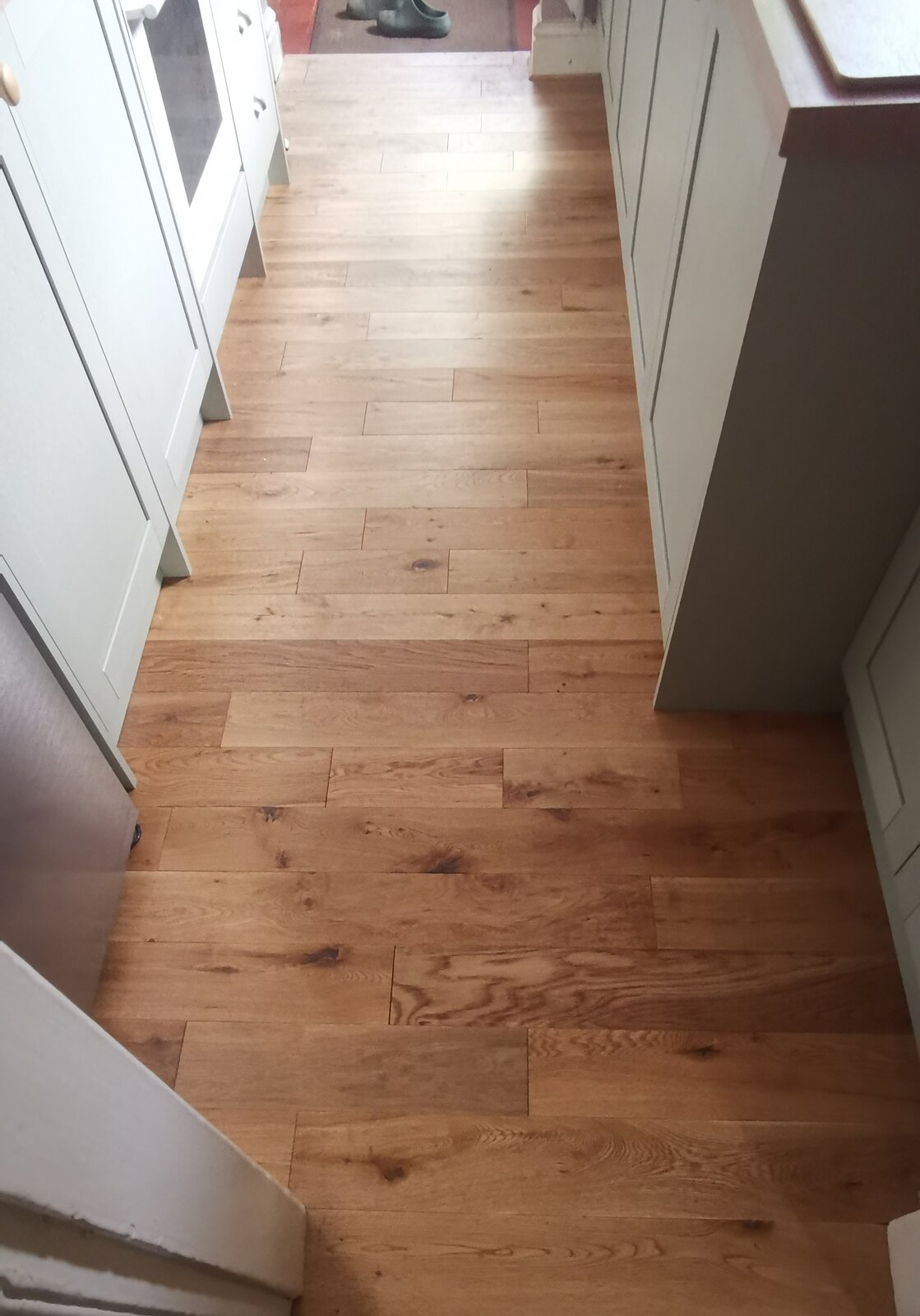

Another thing about the picture here is that he has put down a lot of the short planks right in the main walkway, It could just be my OCD but I dont think this is best practice either as that leads o lots of joins in the heavy traffic area. 1/4 way up from the bottom of the picture I can see 3 short pieces all in a row.
Laid in wrong direction , wood expands across the plank , the more planks the more the expansion .You have a round 30 plank widths against less than 10 if laid in the other direction . NO expansion joint at threshold .You can’t lay on top of vinyl as it allows enough movement to break any joints .

@crazydaze what are your thoughts on my issue with using too many short pieces in busy areas, am I being OTT.
It's not ideal but if that's what you have to work with then that's what you have, perennial issue with multi length boards.

Here are the details as we still have a full box and a half left. Again, he over ordered, not myself.
No one is 'piling on' all I see here is people trying to help you, but to be able to help you, we need some pretty comprehensive questions answered so we know what's going on with the installation.
Firstly, Woodpecker Solid Wood floors are not suitable for floating installations, if you float a solid Wood Floor you will forever have issues with movement unfortunately, this will either present itself with expansion/lifting as you are experiencing at the moment, or the opposite issue, gapping, where the boards will open up. Gapping can happen anyway and is part of a solid floor installation with seasons etc and natural movement of the floor but this can excessively open gaps in boards if the floor is not installed correctly.
With a Solid Oak floor like yours, the floor needs to be securely fixed to the subfloor, this gives the floor strength and allows the floor move as one in a regulated manner. If you float the floor, there's nothing stopping the floor from moving all over the place which is what you are experiencing.
the difference with an engineered floor is that the top 'solid' layer above the tongue and groove is supported and counter balanced in it's movement and stabilised by multi layers of engineered ply or similar laid in criss-cross layers to give the board dimensional strength to make a more stable floor that can then be floated and nowadays fixed to the subfloor if desired.
A floor that is fixed directly to the subfloor or prepared subfloor wether it be Solid or Engineered will feel more solid underfoot than a Floated floor.
You will see on Woodpeckers Website exactly how your floor should have been laid and it's completely out of spec.
You can't expect a short cut to fix your issues you are experiencing.
We can try and help you, although I am not so sure this floor will ever lay flat, perhaps if you can answer some questions we can get it flat for now.
Can you confirm, were the Kitchen units fitted on top of the Wood Flooring or were they n place before the flooring was fitted?
Do you have access or the means to ensure the flooring can move freely with at least a 10mm gap around all edges of the floor?
The original subfloor has a Vinyl on it, do you know if this was fully stuck to the subfloor?
Can you confirm how old this part of the house is?
Can you confirm if you know there is a Damp Course in this part of the House?

We were asked which direction we wanted and astheaticalky we preferred it that way. It doesn't make any difference. At both ends the wood is free to expand (doorway and end that steps down into tiled utility area) It only goes under the units so far and not against walls.

But its not free to expand, the photos show it touching the skirt. But its good news that it only gos under the units a short way so it will not then be touching the wall at the back of the units. You just need to take off the skirt at both ends and make sure there is a gap to the wall.

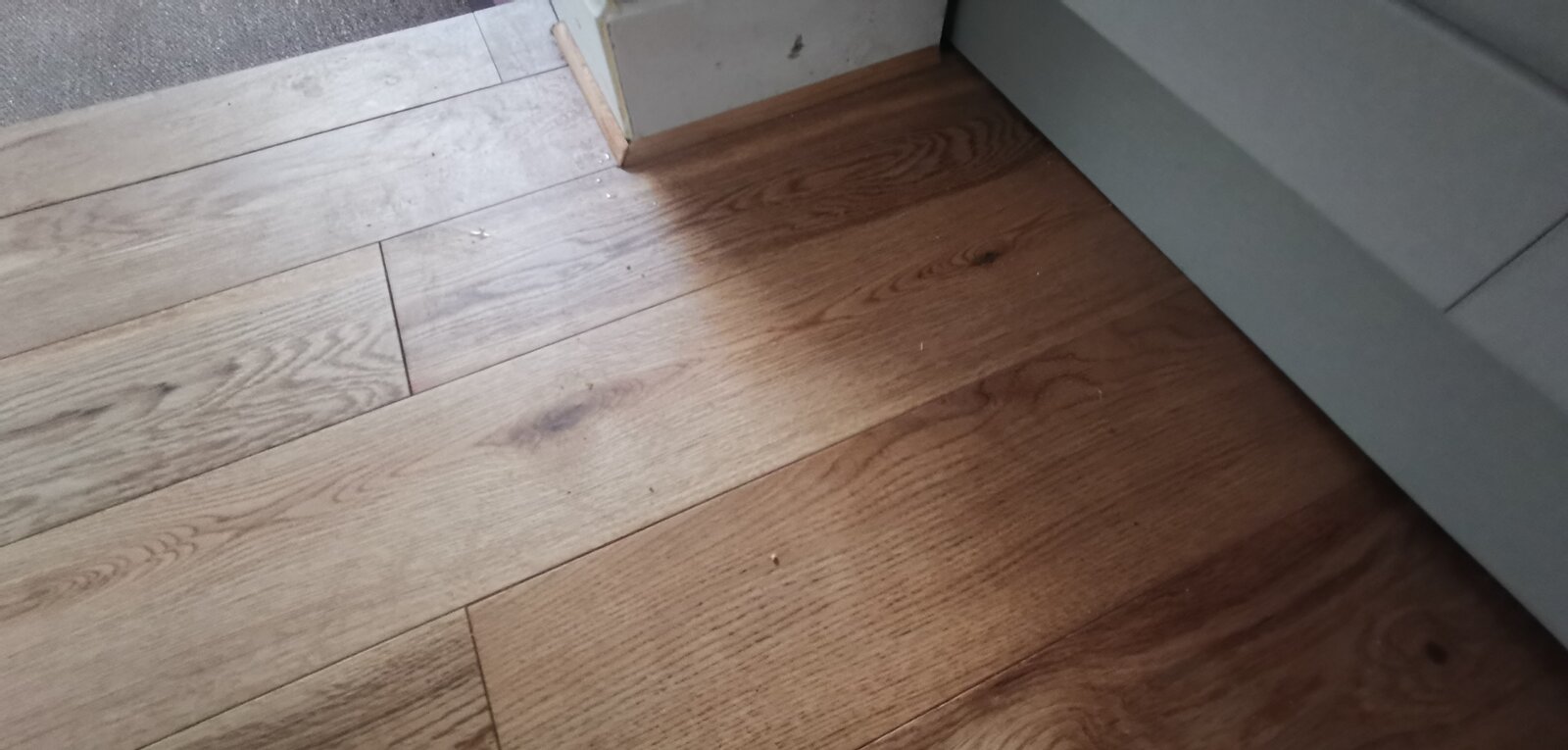

Well this area has got far worse these last couple of weeks after fluctuating within acceptable parameters all winter. It got this bad last year a few weeks after it was laid. The guy who fitted it came back to finish the tiling and noticed it himself. He rectified it by cutting away some of the wood (I think under the skirting) and re-laying as flat as a pancake so why oh why oh why has it gone back just as bad ? wood doesn't gain mass in a few months.
