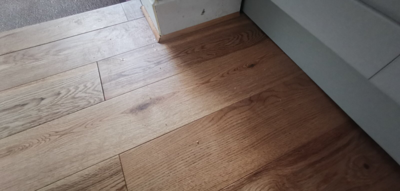

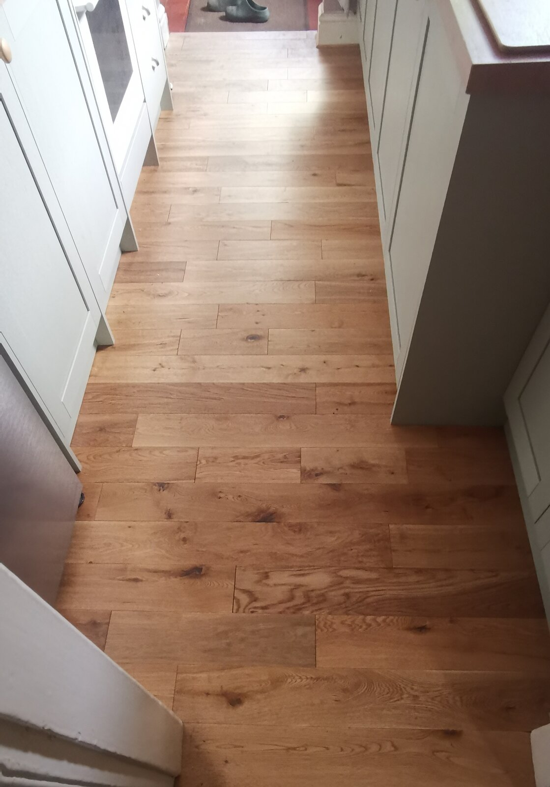

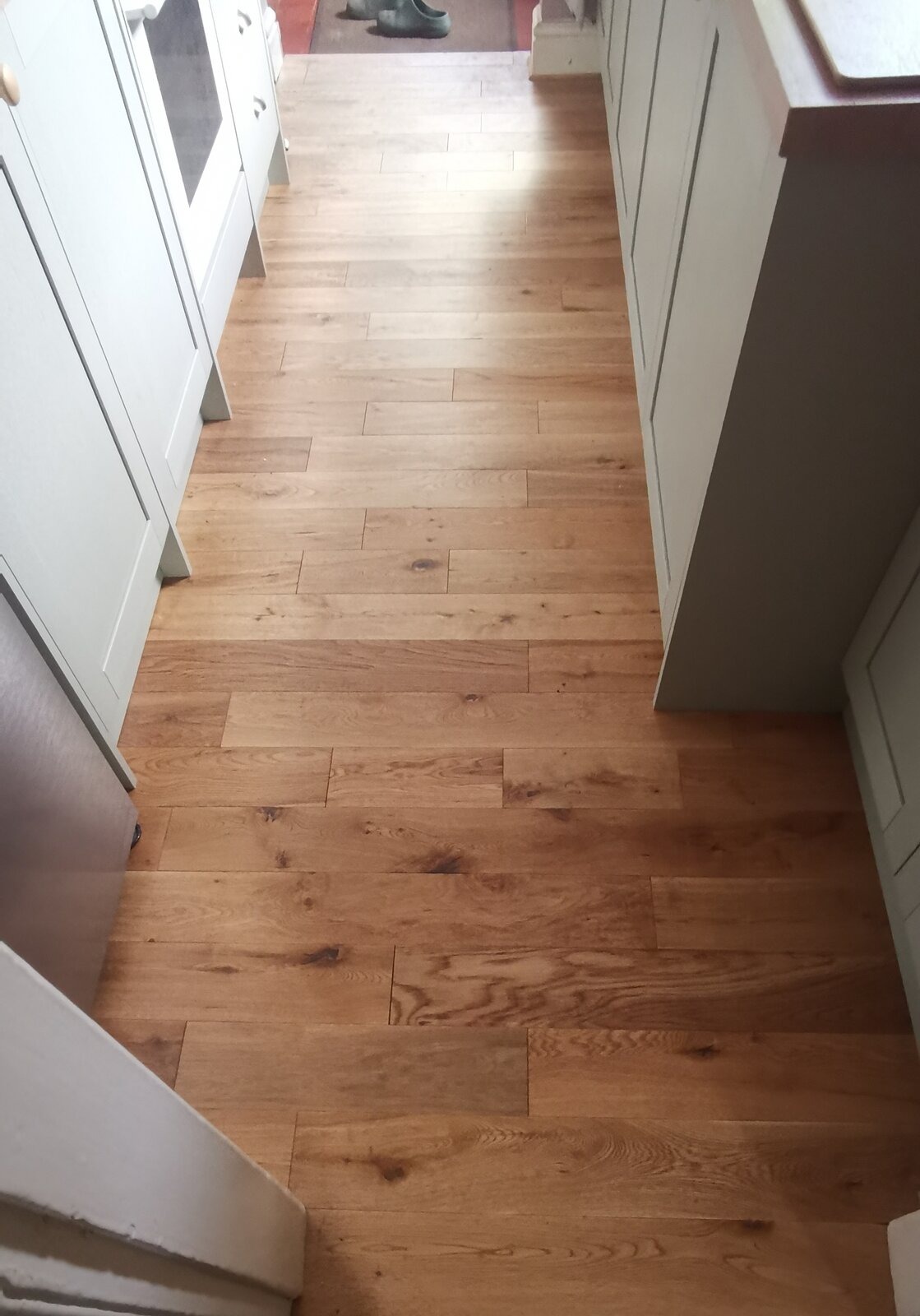

Well I'm not on the floor looking sideways at it so you don't see it. The box states it's for Kitchens and living rooms. The fitter did just what you said and took some off the end plank when it warped last time. So on that basis why is it going again ? The other end of the kitchen is fine which is fitted pretty much the same.
How long is the kitchen and what area is the floor. I remember reading that you have to add an expansion area somewhere as well as at the edges in long runs.
I'll just adjust the skirting as advised but I have already put beading on some of it that I haven't photographed. And yes I glued it to the skirting and not the floor.
When you say adjust - do you mean take off the skirting and put back so its then sitting on top of the floor.
I am wondering if the whole lot is moving as one sheet - what was the underlay used. If its in the kitchen does it go under the units kick-board's.
It looks to me like the top part in the picture here has a gap but the bottom part near the architrave does not. But the gap at the op is not enough anyway.
It looked to me, originally, as if the skirting had been undercut, to allow it to slide under, but that lastest, photo obviously shows the flooring, butted tight up to the face of the skirting and even levering the skirting away from the wall, and causing the floor to bubble up in the middle. That floor laying is an absolute mess, it needs to be properly laid, with either the skirtings and architraves under-cut, or the essential expansion gap hidden by that horrible quadrant material, they sell for the purpose.
I thought of a possible under cut but its way too neat for that.

The best thing to do is remove the skirting chop a 1 inch section off the bottom of the plaster and cut the floor to end where the plaster was, so that when the skirt is put back on top the floor is well covered by the skirting board and it has the space occupied by the plaster to move and expand.
Take off the skirting and you can leave the architrave and undercut it. One advantage of doing it this way is that all those years of paint overlap and filler on top of the skits and on the wall will be hidden by moving the skirting up- after first scraping it flat. It will all then look amazing.

That type of flooring, must have gaps around it, so it can freely expand, otherwise it bulges upwards, as you have found. That either means undercutting skirtings, or removing them and refitting on top, so the gap is hidden, or leaving a gap between the flooring, and skirting, with quadrant to hide the expansion gap. Your floor installer, appears to have done neither, leaving me wondering if he might have never fitted such flooring before?

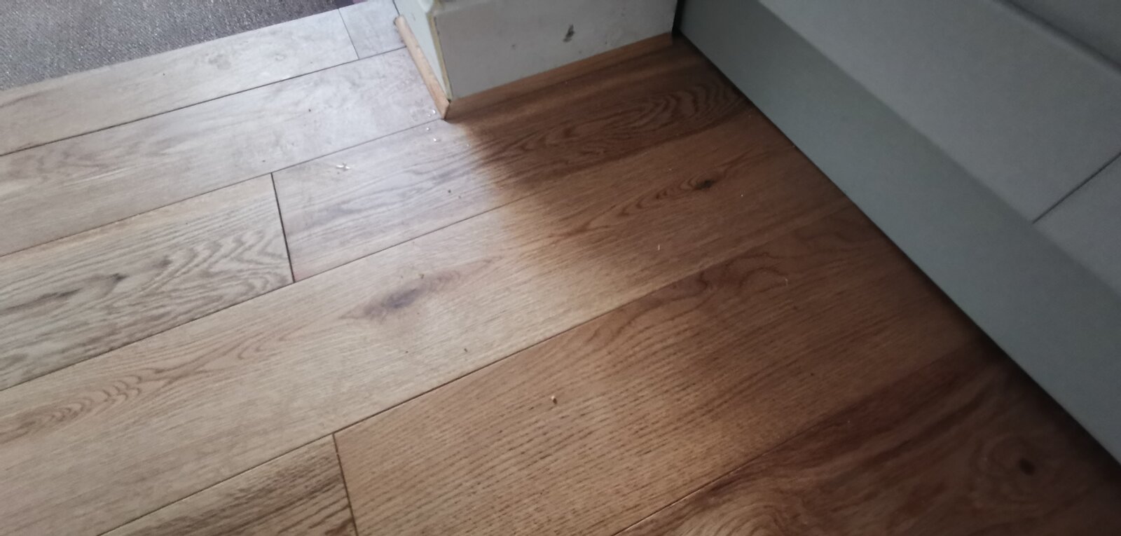

This is the area we are talking about. The area it is springing is this corner. I am going to paint the skirting hence the filler showing. I also put the beading on so can't see beyond but looking to the right I can see it goes under the skirting so no idea why lifting.

If there is no gap, between the edge and the wall, under the skirting, then it will spring. If there is no gap, between the edge, and the skirting, under the beading, then it will spring. I seem to remember, the installation instructions, suggest a minimum expansion gap of 10mm, all the way round the edges, to avoid such issues.
