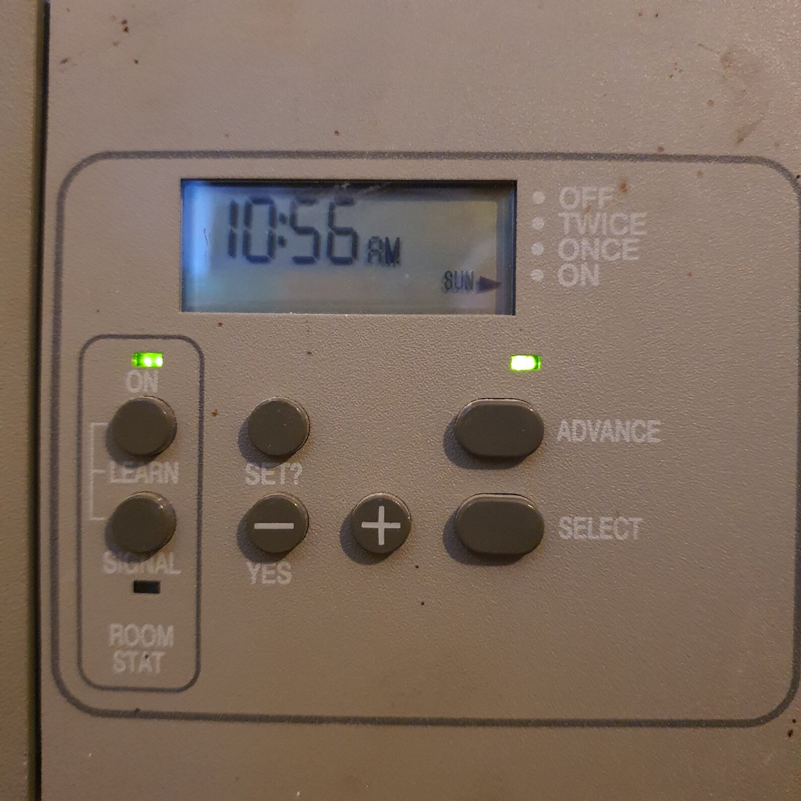

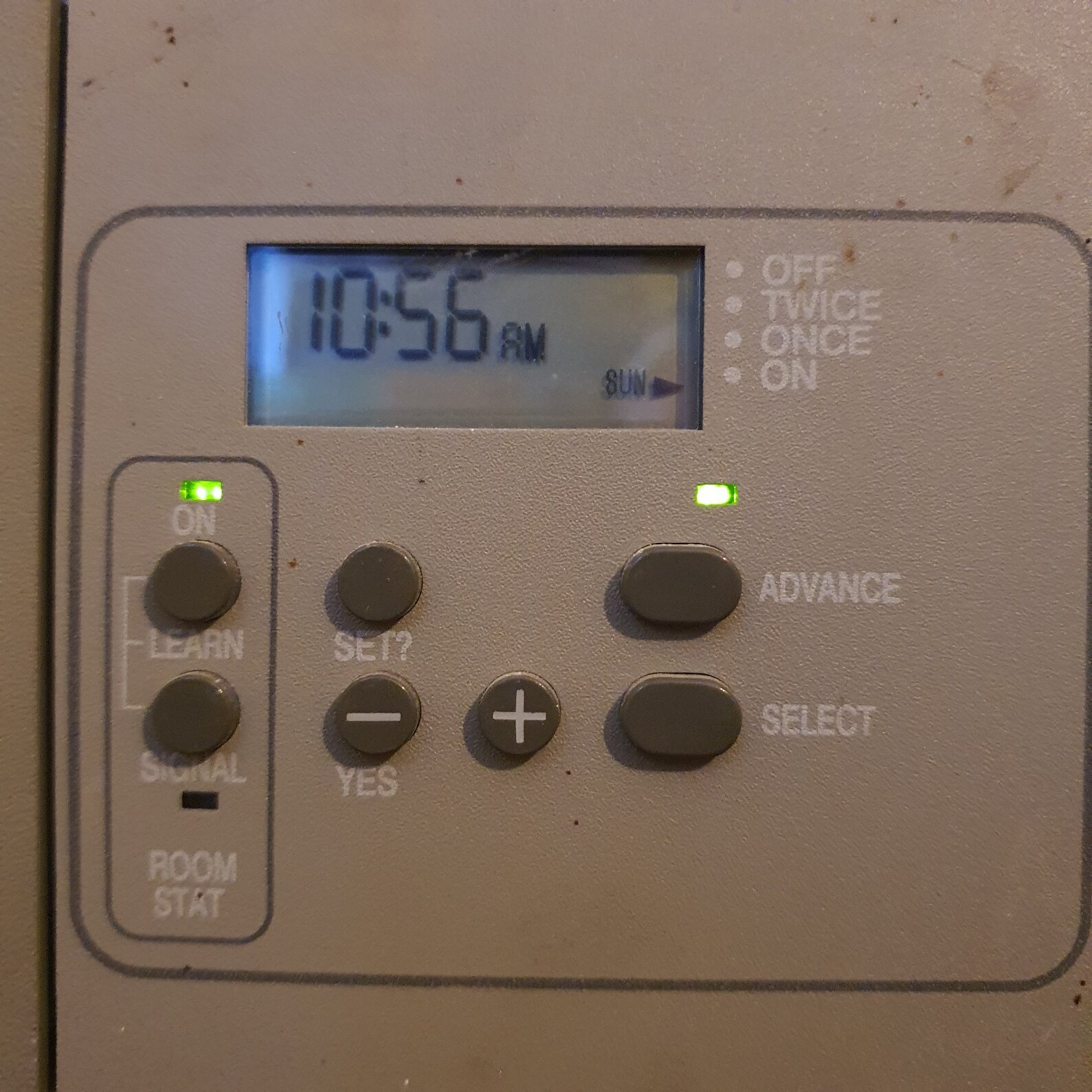

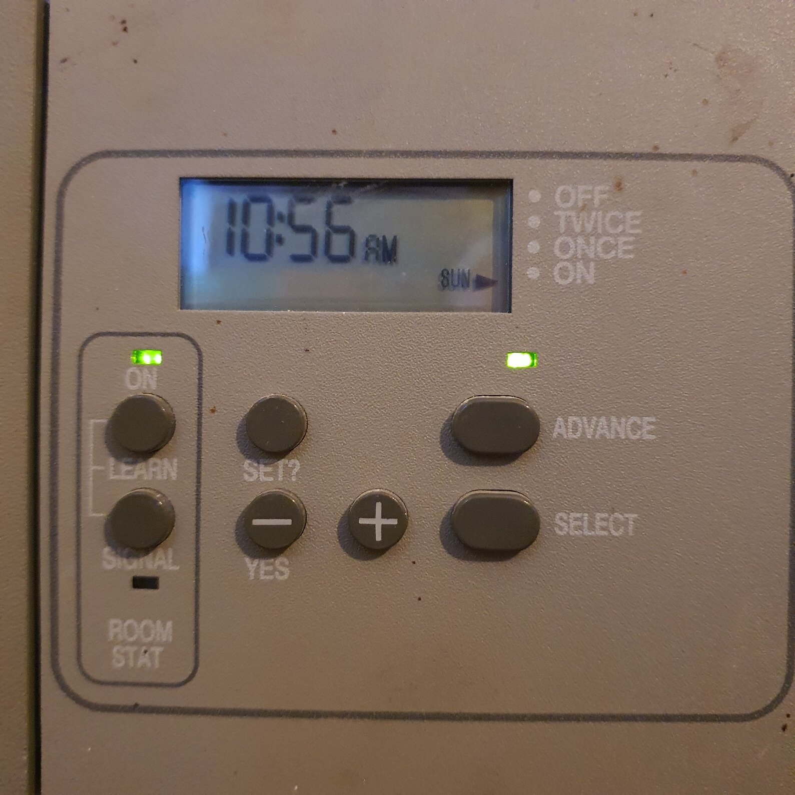

Can you press the 'On' button on the "Room Stat' panel, and see if that provides an override? - I'm guessing the LED above the button should illuminate.
Think its in the on position, if I set the nest to a lower temp than ambient, turn the existing stat up, the heating still comes on.
Well that has worked to a certain extent, fuse isn't blowing. But, heating is not coming on. Should I be setting the installed room stat on the boiler to something specific? Or disconect it? It's in the "on" mode at the moment
And I connected 2 from nest "common" to ST8 LS and 3 from nest "call for heat" to St8 LR

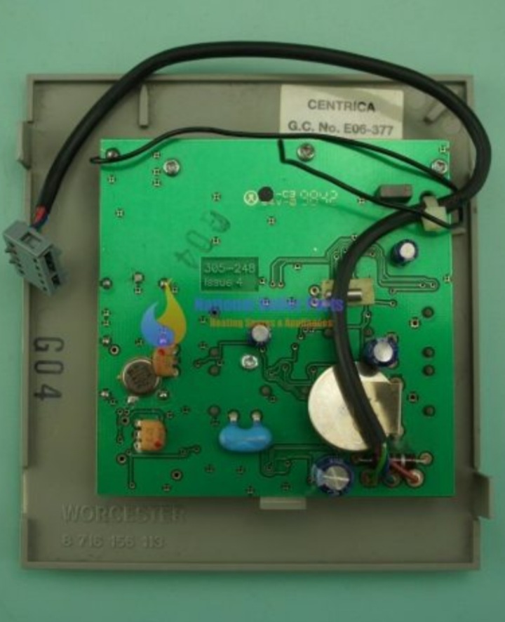

Because the controller has a built-in wireless receiver, it is difficult to know how to bypass it.
I haven't been able to find any technical information on the receiver itself, other than it being a:
WORCESTER 87161561170 PROGRAMMABLE RECEIVER
There appear to be only three wires on the back, so it's possible that it is simply +V, gnd and switch, but I wouldn't like to bet on that without testing.
@Badger1966 , can you remove the module, and pull out the plug and see if the Nest then has control?
So, with the old stat and nest under ambient temp, as soon as I disconnect the module, the heating fires up. I tried with the old stat set above ambient temp and nest below, pulled module and it fired up the heating.
As for testing, black and red 23.7v (black is negative) nothing on green. Heating on, black and green 4.5v
