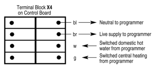

OK on the back of the controller (sorry cant remember off hand the terminal numbers) there will be a wiring diagram with HW COM and HW NO, take the wire from HW NO and put it in the HW COM , and the HW will work , you wont have any control by the programmer though, but it is just exactly the same as switching the HW to constantly on , you do this with the power isolated obviously
Your controller has flying leads, into a connector block on the PCB. This is the easiest place to put your link. I think you will find the terminals marked on the connector block, but if not, the diagram is on the Worcester web site.
Whilst this is a basic Honeywell controller, it is modified by Worcester for connections and consequently costs about £150. If you want to replace with something cheaper, then you can wall mount anything and connect to the PCB.

I can see where the programmer wires go into the main PCB board as follows, but not sure exactly what I need to change to do a temp fix, happy for any input.
Thanks all - just an update - temp fixed now applied and working, thanks for everyone's input, much appreciated.
