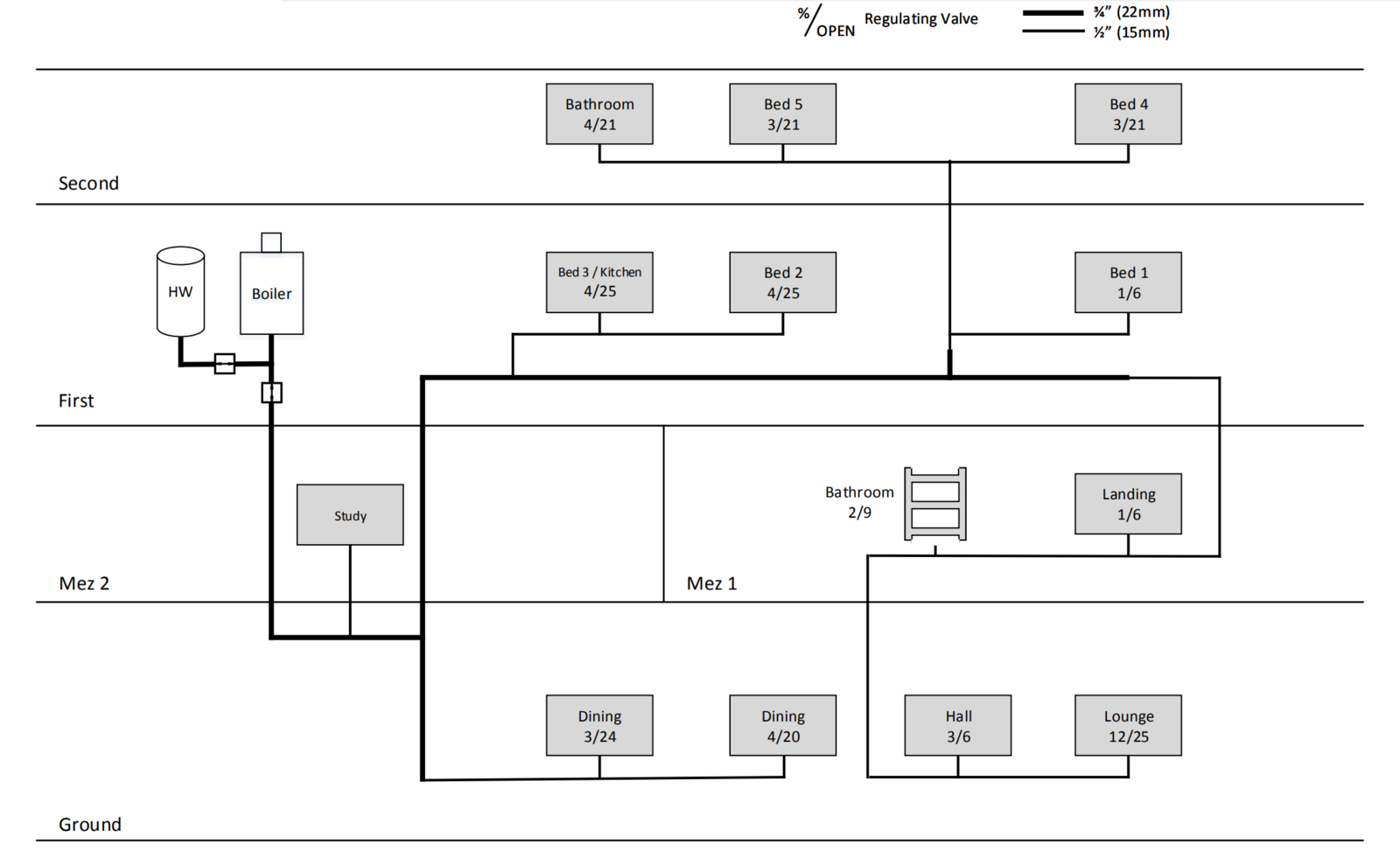

Actually - my description above isn't quite right. Here's a plan of the system. There are 2 additional ground floor radiators added since I drew this. The pipework from the boiler to ground is 3 years old, from first to second is probably 2.5 years old. The rest is very old, but only the bed2 and bed3 radiators are 'original' (~20 years)
So.. having gotten home this evening, I've opened up the magnetic filter and it didn't look too bad. Very little build up, but I've given it a clean and put it all back together again. Fired up the boiler and the pump is definitely struggling.
I've tried just running the HW circuit, just the CH and Both together, and under any configuration, the pump is struggling. I'm hoping that means it's unlikely to be a blockage and if it is, it must be somewhere between the boiler and 2 port valves? Anything else I should try before getting a new pump fitted? If not, are there any particular makes of pump I should choose / avoid? I think I have a CPL pump at the moment..
I would advise you to contact the company that installed / regularly serviced ,to diagnose your problem. There is no substitute for a site visit ,to fully diagnose what is going on. The info you have provided points to a problem with the pump ,but if it is only 3 years old ,its failure is not impossible, but premature to say the least .

Do you have TRVs? If so, there should be at least one rad without a TRV, preferably the one where the room stat is located (if you have a room stat). Or possibly a permanent boiler bypass pipe. If you have TRVs on all your rads, and they're set low, now the weather has warmed up they could be all closing down, hence the pump struggling and the short time to raise temperature. You could try opening one or two of them fully as a check.
3 Radiators do not have TRVs and there is a boiler bypass pipe. Also - the pump appears to struggle even with just the HW circuit open, so I'm hoping it's either the pump or a blockage ahead of the 2x 2port valves..
