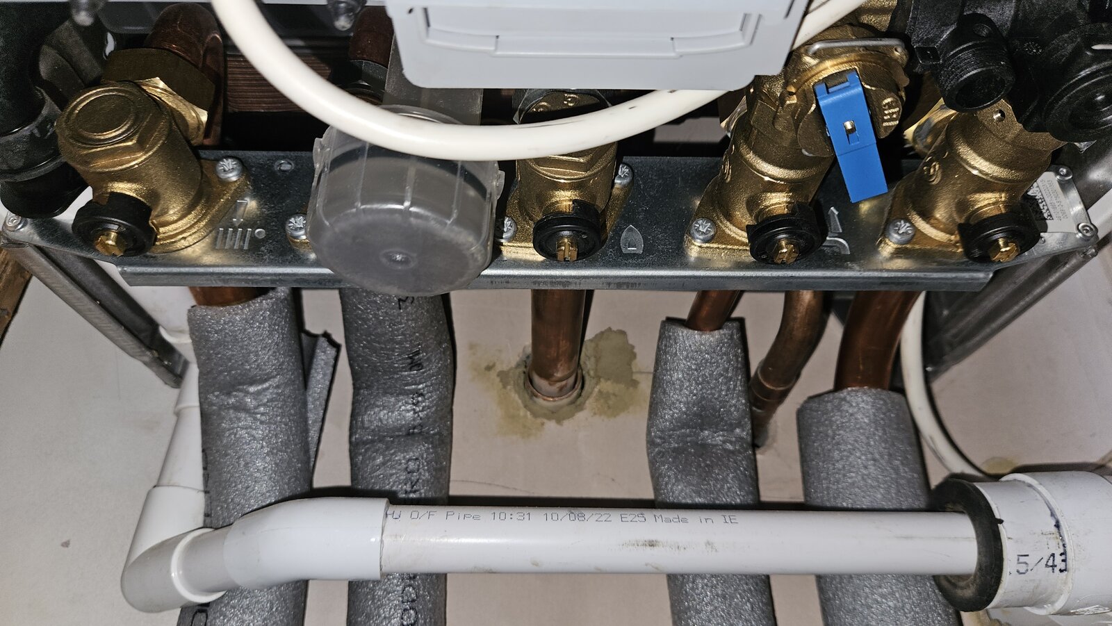

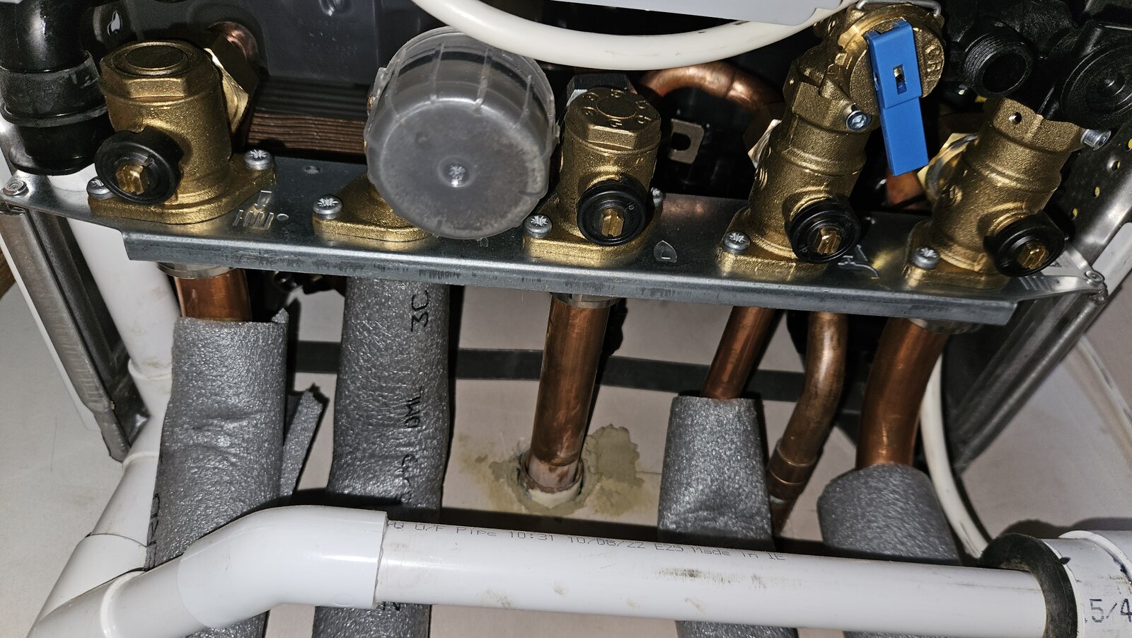

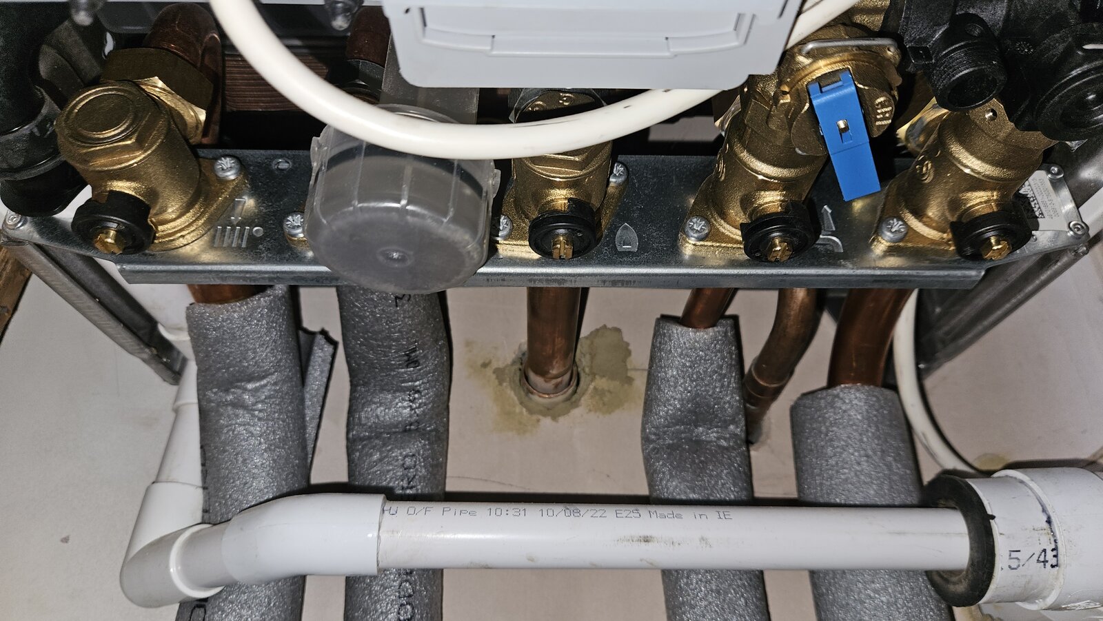

Hi Terry. Sorry for the delay, but I've been away. I'm about to try your suggestion of isolating the boiler to find which side has the leak.

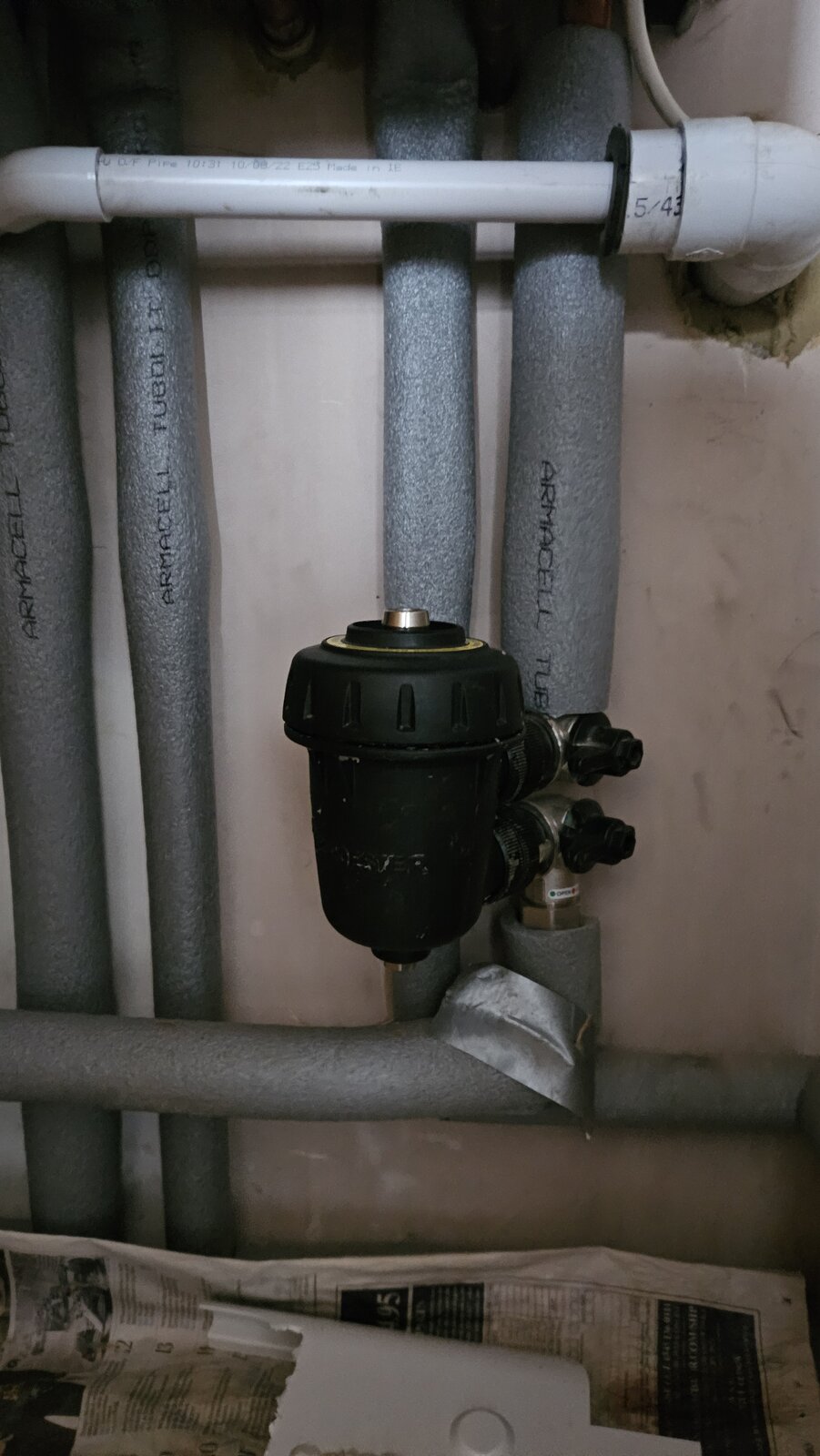

I can't find flow & return isolation valves. There's nothing that looks like valves coming from the boiler. I can see valves that isolate the Worcester magnetic filter, but it's only on one side of the flow.
Will isolating the boiler via these valves do the same job?
Thanks, Paul
No it won't. Show us pics of where the pipework enters the boiler.

The isolation valves are the black circular bits and the brass centre has a slot for a flat bladed screwdriver to close them ( also has two flat surfaces for a small spanner to be used to turn them)
