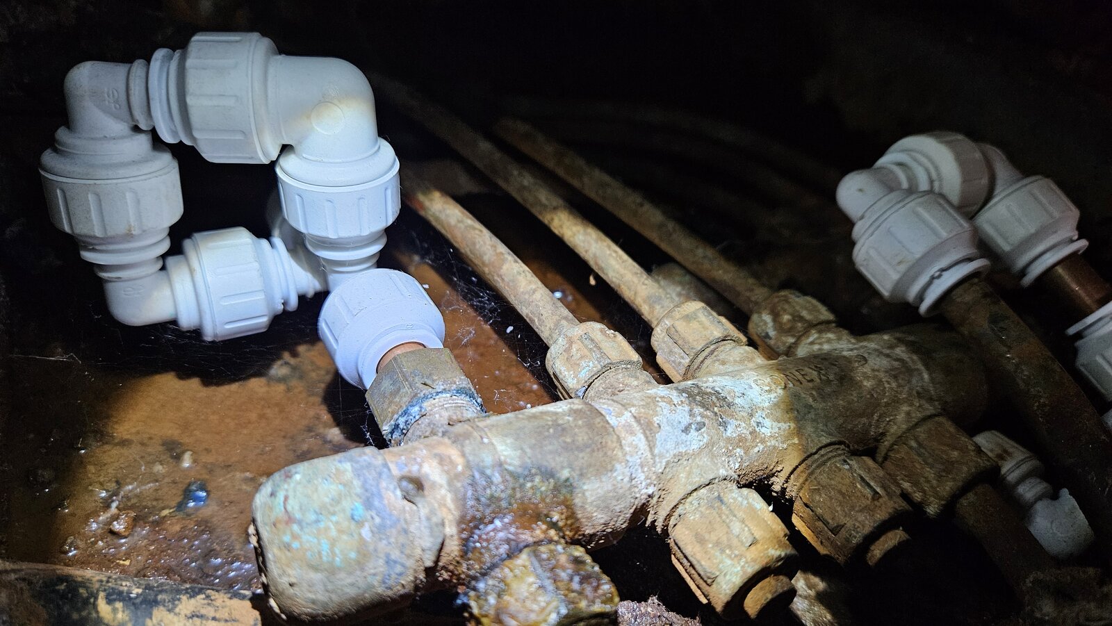

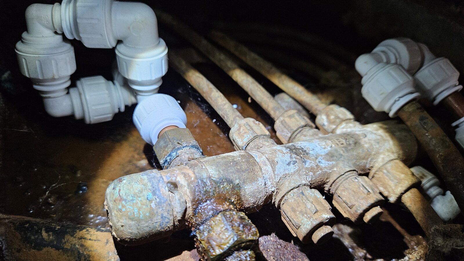

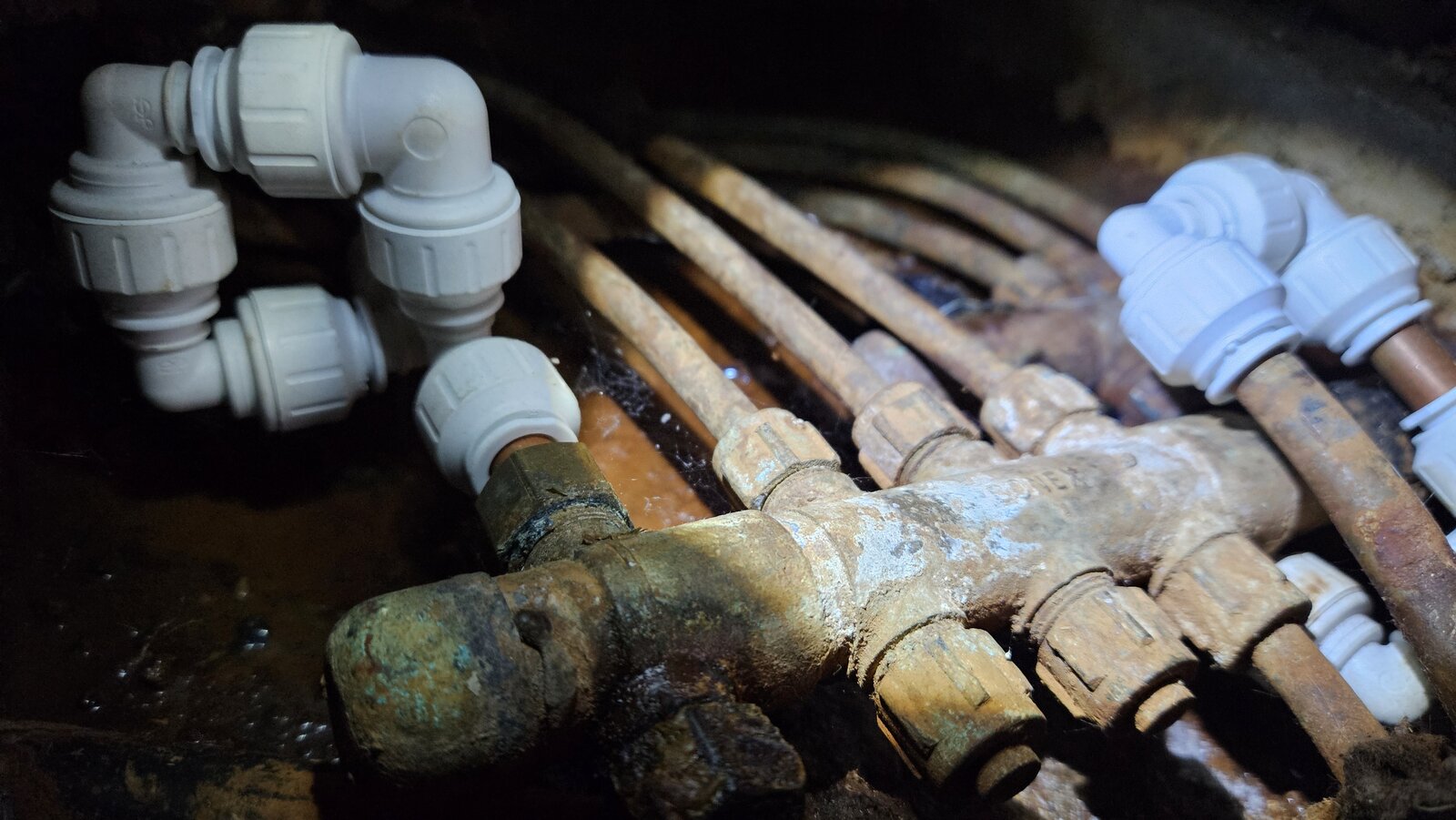

Hi Terry. 3 photos attached. 2 manifolds with 6 microbore pipes attached to each. I have 7 downstairs radiators so perhaps 1 nearby radiator is connected elsewhere.
The plan is to get a reliable plumber to fit new manifolds and new connections to the pipes running to the radiators. The 2 leaking connections are merely weeping water and although the bottom of the sump is damp, there's virtually no water in it. If it takes maybe 30 seconds to repressurise my system, I imagine I'm losing quite a few litres of water each time. Therefore I'm not sure new manifolds will solve my problem but they need fixing anyway.

There is obviously some water loss in that area ,some of the pipework looks in poor condition ,particularly the larger copper. The pics all look like the same manifold ,is the other manifold in the same area,and same condition ?
Obviously you need to sort out all visible leaks ,and see what difference that makes.

Yep. It’s all 40 years old. The other manifold is underneath and the phone camera only autofocusses on the top one. I agree about fixing the visible leaks and see if I still lose pressure.
